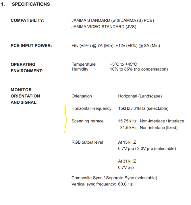

I've got this specs section of the manual:

Normally, I would look at that board and giant JAMMA on the bottom edge and order the JAMMA accessories. But the Okatu description confuses that by saying that JVS is an evolution of JAMMA, and the manual description just says they are both "compatible".

I think this SC II manual was just written by someone that wanted to give vague, double answers to everything. It would seem the answer is "both":
Okay good. By "selectable" it probably means there's a physical jumper you need to move to connect the proper pins to switch which resolution you want. So keep that in mind, if you're running 31khz now over the VGA cable, and you want to connect a jamma game, you need to move that jumper to support the 15khz resolution that game will need.
