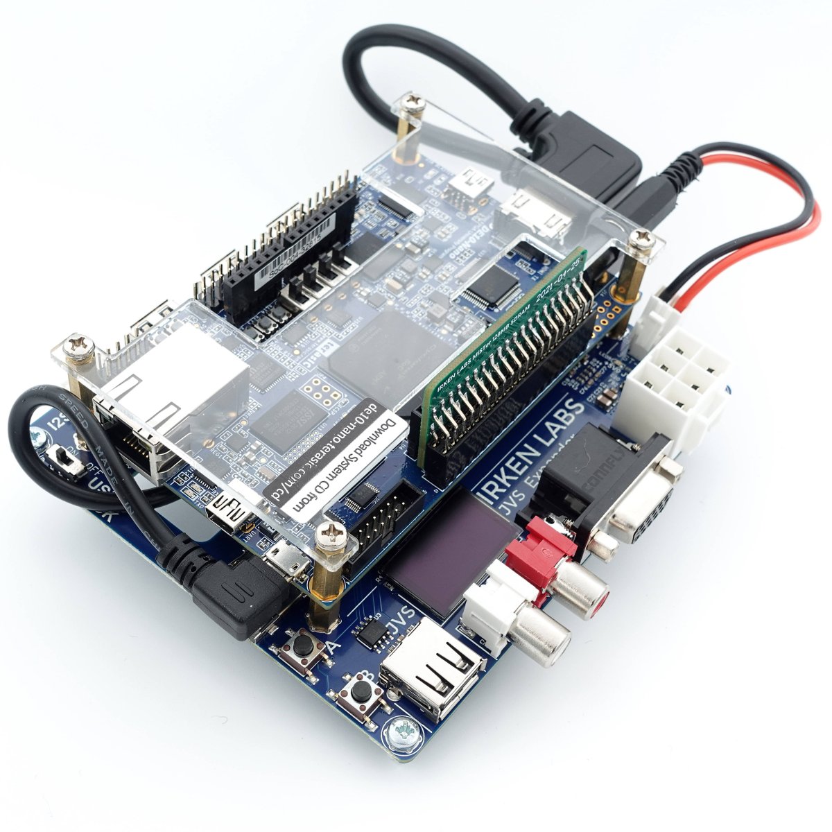

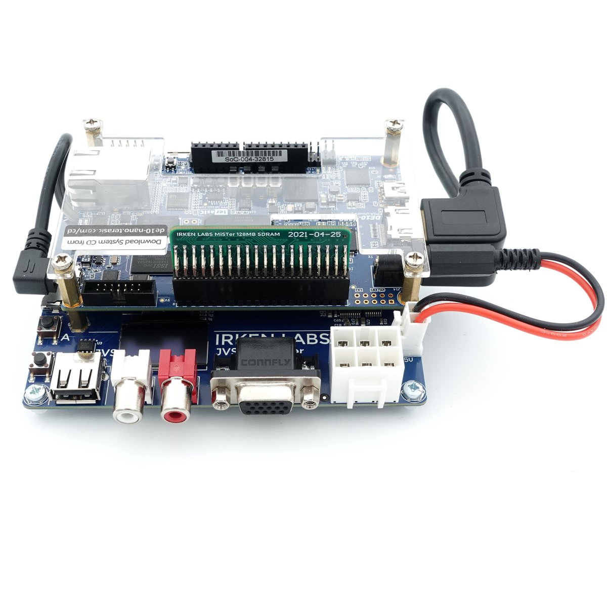

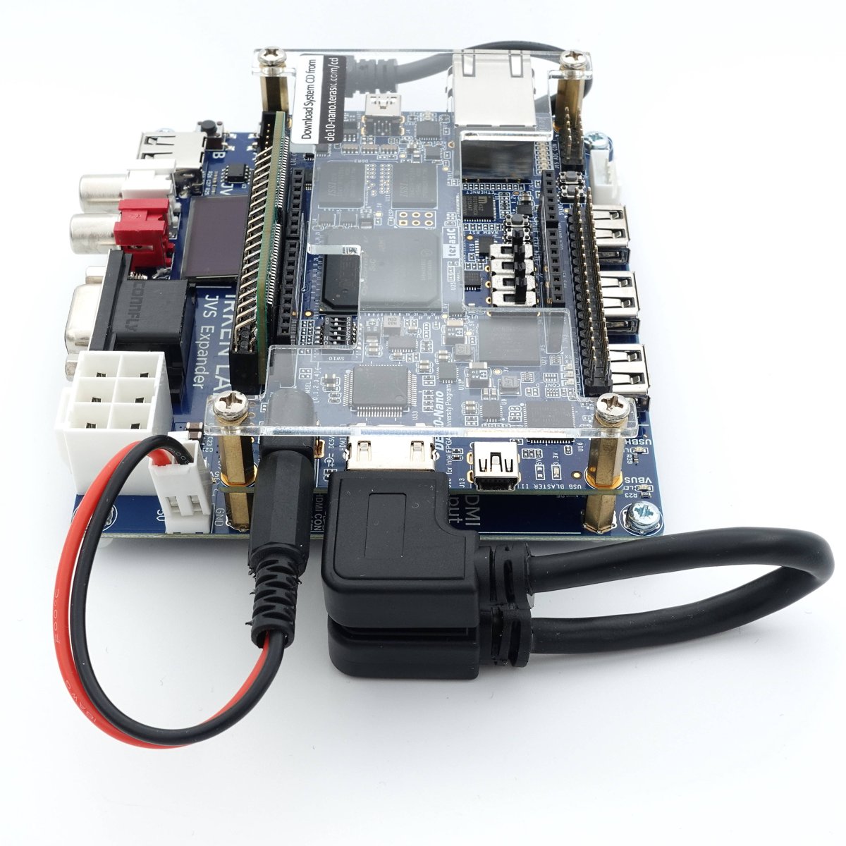

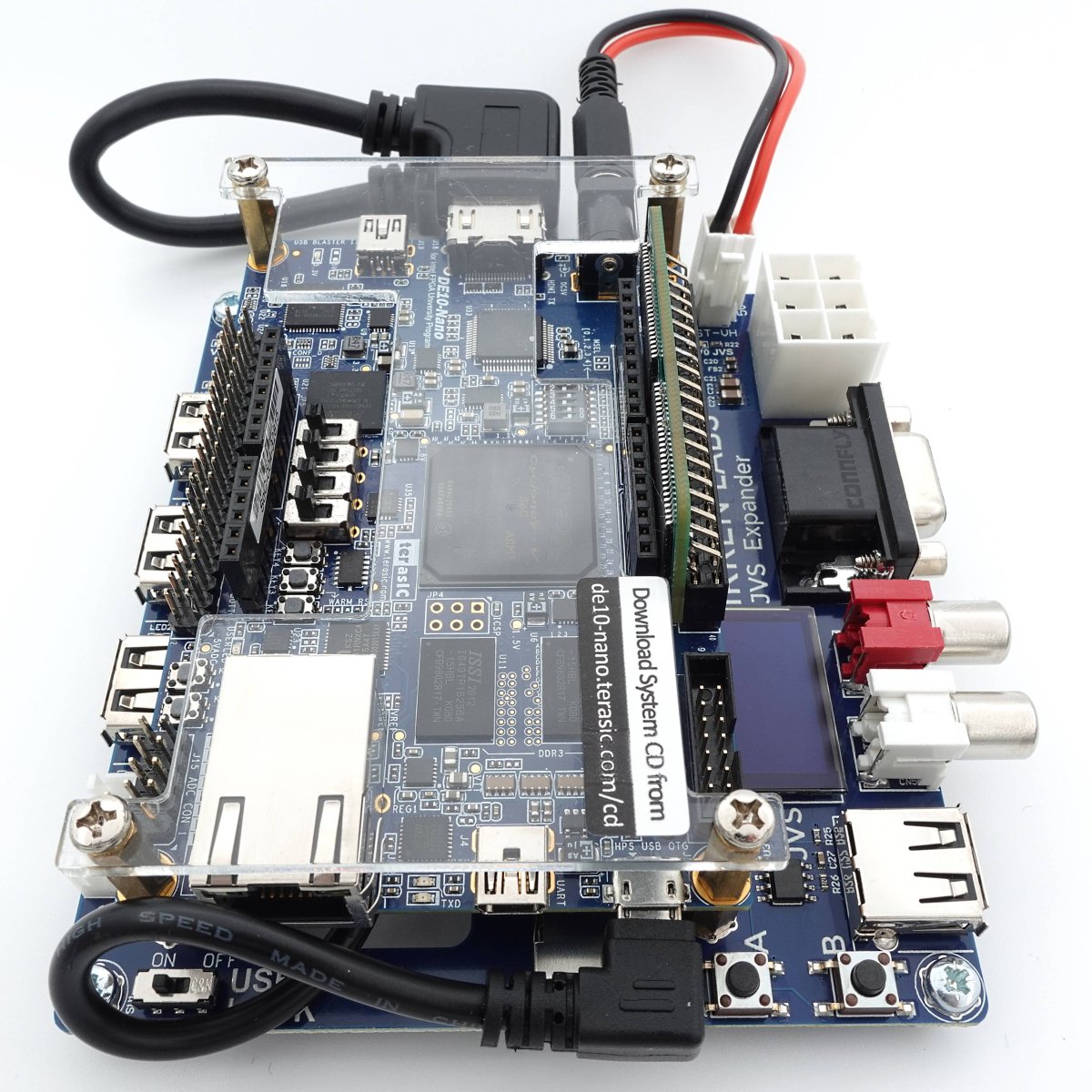

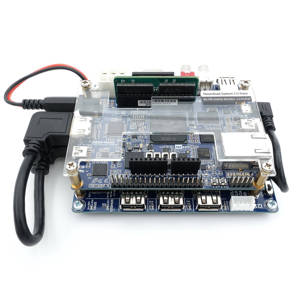

In the works, hope to have it ready this year. It's a lot like the JAMMA Expander, but JVS of course. Aim is to get mister in a JVS cab quickly and easily, in addition to the Expander, you would need the DE10-nano and an SDRAM module.
- Direct_video design - i.e. HDMI is looped back to the expander for audio & video
- configurable SyncGuard for VGA/CRT monitors
- 3 port USB hub, 480mbit
- JVS (doh :))

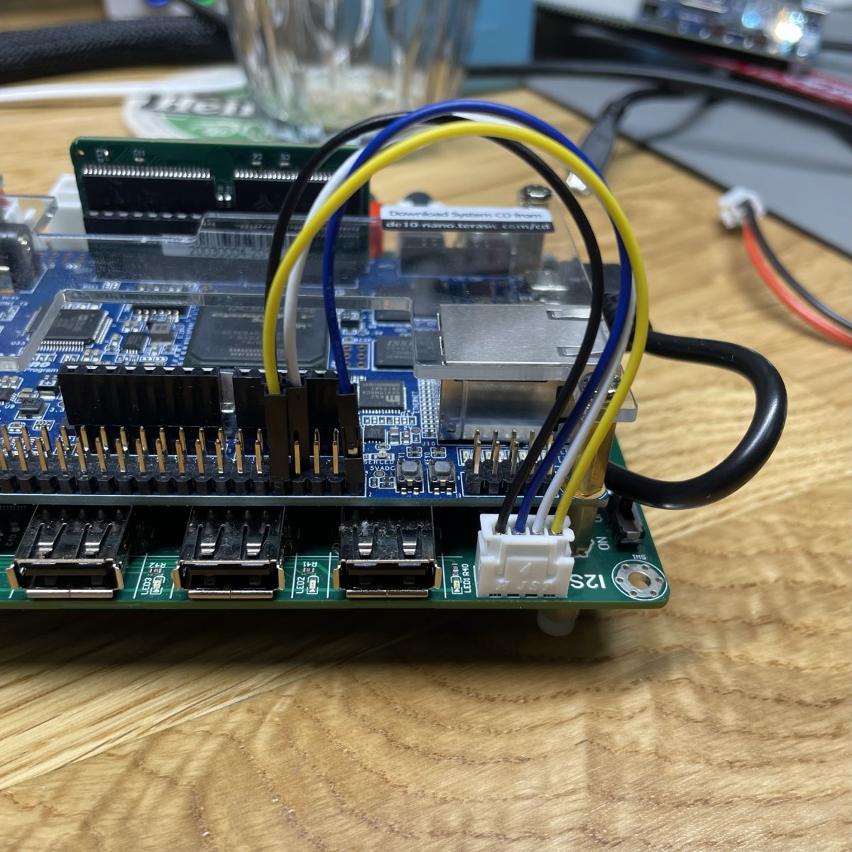

For vewlix cabs that doesn't use VGA, you can still use this as it has headers for i2s audio - i.e. you can source audio from the DE10 GPIO pins - I'll probably include a cable for that.

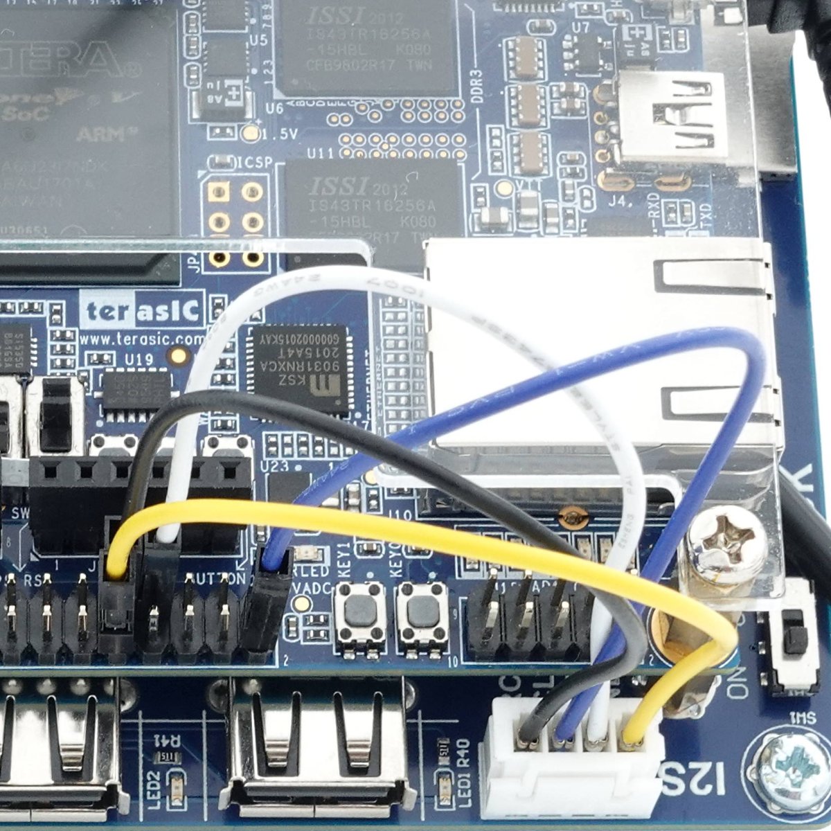

For vewlix, you have 2 options, in both cases audio comes from the RCA connectors on the Expander.
  • Use VGA from the expander, quick & convenient and goes up to at least 1080p.
  • HDMI, for perfectionists, straight out of the DE10
With the HDMI option, you need to extract audio somehow. I tried several types of HDMI audio extraction IC's and other schemes to provide digital video and analog audio, without success - so in the end I just opted for the simplest solution, which is to tap I2S audio from the DE10 gpio headers. There is no config, if the expander can't sense HDMI input, it sources audio from the header.
The harness in the image will be included with all JVS Expanders, but you only need it if you're going to use HDMI video directly from the DE10.

I actually tried to make this 'caseable', but it was tricky because of the OLED and JST-VL connector, so didn't bother. Most of the stuff on the PCB is covered by the DE10, and the edges are riddled with connectors and buttons/switches so not sure if there would be much utility.
