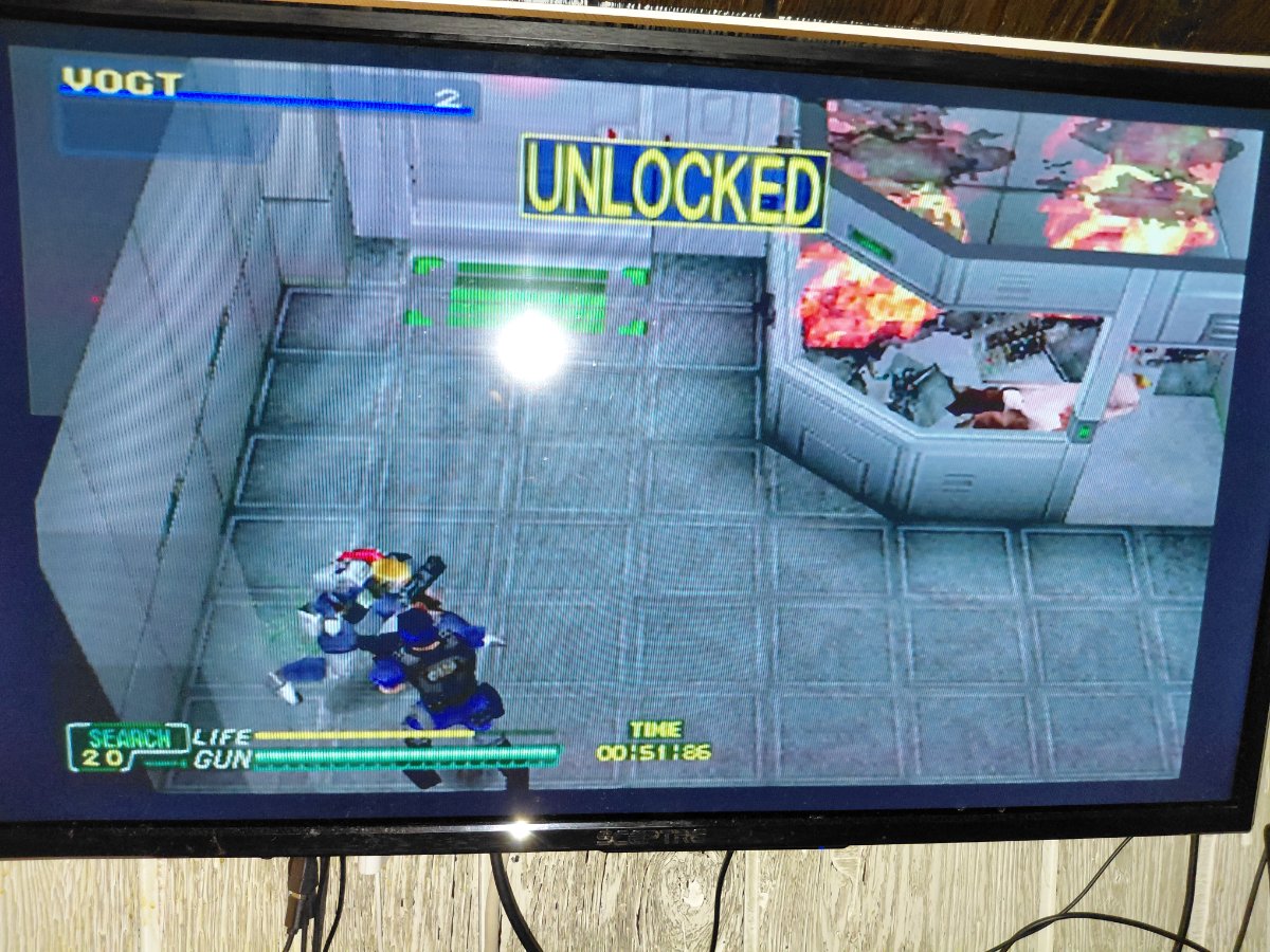

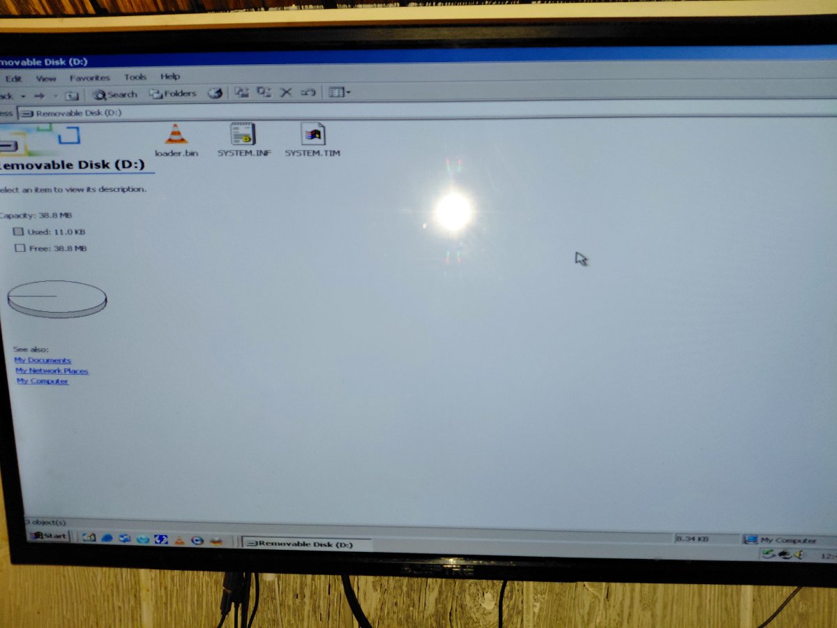

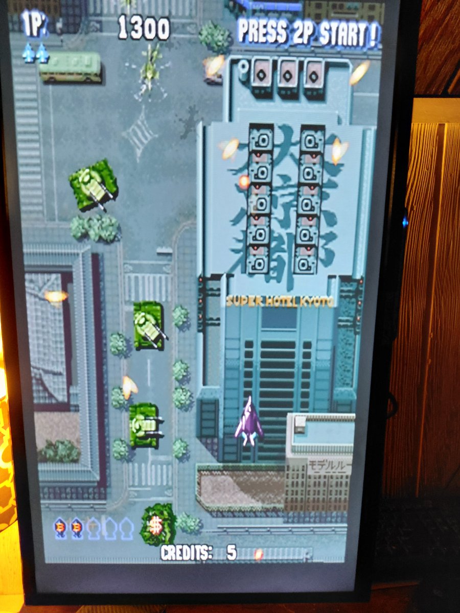

Works great. Some games aren't working for me. Specifically the conversions seem to have missing files when I copy them to the cf card. The 2011 bios flashed easily with jumper 1 and updated bios eeprom.

Conversions of games where the original PCB had Q-Sound will not have music and/or sound effects. I think Brave Blade is the only game affected so far. So don't drive yourself nuts troubleshooting if that's the game giving you the issue.
I ordered some Sandisk 256mb cards. Seems like a bad cf card to me.
Taking alot of trial and error for sure. Conversions working now with Sandisk cards.
