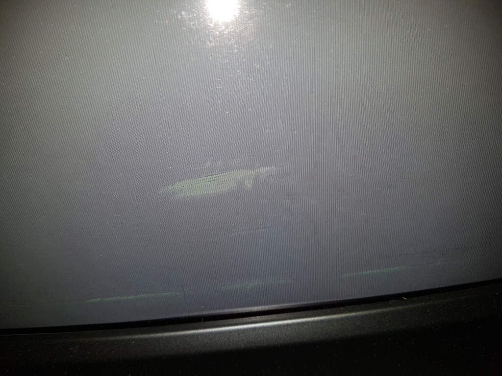

Can you buff scratches out?
When I used it, didn’t seem like novus 3 was hard enough to even do anything to glass since it is supposed to be used on plastics. Novus 1 shouldn’t have any abrasives in it, it seemed like rainx to me.
sounds like different opinions About the novus.
thanks for the comments.
there is one deeper Scratch as well perhaps i really should think About sanding it down and then polish…
lets see if i can find a way.

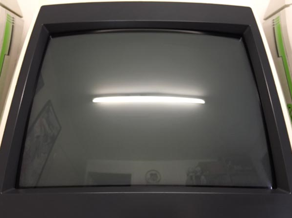

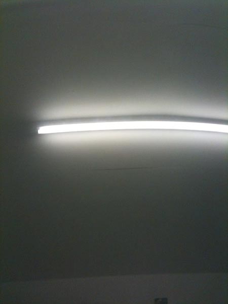

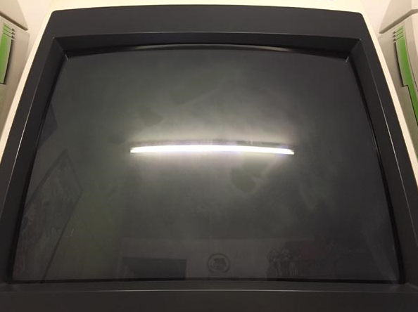

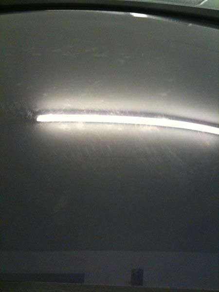

Here's a couple of example pics. I was (still am) happy with the results.
Before:
After:
Before:
After:

oh that looks really fine.
and yes these spots without coating are too annoying.
