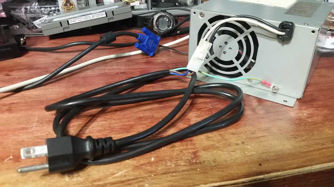

Yep, I just got my Sun power supply!
Anyone know what type of connector is used on the Sun power supply?
The connector to connect it to the wall.
what type of cab are you using?
I think Lemony(?) made me a Sun PSU -> Blast adapter so the Blast powers it once it's turned on.
he means the input side, not output from the psu
I have two of them. Both use different connectors for input. Depends on which cab his PSU came out of.
I'm talking about the power input into the Sun Power supply.
I want to make a cord that will plug right into the Sun and then into the wall, bypassing the cab.
Not the greatest pics, but it's this connector on the right.
