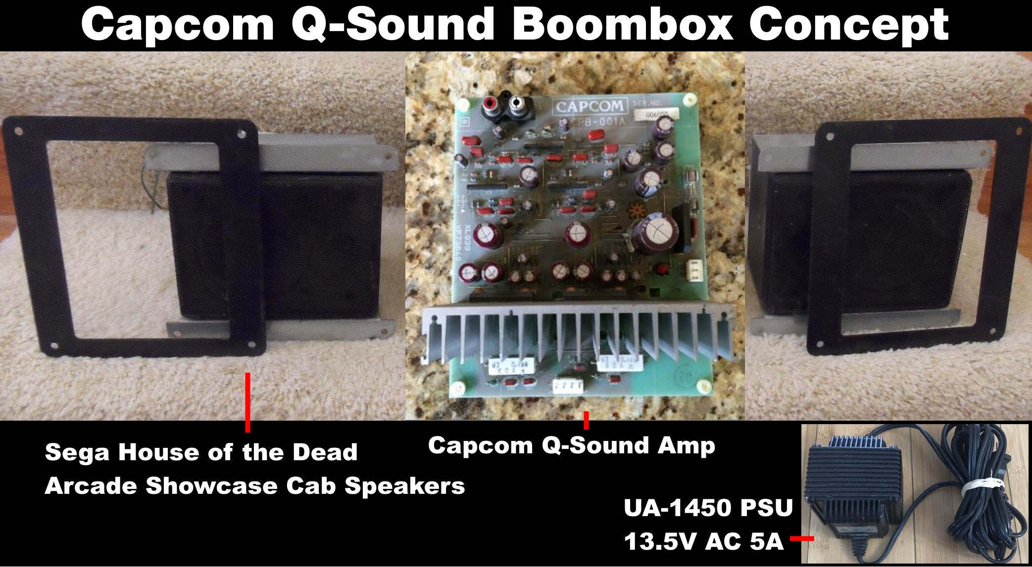

This UA-1450 PSU is an AC 13.5v that mean that you shoud get about 9v otherwise the capcom kitamuara one is 18vAC and supply a range from 12v to 13.9v at 2.5A minimum (this because the AC is not the same of DC). So your transformer/psu may should not work. I do not want create confusion but these amp need 12-13v simmetrical, 2.5amp minimum that's all.
Oh, is there some math I'm missing? I tried an 18V AC Amp and it put out 18V, which was too high. Wouldn't the UA-1450 (5A 13.5V) give about 13.5V with such a low draw?
But have you tested your 13.v ac psu? and is it working with the amp?
No, I've been away from the US for the last two years and have it boxed up and waiting.
I actually got my Q-sound to work. Now I'm not sure if it's working 100% cause I had a MVS-1FS board hooked up and sound works through speakers when connected to the mono out port, when I connected it to the stereo port no sound came out. I tested with a CPS2 board and sound came out with mono as well. I will test when I get home today on the stereo out from the CPS2. I found out what was wrong it was wiring :) followed original wiring from manual and all is well.
@hardyhell - Q sound is just an amp. If you just want stereo and something to power your speakers I would use a newer model amp instead of paying 140 Euros unless it's something you just want for nostalgia.
