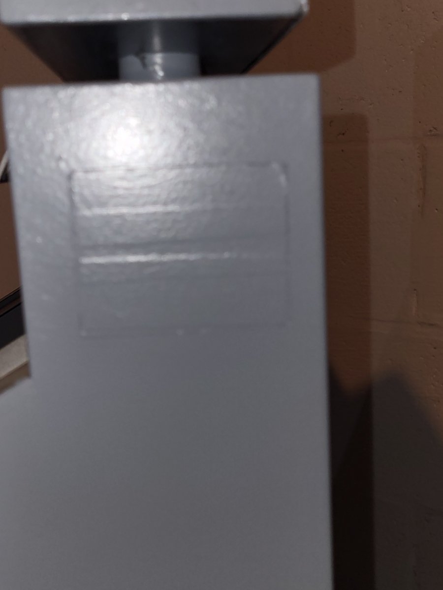

She's drop dead gorgeous!
That's not paint btw its powder coating.
A powder coater can sandblast it give you a nice new, cleanable, scratch proof layer.
You can request as many free powder coat samples as you would like from Prismaticpowders.com and send it to your powder coater

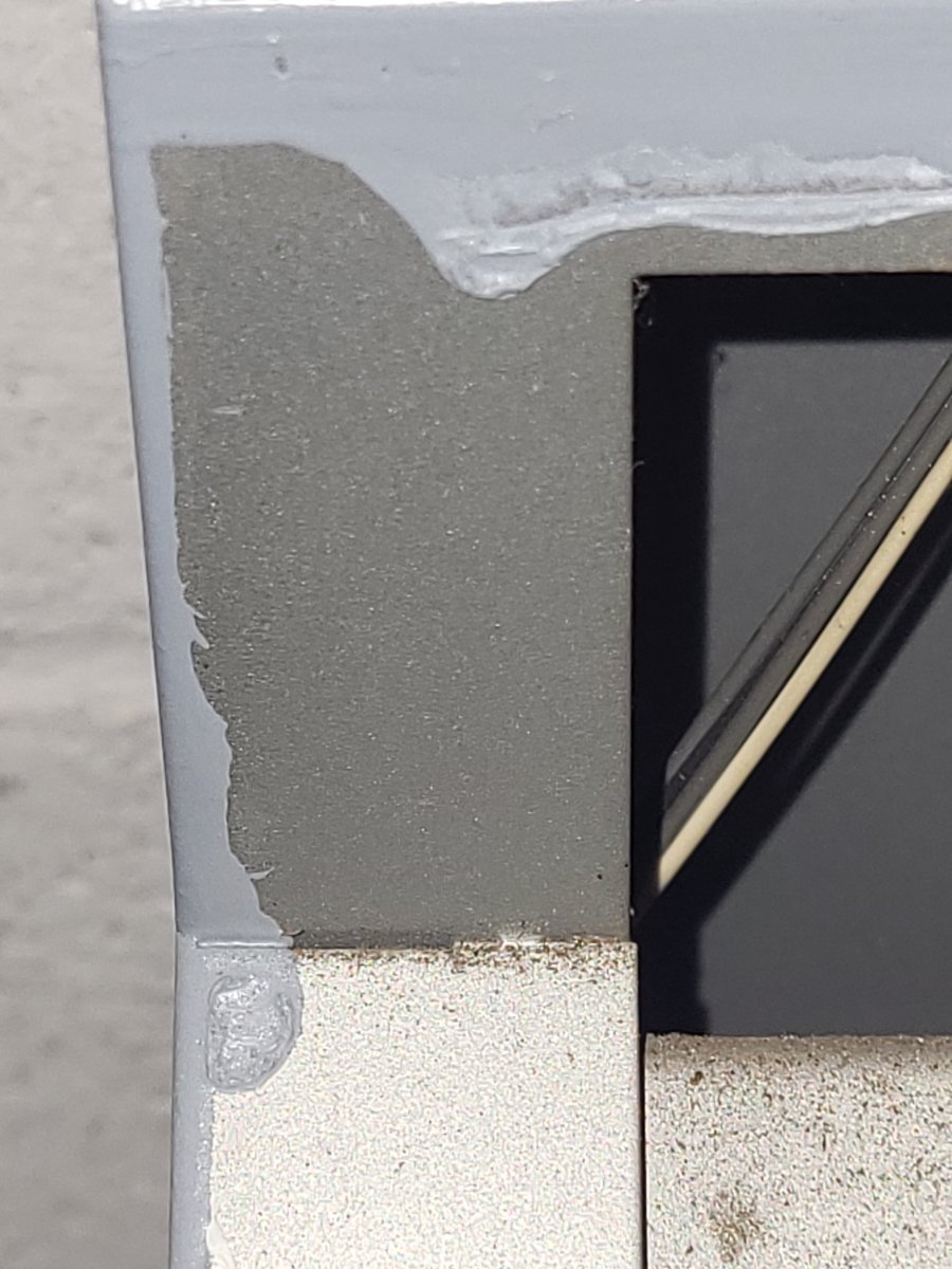

@hoagtech Is correct, it does look to be poweder coating. I have two qualified powder coaters in my area according to the PrismaticPowders website. I and going to continue to break it down and clean and strip. I am guessing it would be cheaper to walk into the shop with pieces that are already prepped.
Now that I see the powder coating, I wish I could just remove this layer of paint and clean it up.
You can.
Try citristrip.
And if you are getting it coated don't bother prepping it yourself. Shops generally have media on site and will media blast it despite your best attempts.
Something tells me that the original powder coat is fine under that paint thought...

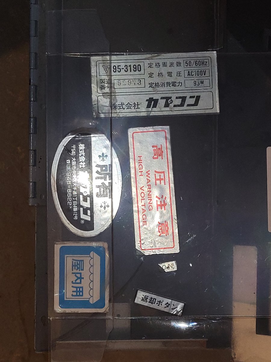

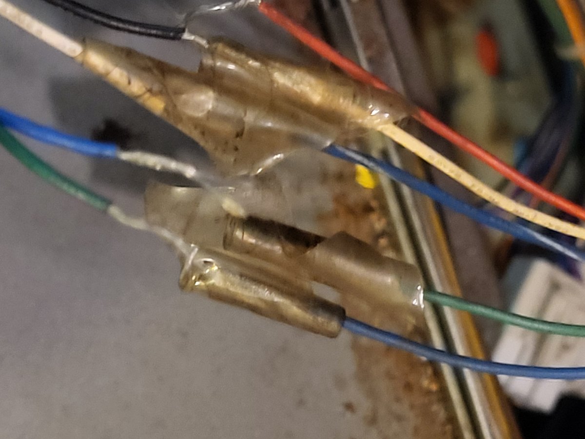

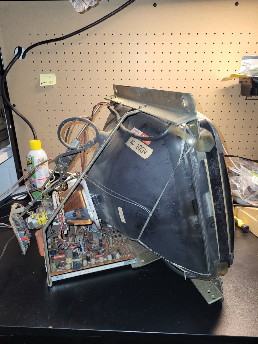

Sooo I finally had sometime to actually contine stripping this down, got the monitor out. Has some funky wiring that I will have to address, and I am more and more leaning toward just hitting this with a stripper to get the paint off and deep clean it with Simple Green. Also I am seeing a lot of original stickers that I would like to preserve, and one that was painted over.

@hoagtech Spoke with 2 powerder coaters in the area who stated that they would be able to color match as long as it was not fully covered in paint. And I have found several spot that were not painted, with the best example being the bottom of the speaker housing.
