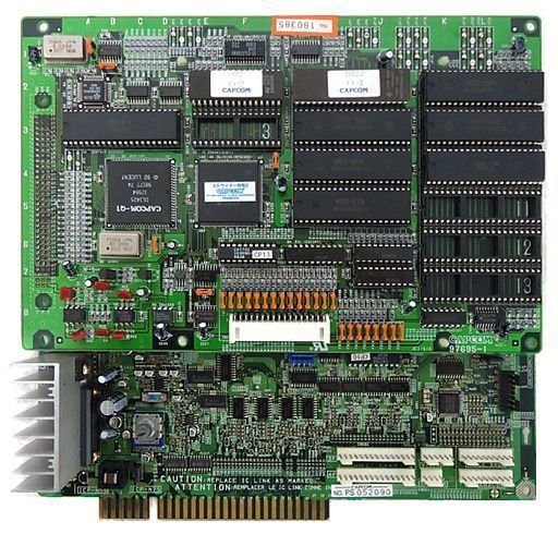

If you really want to have a PLD (PAL, GAL, PEEL, etc.) brute-forced (even if protected and registered) you can send it to me with the board to test it. Quickly becomes costly.@Hammy I have this pcb but it’s not a socketed chip. Is it worth pulling out or do we know that brute force not work on it?
Oh I recently built a dumper and pulled this chip off already. My security chip seems dead though so I can’t test the dump myself. Soon though, I think I found a backupIf you really want to have a PLD (PAL, GAL, PEEL, etc.) brute-forced (even if protected and registered) you can send it to me with the board to test it. Quickly becomes costly.@Hammy I have this pcb but it’s not a socketed chip. Is it worth pulling out or do we know that brute force not work on it?
We can talk in PM (which games, etc.).All CAPCOM zn Gal's dumped! Thanks to @ekorz for the last couple.
The newer security (ZN2, Tecmo) is still not giving in after 2-3 weeks of fighting with it![]()
Hope someone like @Darksoft or @Apocalypse gets time to help out ....
"wall of vague info" sentWe can talk in PM (which games, etc.).All CAPCOM zn Gal's dumped! Thanks to @ekorz for the last couple.
I'd do the same, the worst part about those flash modules though is that they tend to damage the socket by stretching out the pin contacts since they use pin header pins instead of IC sized pins.I'd throw those flash things and replace them with 27c322
Board is not a convert, it has the real keychip. Looks like a repair or something...
Check out twisted's jumper list for the correct jumpers for your game.Thanks for the advice, wasn't 100% sure if I could just swap them, but will do and retry that particular ROM board.
