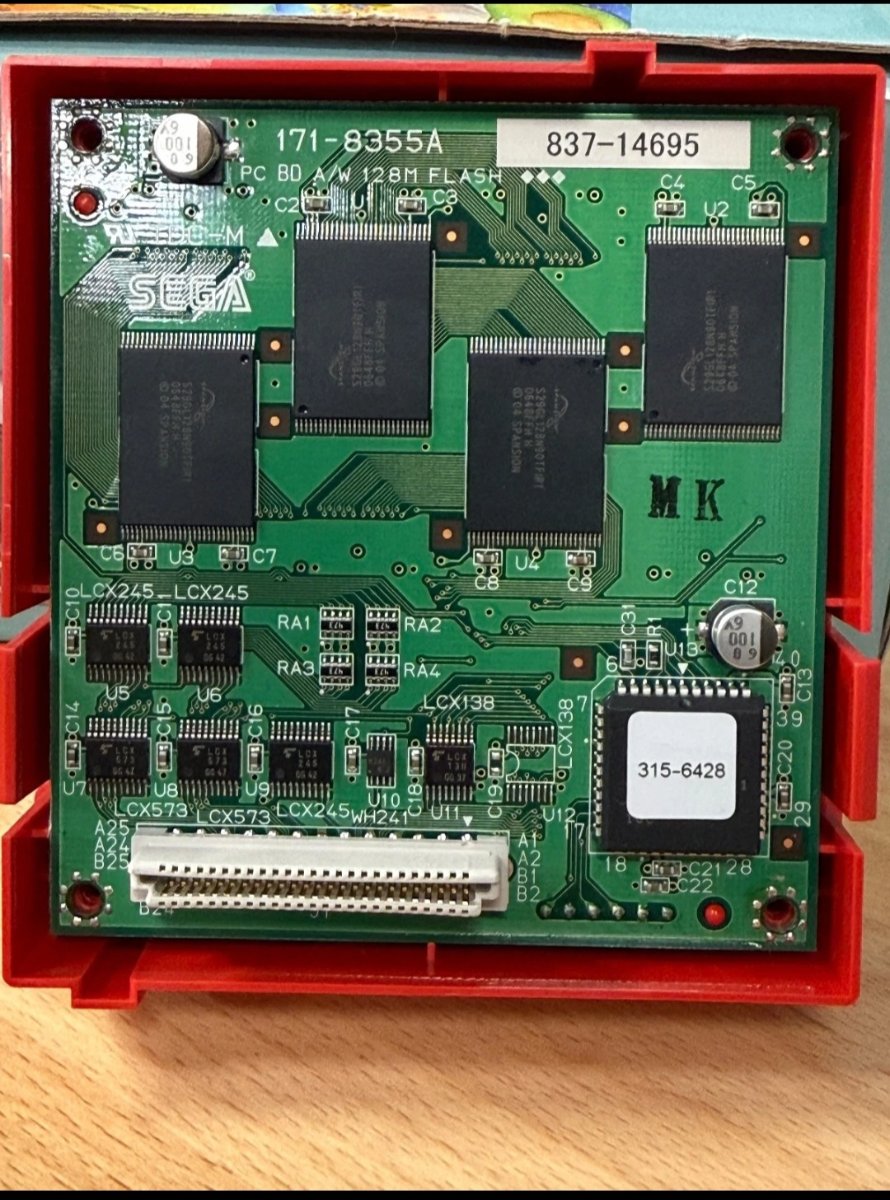

I see some cartridges up for sale. Seller claims this is Bass Fishing Challenge. The label is missing and they are selling it as is. Any way to identify this cartridge by the pcb scan? The lack of Sammy chips has me unsure and Im pretty sure they never made a bootleg of this game. Thanks for any info.

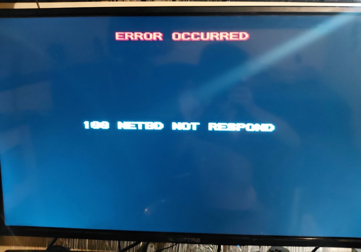

Update: Seems like everyone was wrong on this one. Im getting error "Netb 100" not respond. Only thing I found associated with that error is possibly a missing network board for Extreme Hunting 2. My guess on the game I actually got.
If anyone was curious this is the error message you get when the modem/key chip is missing. I confirmed with a retail arcade store and they were able to duplicate the error with a similar Extreme Hunting 2 cartridge game by removing the key chip/modem.
