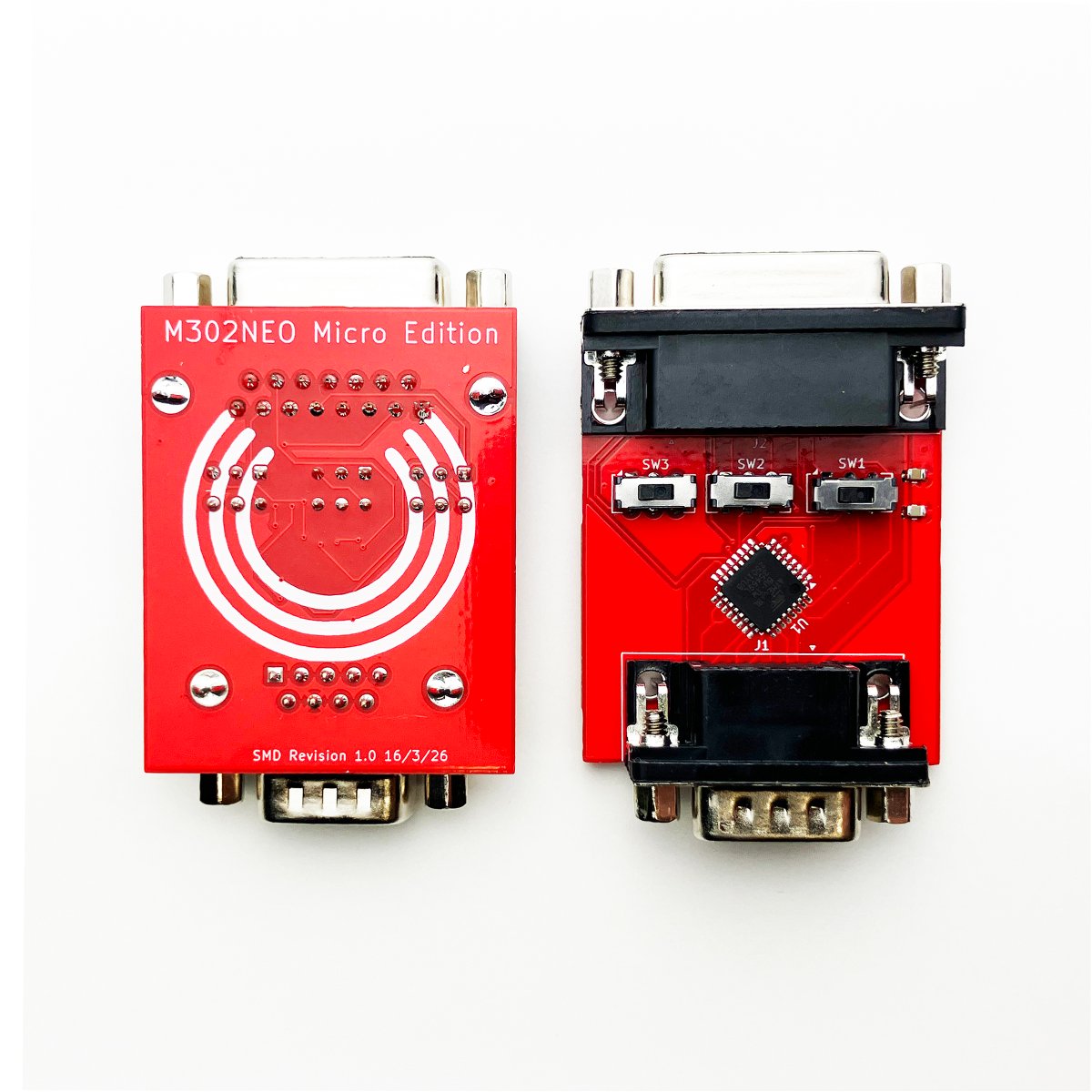

These have been produced and manufactured for the 4 members here who requested them. Thanks to @hatmoose for assisting to make this product a reality and for his fantastic skills and super clean finishing work on the items he makes.
Each adapter has gone through thorough QA/QC checks between NZ and Australia and are ready to be sent out. PM's have been sent.
Thanks to everyone in this thread for chiming in and for their support! Looking forward to feedback when you guys get your packages! If anyone getting one had USB-C M30's, I'd be keen to see if you see what I see on those on your end too.
