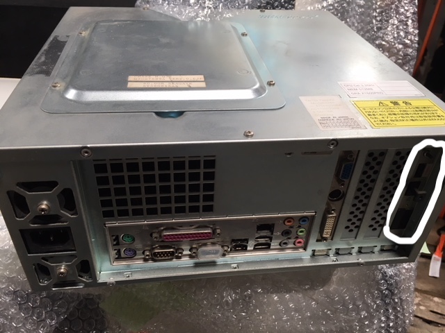

I recently bought a Chase HQ 2 machine, that sadly seems to have broken in transit (or had an intermittent fault). I can only get video output through the onboard graphics but not the ATI card, I have checked and power is going to the card molex but the fan doesn't spin, I have also tried it with another X+ compatible card and still nothing, so I am thinking it may be something to do with the AGP port. I am posting here because as a last resort, I thought I may be able to run the decrypted game on a PC. Is there a Chase HQ 2 version that I could just plug the existing USB from the JVS IO in the cab into the PC as a swap in replacement for the X+?

As an alternative that Taito case looks fairly standard to me (someone that knows more about taito may prove me wrong though).
You could probably find a generic motherboard as close to the original as possible (same cpu and chipset) on eBay and just swap it in :)
> You could probably find a generic motherboard as close to the original as possible (same cpu and chipset) on eBay and just swap it in You could probably find a generic motherboard as close to the original as possible (same cpu and chipset) on eBay and just swap it in
Yeah, good shout, I am going to do some continuity checks on the MB and see how dead the AGP port it is. If I can't salvage it, then it would be great to just switch out the MB, would save another 400 quid on a CHQ2 X+

Thanks for that, of course! I should have thought of that, definitely another option. Here's a pic of the machine. It has all the original pedals, stick and steering wheel, I think the seat has been switched out for a Crazy Street version but otherwise they are the same.
