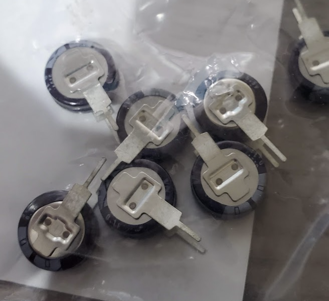

There is a small Super Cap under the Media Board UNDER the CR2032, it will leak, and it will take out traces. if you have teh system apart, replace it. i have attached what they look like.
There is a small Super Cap is only for the backup if you change the 2032 to keep the settings short
