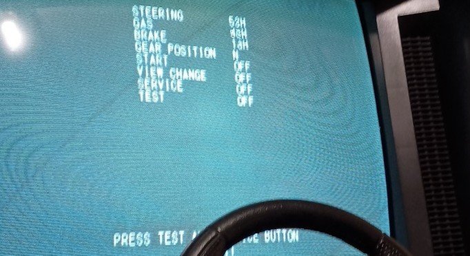

- I was able to hook up the MIDI servo board to the cabinet in place of the Model 3 servo board. Force feedback works great... However, I found an issue with the JVS IO below
- While the steering wheel is centered perfectly at 80H when connected to the Model 3, my steering is only giving me about half the range as shown in the photo, when I connect only the pot signals to the JVS IO board. I have the Model 3 stuff all disconnected, so the old drive board must be doing some auto calibrating.
EDIT #1: Andy Geezer provided me great insight that the steering pot goes directly to the JVS IO or else the values go crazy if still shared with the drive board. As I'm currently on vacation until the 15th, I won't be able to find out until I get home then.
