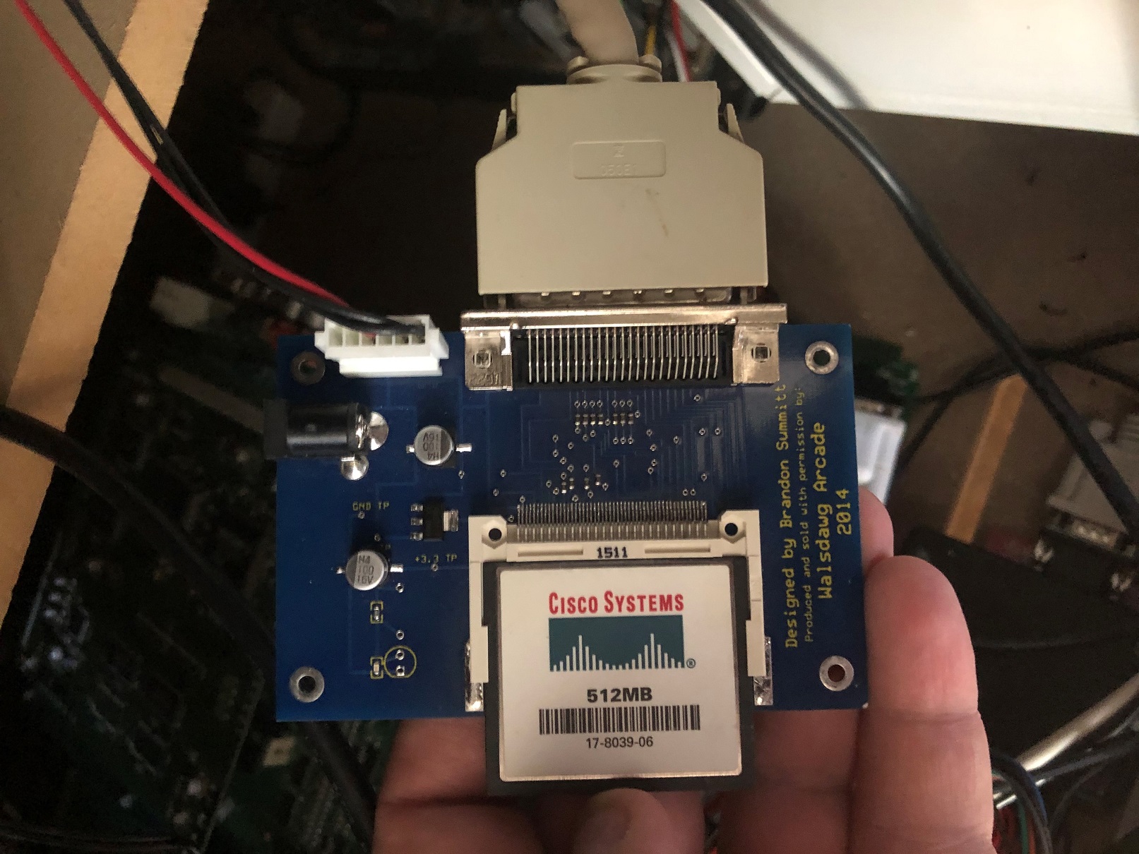

Hey Guys,

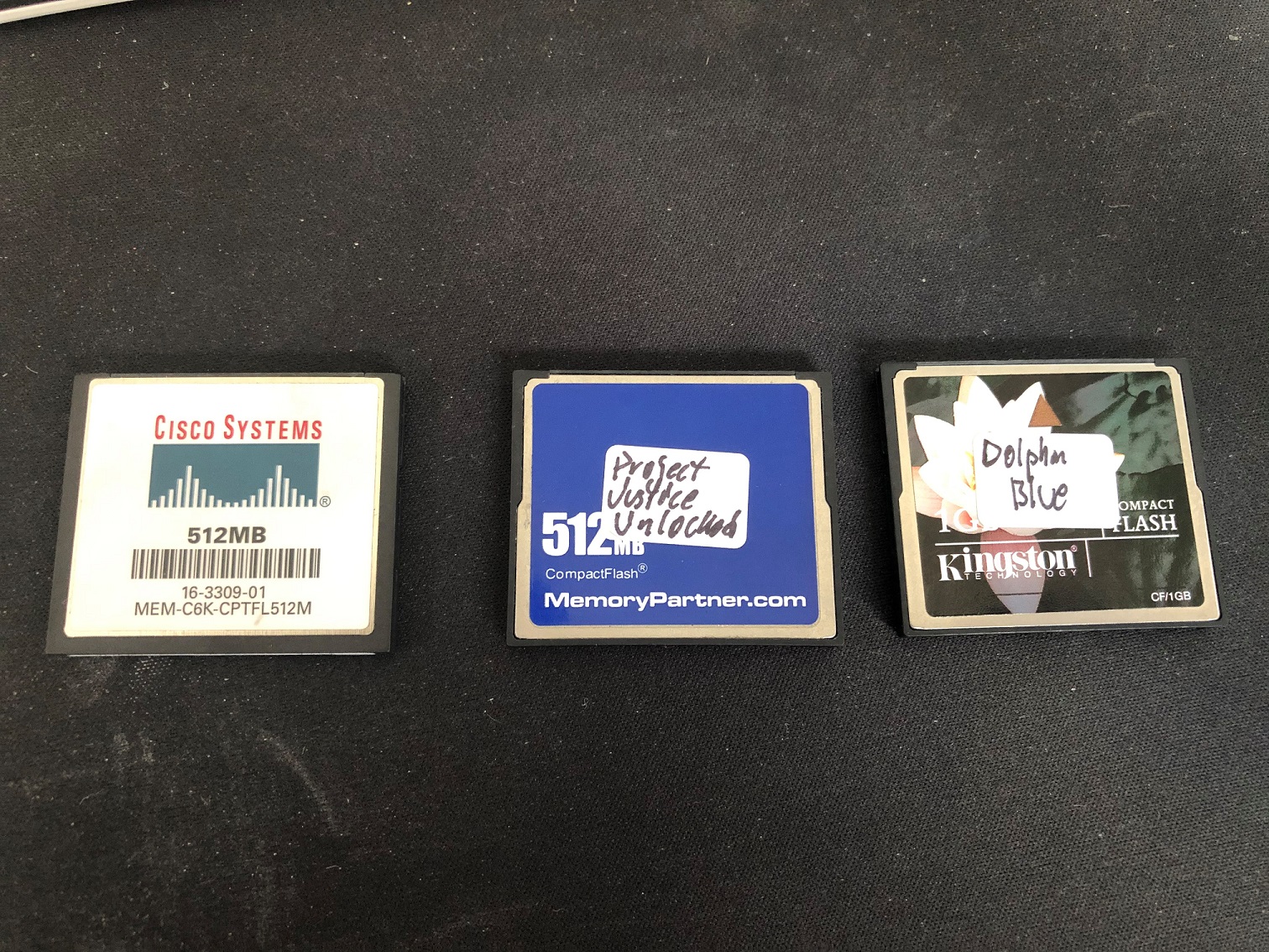

Just picked up a CF setup and I'm having some inconstancies when booting up. With used Cisco 512MB cards I got off eBay, it boots up every time. I also have some Memory Partner Ones and Kingston ones that sometimes work. I re-flashed some of them and they were working at first but now it just boots up a black screen, never get the Naomi screen with them. I'm using the newest version of GFCI on Windows 10. Checked the DIMM, Swapped out the ram, the battery, the small board, the serial cable. No difference. Also checked my voltages off my Sun Power Supply and I'm at 3.3, 5.1 and 12.2. Do you know what causes a no boot to a black screen based on the CF card? I know my security sector is right. I also have better luck getting them to boot if I first boot a known good one and then power down and try a picky one.
Any help would be appreciated.
@maiden2099 so what you are saying is that all is good if you use a Cisco 512 MB card ?
What kind of CF setup do you have ? Pictures of the adapter please.
@rtw Yeah, Cisco cards give me no trouble at all, can re-write them and they work first try. But the Memory Partner and Kingston ones work occasionally but mostly not. Checked the voltage on the reader and its coming in at 3.304V which should be in perfect range of any CF card.
From your description it sounds like those cards are not compatible.
Keep buying Cisco :)
From the picture I see they are cards I provided which I found to work great for me consistently. Thsts the frustrating thing about Naomi. There is so much involved that its hard to troubleshoot and recreate problems.
it could also be different firmware in some cards.
i had a problem with a crucial card in something once - native IDE mode was not right.
i contacted crucial and they swapped the card for one with a different firmware revision but the same model card - and it worked.
i know a similar thing happend with sdcards in nintendo handhelds - it was a specific firmware revision in some sandisk cards and the company did an exchange for people.
