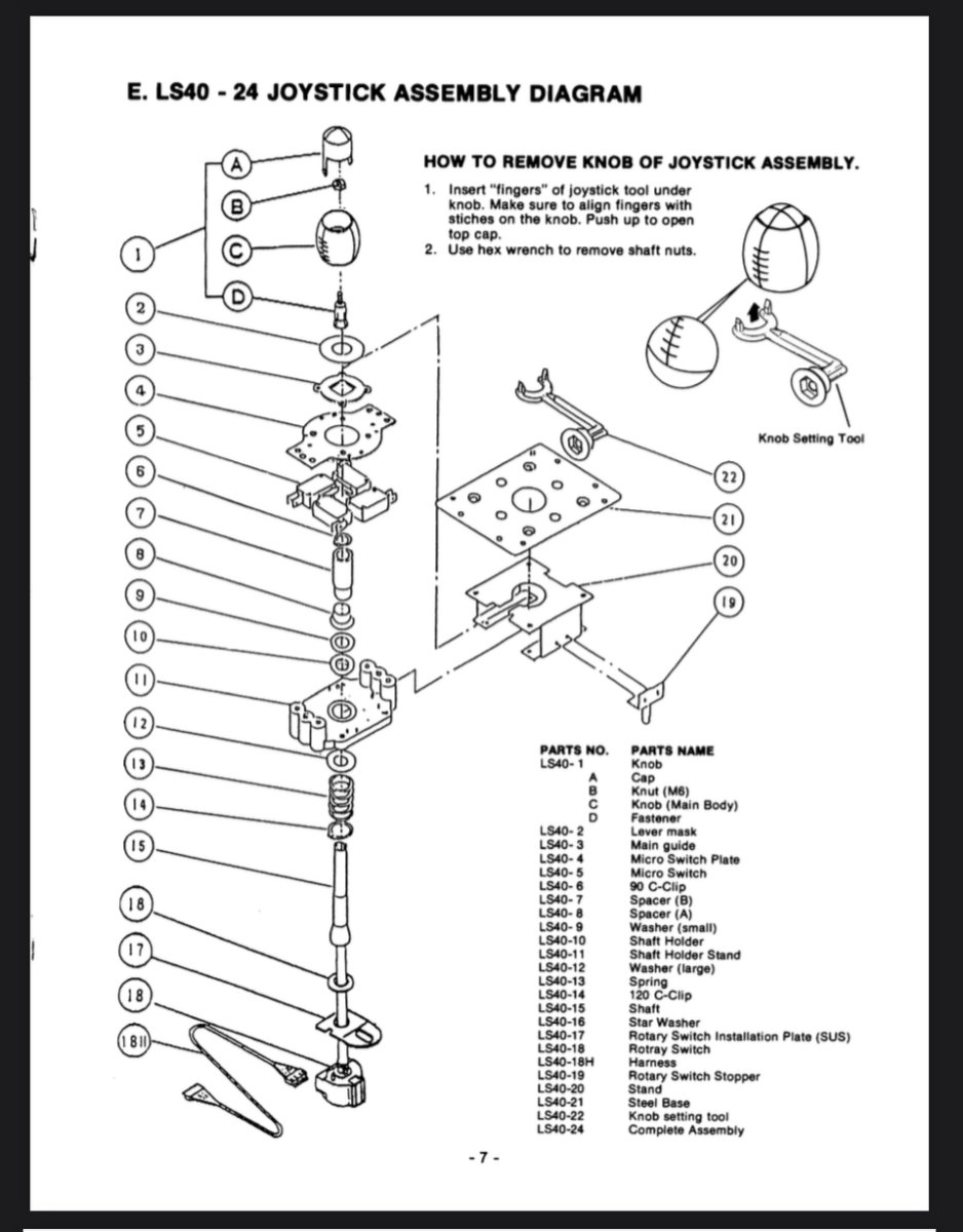

So looking into the manual for Touchdown Fever, it uses an SNK LS-40 joystick, not a Loop 24, and uses the 100 position free spinning encoder wheel with no notches that was posted disassembled earlier in this thread.
The Loop-24 for Cal 50 is just a 24 position encoder wheel as originally suspected, so the method outlined in the first post here should work, if you can account for the rotation speed.
See this thread for Loop 24 pics:
https://forums.arcade-museum.com/threads/snk-cal-50-loop-24-rotary-joysticks.512206/
Maybe this info would help to get this off the ground?
