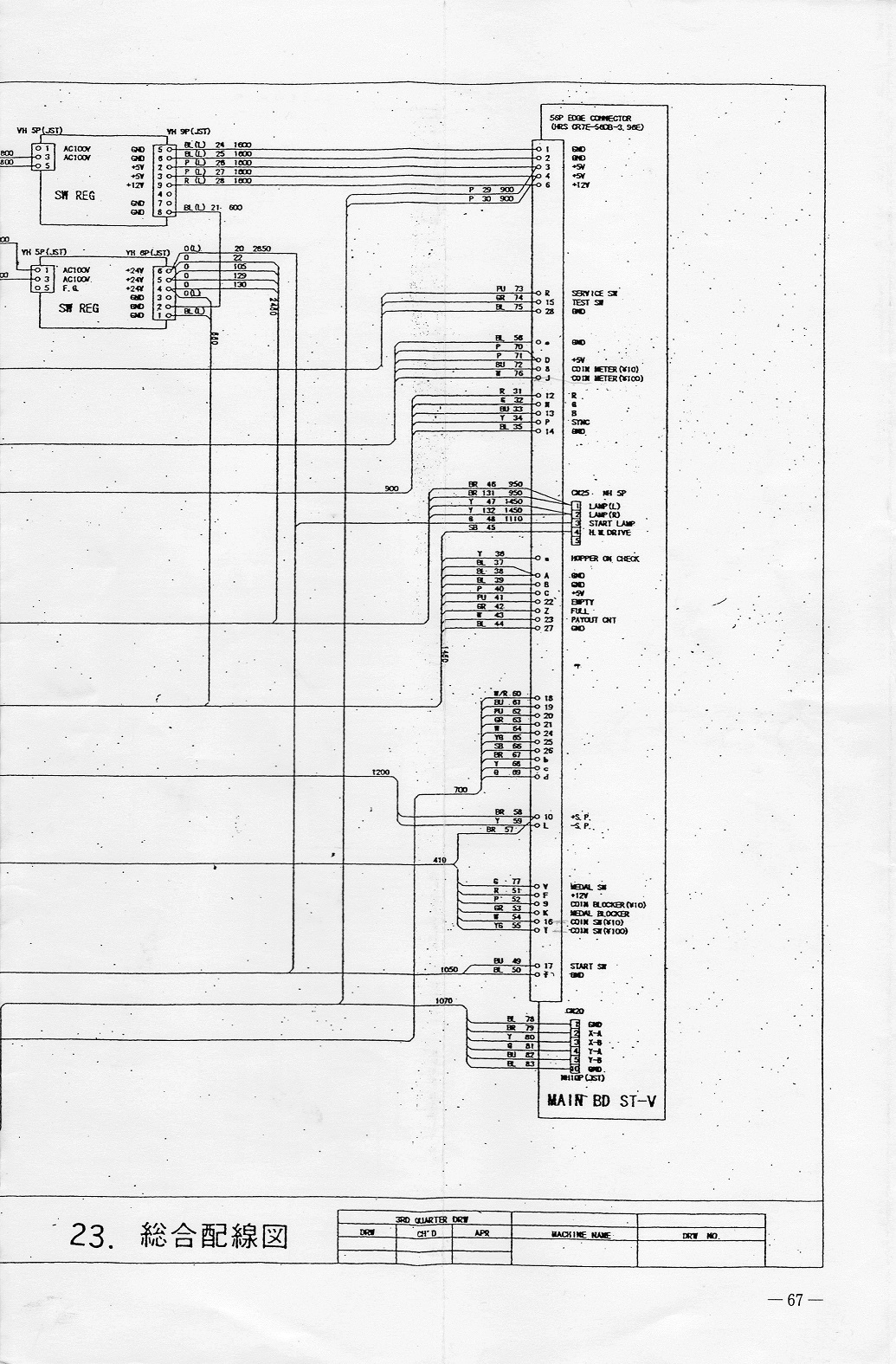

I'm assuming it expects the sensor line to go low for x number of seconds? I wonder if that's something that could be simulated on hardware with a cheap 555 timer. or is this something that could be disabled in game options?besides trackball this game require hopper (simulation) - when motor line active game expects sensor line will toggle.

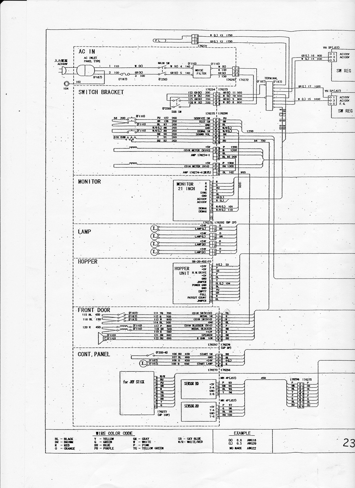

that's good. that just means it's likely a simple switch.In the schematic I see there is a 'hopper check' line at Jamma connector 'a' (2p B2)
would it pull it to GND or to 5v you think?that's good. that just means it's likely a simple switch.In the schematic I see there is a 'hopper check' line at Jamma connector 'a' (2p B2)
