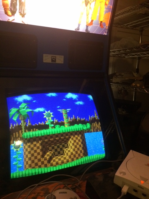

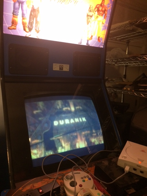

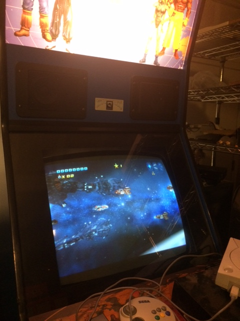

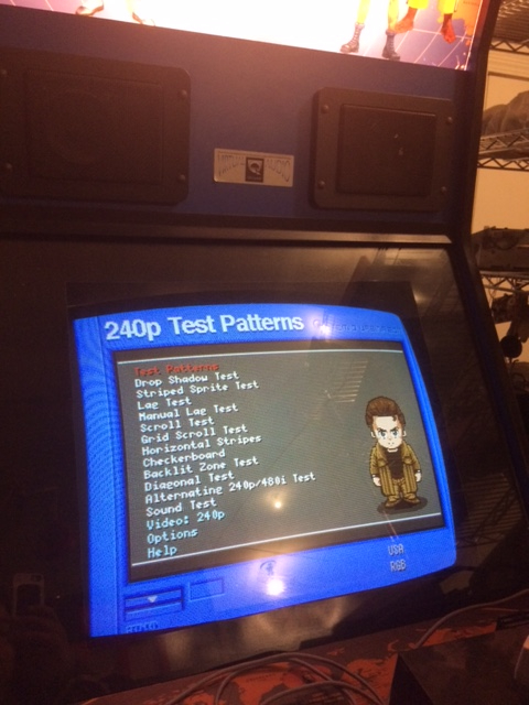

So far so good with what I am attempting. In my situation, no need for clamping, DC restoration, or video amping for the consoles I am targeting (PS1, PS2, Saturn, Dreamcast). The only thing that is needed is harvesting the RGB signal from the consoles with the proper cables or adapters, and stripping sync where needed. And having a monitor that can accept the AC coupled RGB signal from consoles. In my situation, that is a Wells Garner K7000. Right now I am getting a nice image with all the those consoles on that monitor. I am even impressed with the small sample of PS2 games that play @480i!
Here are a couple of snaps from the Dreamcast where I am playing around with 240p Test Suite and Sturmwind.

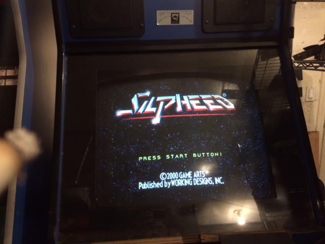

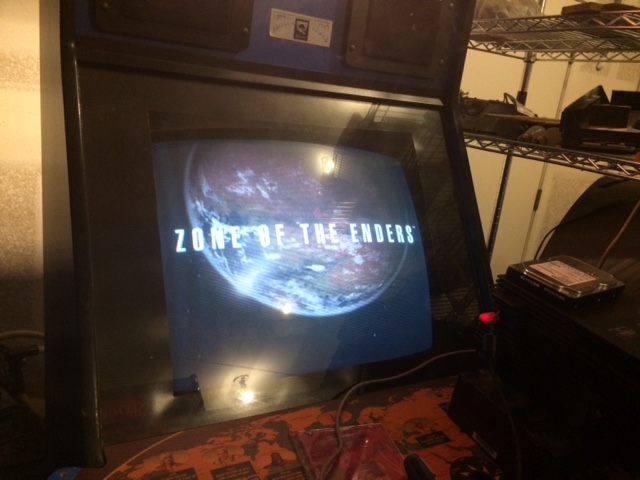

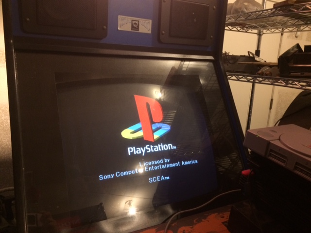

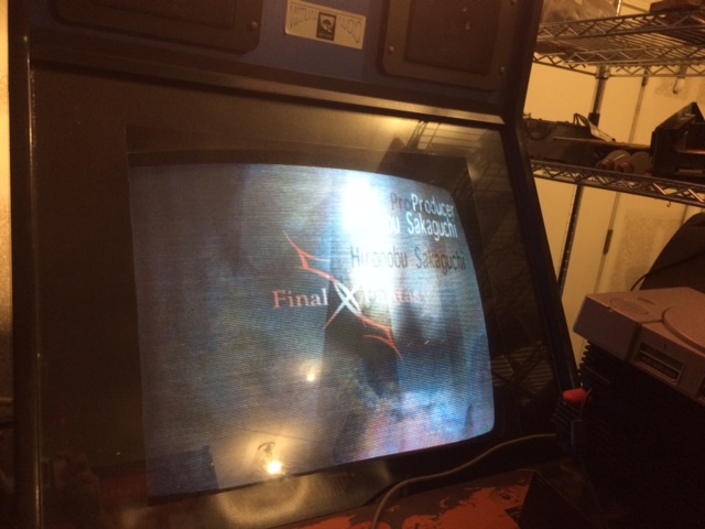

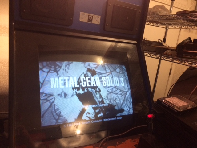

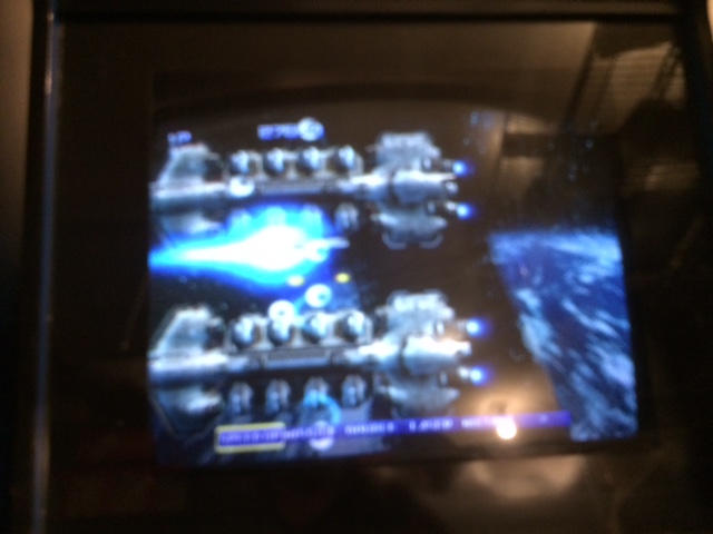

Got the two MC Cthulhu boards, but one is dead, sonuva!! Anyways, here are some more pics. Of PS1 and PS2 in action. I am Free MCbooting the PS2 games. Will mod the PS1 and eventually get a PSIO. Hoping to grab a Phoebe for the Saturn. Already have a GDEMU for the Dreamcast.
Not trying to collect. Just want to play the games on a cab. The whole purpose of this effort is to play titles that originated in arcades but ended life on consoles (Gradius V, R-Type Delta, Final). Or play titles that were inspired by arcades but only lived on consoles (Einhander). Or are just too damn expensive to own the arcade version of, so I'll settle for a good console port over MAME emulation (too many to list).

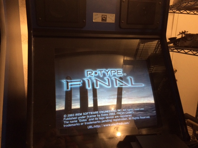

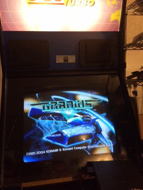

And here are a few that are best played on the comforts of a couch or have analog control and can't be played on a cab. I was just seeing how these looked on my cab:
