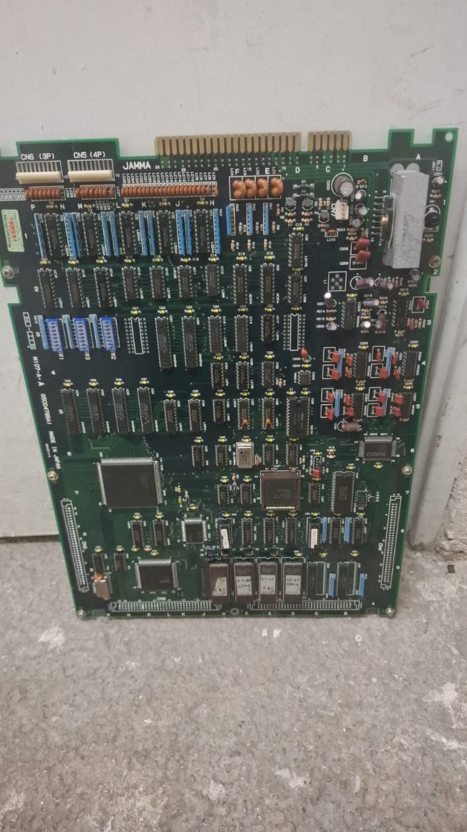

Casaborg Student Joined Aug 14, 2020 Messages 46 Reaction score 9 Location Chile Jun 13, 2026 #1 Can i convert dream soccer 94 to something else? Thanks Attachments IMG-20260612-WA0228.jpg 163.1 KB · Views: 26
pacman70 Student Joined Sep 25, 2016 Messages 31 Reaction score 53 Location Italy-Rome Jun 13, 2026 #2 you can convert to air assault / fire barrel
Casaborg Student Joined Aug 14, 2020 Messages 46 Reaction score 9 Location Chile Jun 13, 2026 #3 pacman70 said: you can convert to air assault / fire barrel Click to expand... Thanks. Do you know if it's something easy, meaning just a ROM swap and some PAL, or does it require something special
twistedsymphony Enlightened Staff member Immortal Joined Jul 21, 2015 Messages 12,944 Reaction score 16,449 Location NH, USA Jun 13, 2026 #4 I think like most IREM conversions you'll need decrypted sound ROMs. I think on this one Dream-soccer and Air Assault also used different sized graphics ROMs which requires some jumper changes as well.
