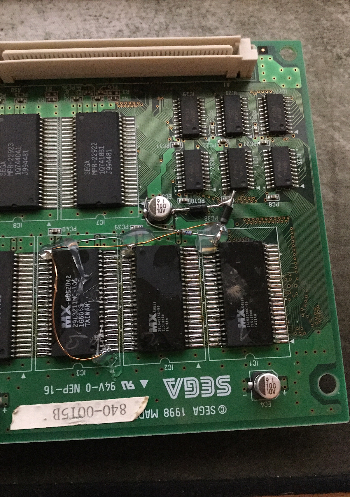

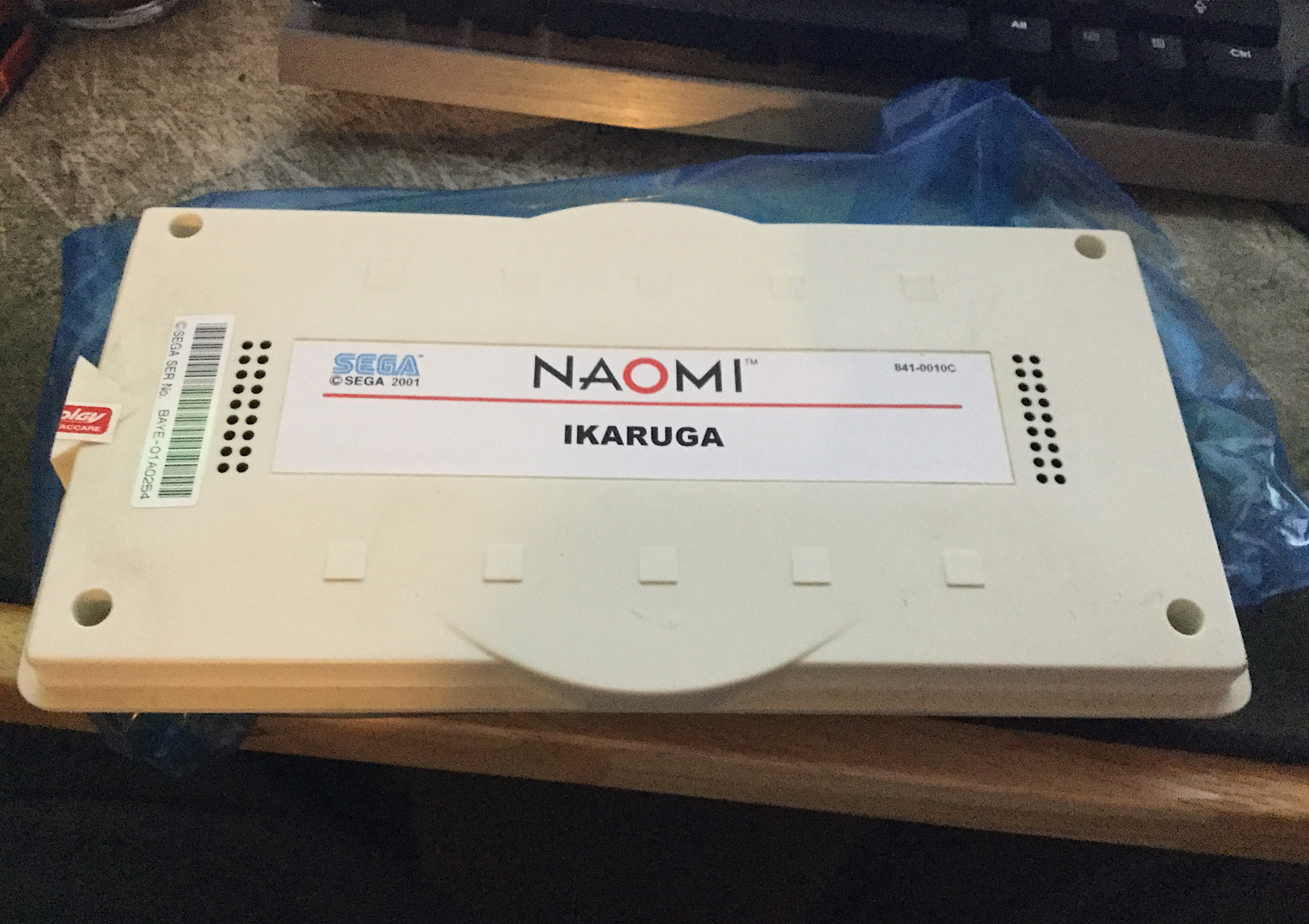

Some dude on eBay is selling ikaruga carts. I’m a sucker for ikaruga and didn’t want to buy the Gdrom version but this works for me. Serial # starts with BAYE. Not sure if that is enough to tell what game it was. Hmm, just looked at my Virtua tennis cart and also starts with “BAYE”. So I don’t know.

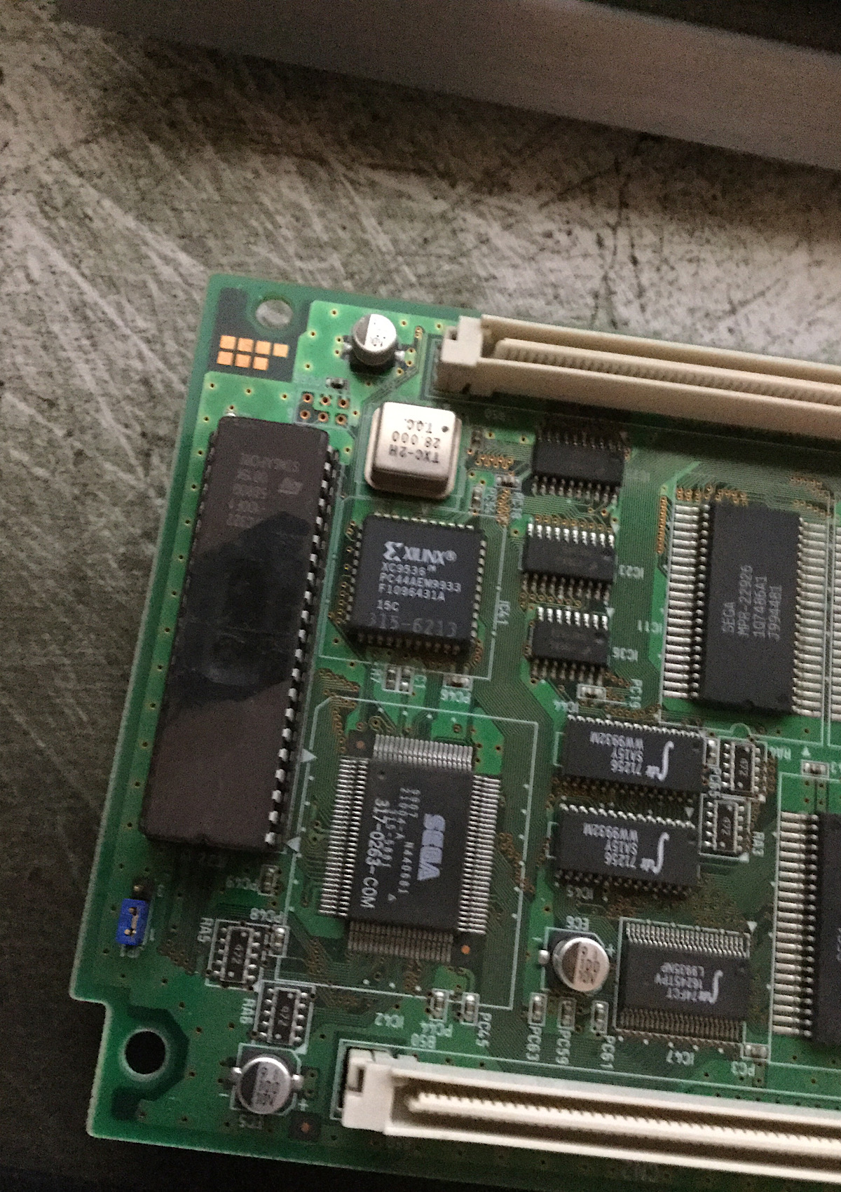

Curiosity got the best of me so I opened it up. So 3 ics replaced, some wires and diodes, a resistor and a burned eeprom.

Awesome! I didn’t know about this! Can anyone burn me a rom please? Probably time I get a burner really, but if anyone can sell me one for this game that would be awesome.
I don't think it's THAT easy compared to say a socket chip on a cps2 board. I believe you'll need a hot air station and some surface mount soldering skills to change out those roms.
NOPE. its 1 socketed ROM, you just program the patched one and pop it in.
COOL. Something I did not know
