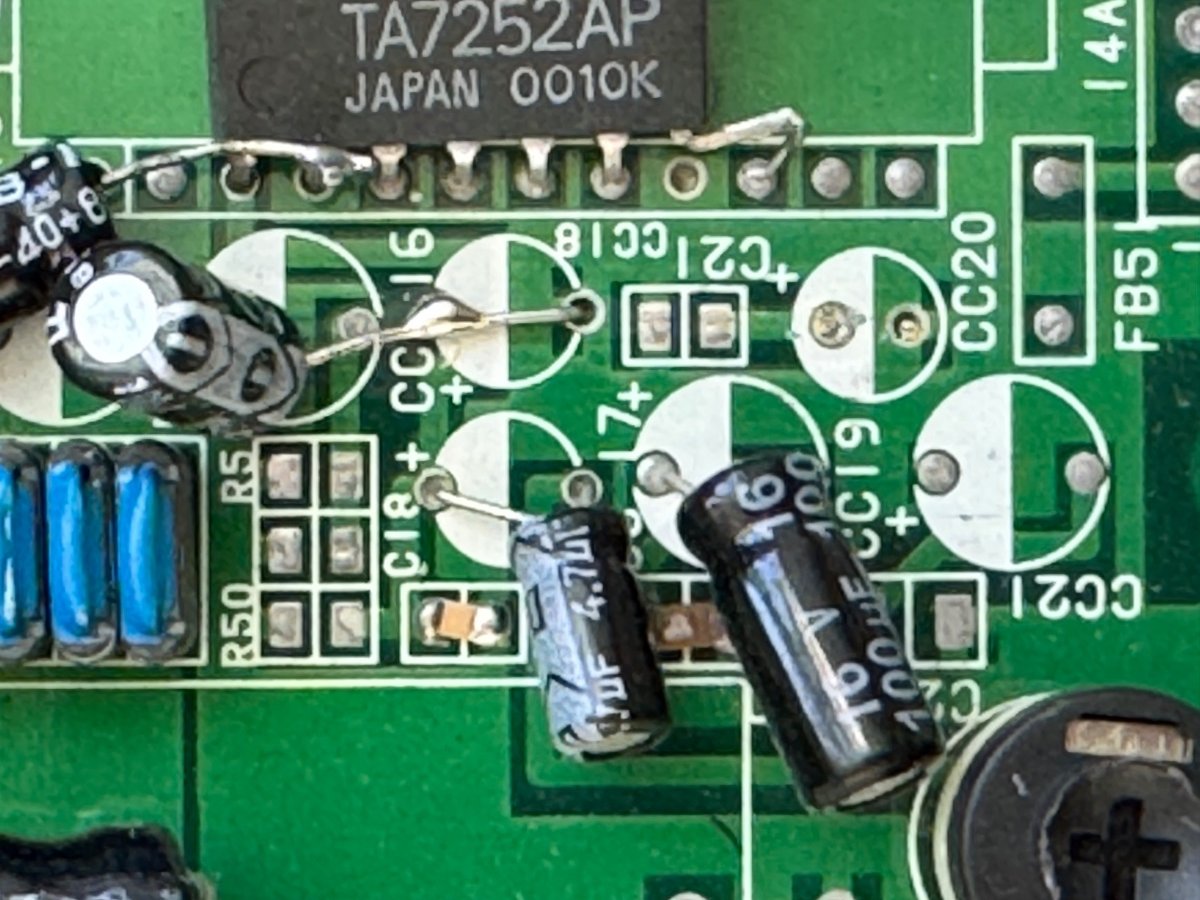

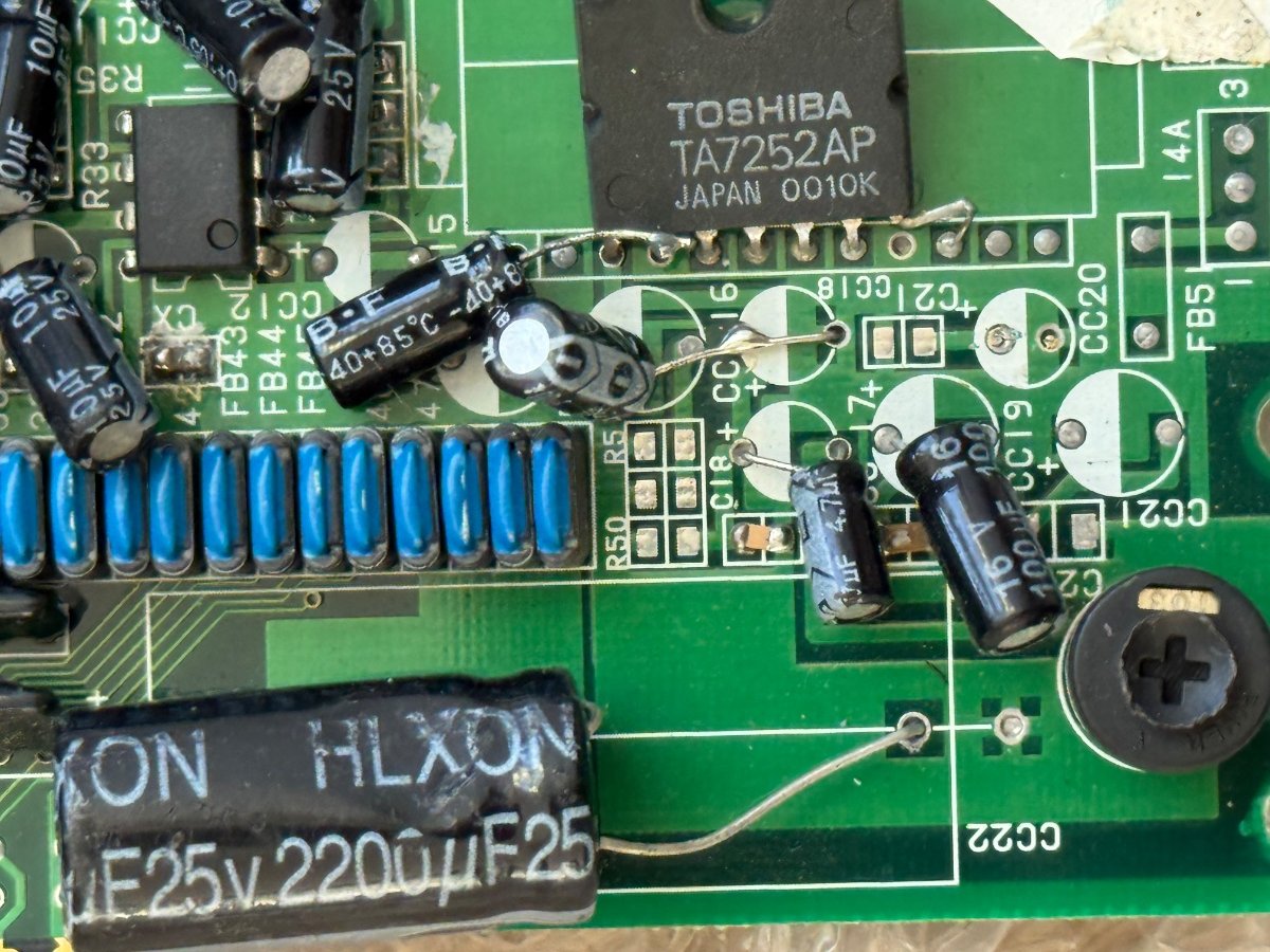

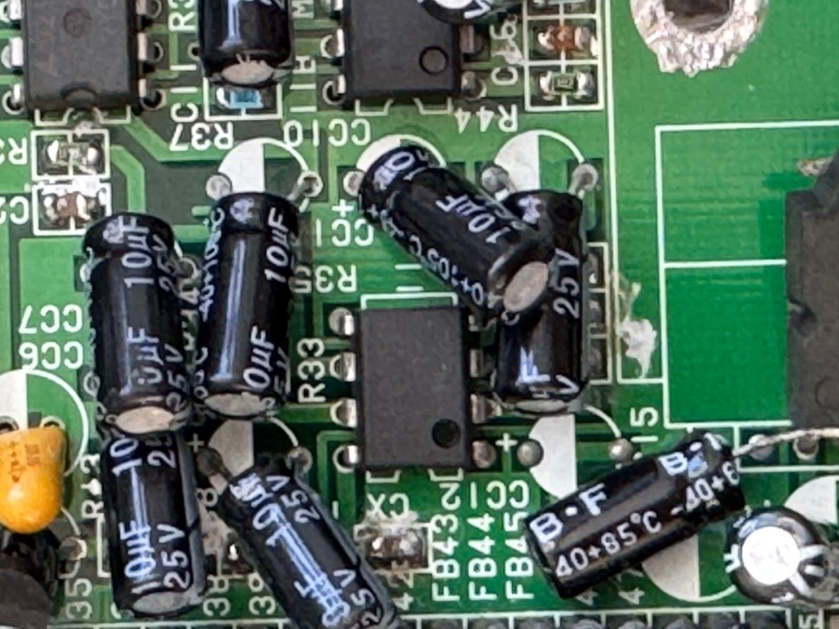

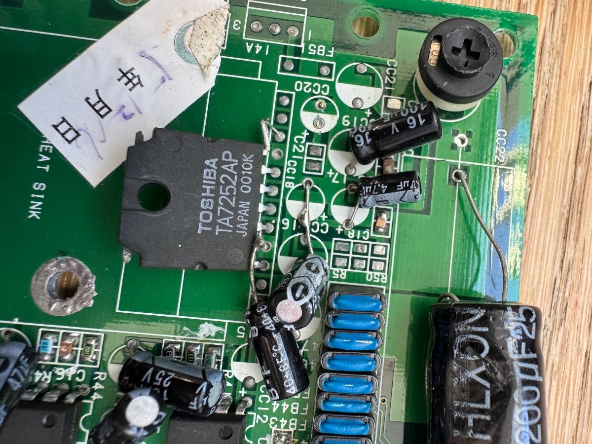

Hey guys,
I have a dodgy cps 1.5 with the Chinese rebuilt audio section.
The board looks, play and sounds good.
However I would like to rebuild the audio section.
Has anyone done this or have a part list. It looks like it should be easy if I have the parts, which I assume are an amp module and a few caps
Cheers

I have done this.
I recommend Chipquik to pull the amp.
Console5 has a cap kit.
If it still sounds different after you have knock off audio chips that also need replacing.

Thanks for the lead, did you have a list for the resistors also ?
so far i have a caps list from KLOV https://forums.arcade-museum.com/threads/capcom-cps1-cap-kit-information.449697/
The audio amp is a Hitachi ha13001 (heat sink still eludes me)
Label Volts Microfarads
CC6 16 10
CC7 16 10
CC8 16 10
CC9 16 10
CC10 16 10
CC11 16 10
CC12 16 10
CC13 16 10
CC14 16 47
CC15 25 100
CC16 25 100
CC17 16 10
CC18 50 4.7
CC19 25 100
CC21 25 100
CC23 50 2.2
Unlabelled 25 2200
