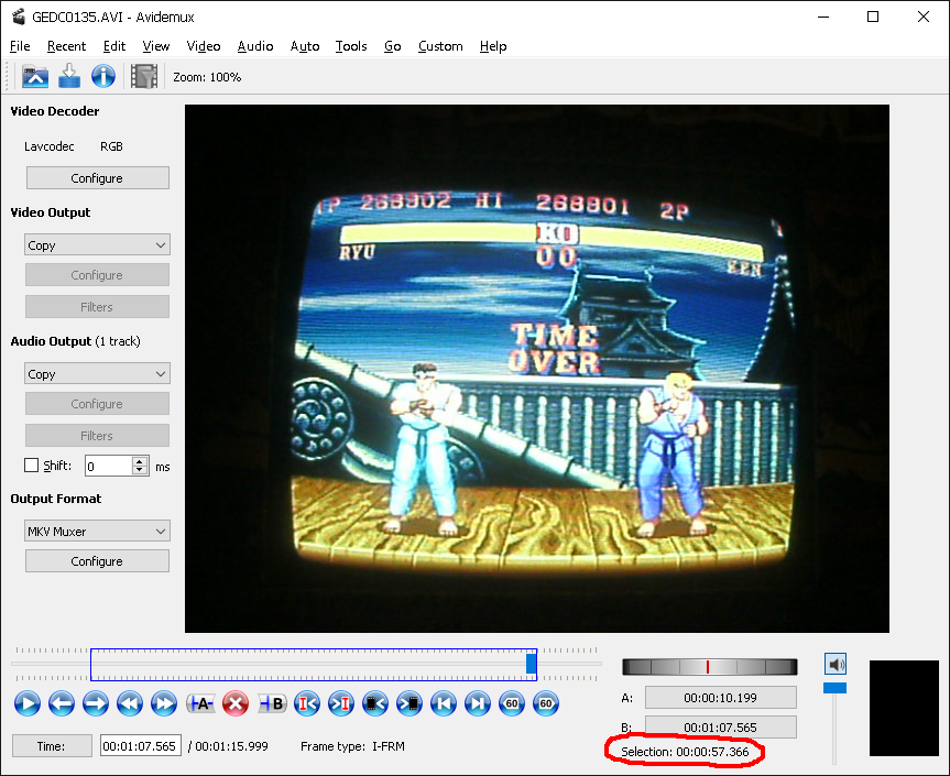

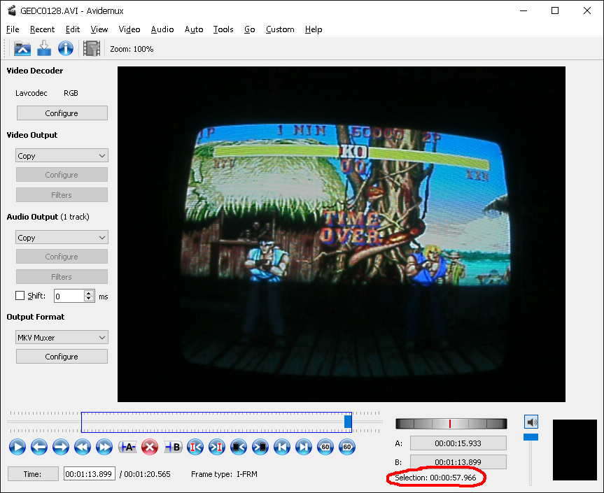

I did the same test again, both on the Ryu and Blanka stages using the same camera and 60i frame rate, but this time with a 10 MHz crystal instead of the 12 MHz crystal I used before. The results:
12 MHz (from previous test)
Ryu Stage: 54.232 seconds
Blanka Stage: 55.199 seconds
10 MHz
Ryu Stage: 57.366 seconds
Blanka Stage: 57.966 seconds

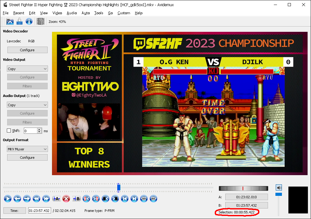

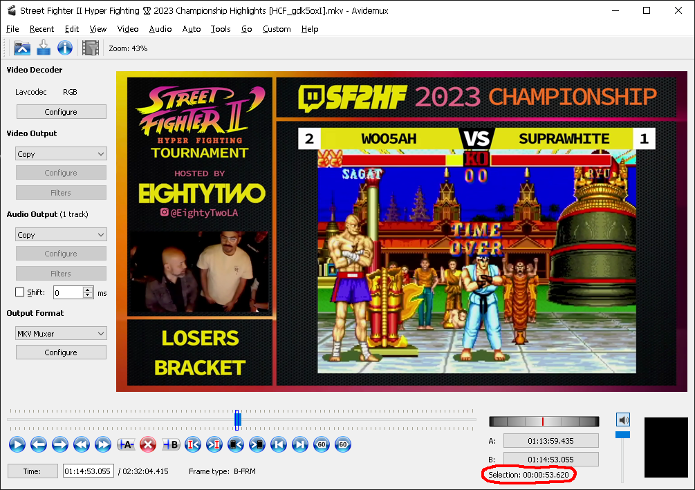

It looks like the speed varies by quite a bit even on the same stage. Here are two fights that went the distance on the same arcade machine at the same tournament on the same stage in the same video:
55.422 seconds vs. 53.620 seconds, which is almost a 2-second difference. Ryu vs. Ryu in one of them and Sagat vs. Ryu in the other.
