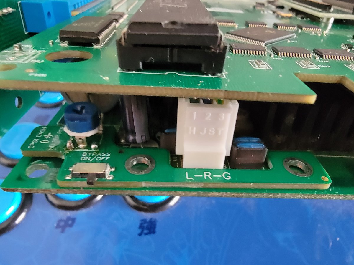

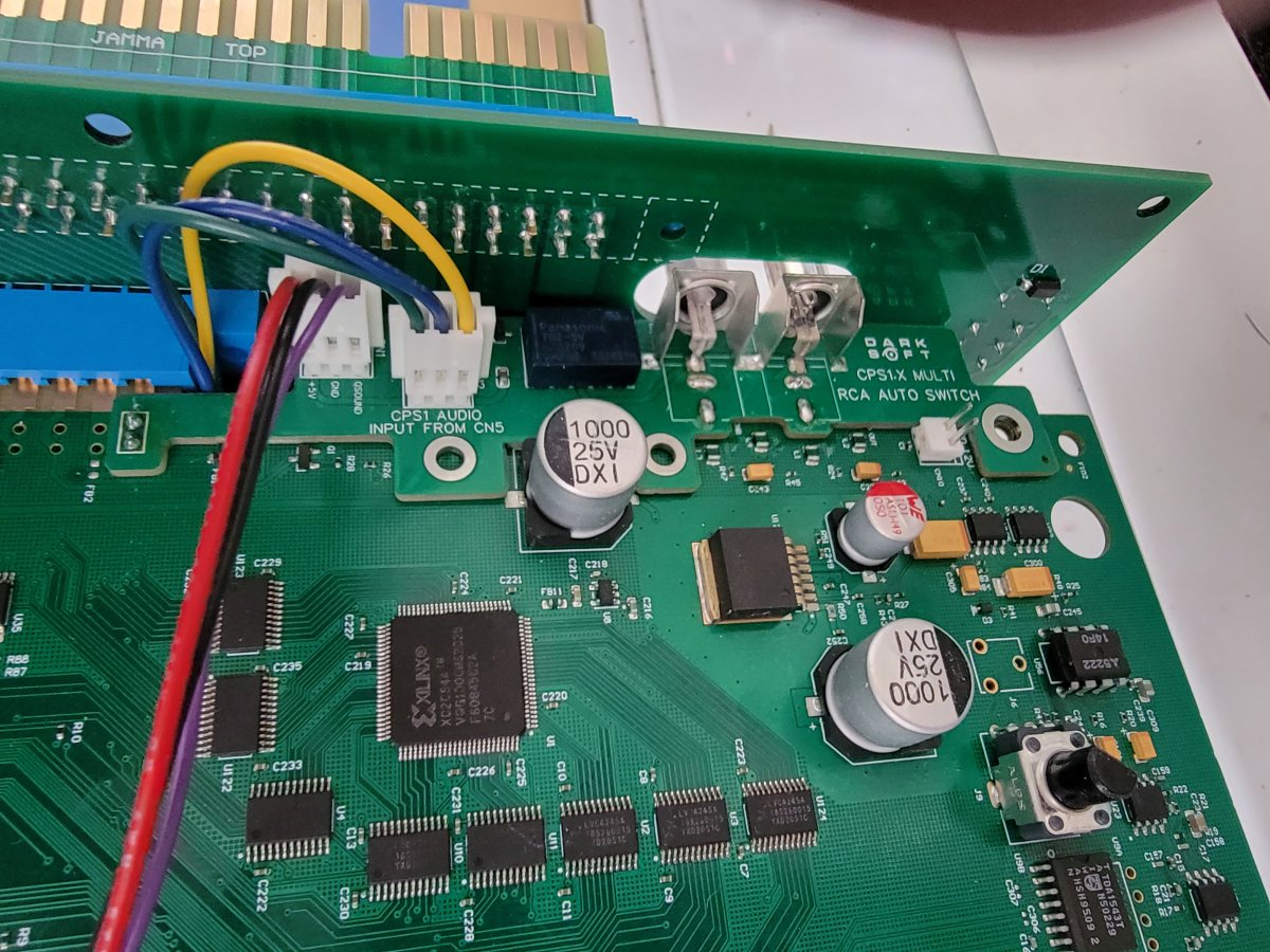

Derick2k sent me a prototype of the audio merge kit and I installed it over the weekend. Install requires one to remove the two rca jacks off of the multi and install a pcb in their place. This pcb is powered via a 3 pin connector. You must tap 5v, ground, and the Dash signal from the multi to plug onto this connector. There is a cable used to tap line-level from the cps1 A board via the CN5 connector. This cable plugs directly from CN5 to a connector on the audio mod pcb.
The other part of making this work requires modding the A-board by removing the sound pot. CN5 does not output actual line-level unless the volume pot is removed. So to remedy this we remove the volume pot and install a small pcb that adds back the volume pot but with a bypass switch so we can choose whether we want jamma audio (bypassing the pot mutes jamma audio) or proper line-level. Note that doing the A-board mod is not required but I'd you don't you will have uneven channel volume and bad sound mixing.
One thing we may add is a volume control between CN5 and the audio pcb. Currently you can't control the volume from CN5 unless your cab has a volume pot. So some cabinets, such as q25, have super loud music because you can't lower it via the pcb.
Comments are appreciated. Pics below:

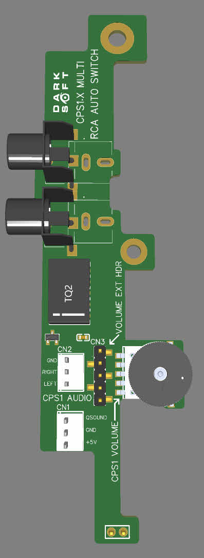

Slight update:
So I added an optional thumbwheel volume pot and an extension header.
Both are optional and can be used as follows:
1. If you dont need them, you can just bridge the pad and pass the audio straight through.
2. You can use just the thumbwheel pot to control CPS1 volume internally, I would use it as a set it and forget it and adjust the volume level to your liking for your setup
3. Use the extension header to route the audio lines and mount a volume pot of your choice somewhere on your case or outside of it.

This new pcb will combine CPS1 sound and CPS1.5 sound, both in stereo, and output both through the RCA jacks.
The kit will contain two pcbs, one to attach to the DS Multi itself, and one to attach to the "A" board, to bypass the new mod, and output CPS1 and CPS1.5 via Mono on the Jamma edge.
