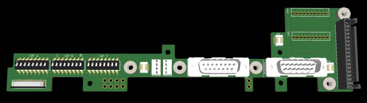

I hear what you are saying. At one point I was designing a filterboard add-on to incorporate a lot of things, but in the end, it would have been better to make a new filterboard, so I abandoned the idea.Personally, I'd even be willing to desolder my filter PCB connectors, and apply them to a new filter PCB, with this circuitry added, and some RCA pass-throughs built into it, so that it was more cohesive.

Is it possible to learn this power?... I was adding a few more things, but ultimately I settled that a new filter board would be better. Hell, I was finishing up work on selectable dips settings based on the game being loaded.

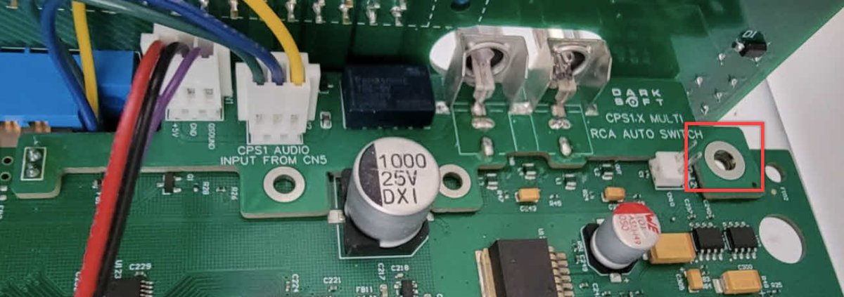

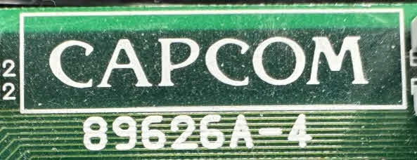

Im testing on this parts Dash A board for fitment purposes, not sure if there are other revisions of the Dash board.
Are these holes used/occupied in either case?
And same for this one on the multi, does either case occupy it?

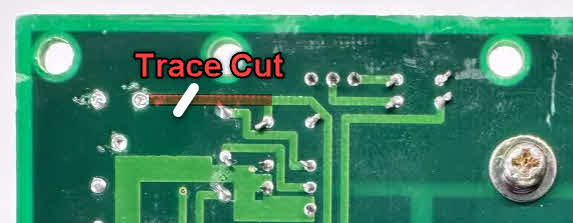

As far as keeping the CPS1 volume pot in place, this trace WILL have to be cut. I think I like this idea

That one trace being cut, seems like a small and easily repairable sacrifice to leave that pot in place, so I agree.
