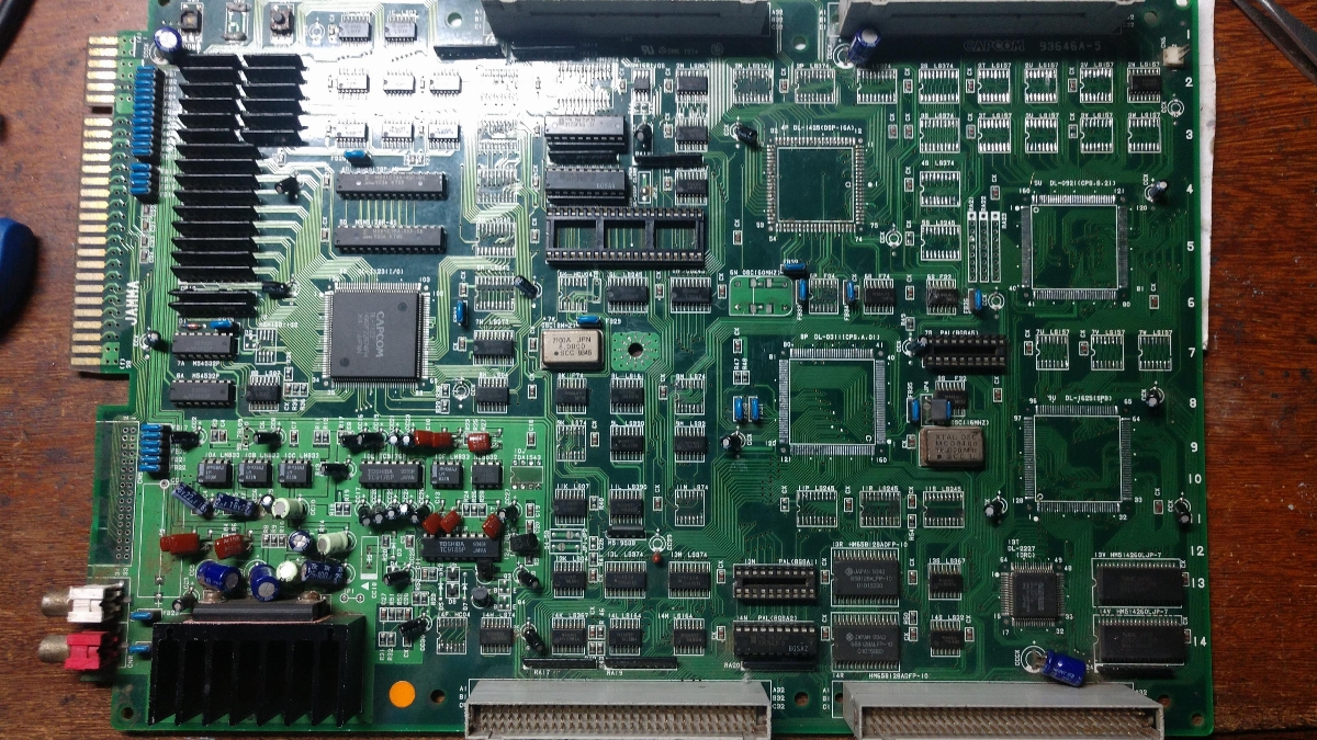

The client alleged that the PCB had problems with the graphics and no sound.
I tested the board and it just show me static garbage screen, for this only reason I continued the repair, as it means that something still works.
I separated A and B boards and noticed that the cases had a liquid on it, just like when B board has a leaking battery. I did check it and there was no leakage. Tested on another A board and everything was fine, excluding problems on B board. I removed the battery just in case.
Going for the A board restoration, its case was also dirty with liquid, looking like leaked lithium, however, was alot, it even looked like water. I unscrewed the case, I came across this:

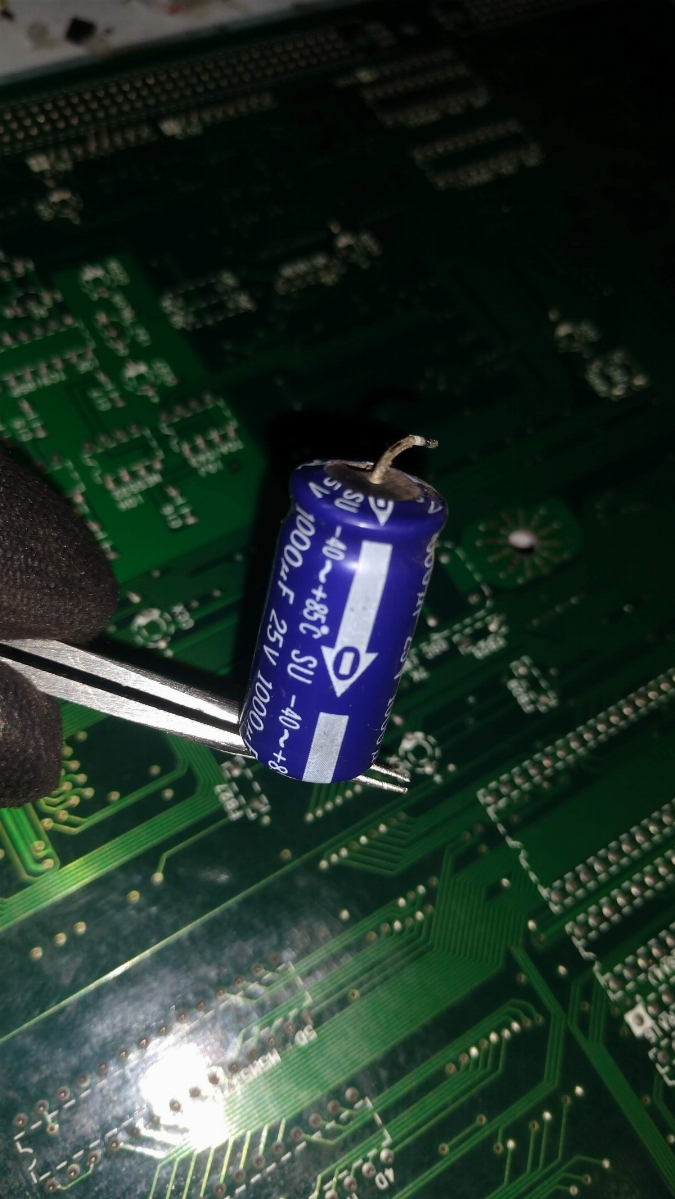

Holy mother of Jesus! I ALWAYS see PCBs that come with batteries installed in place of the SUPERCAP, but I didn't imagine they would reach this point. Until then, I was used to see something like this:
Okay, let's see what can be done.
I removed the initial layer of dirty and dried the liquid that was spread over the board and installed the supercap, which should have been done since the previous "maintenance".

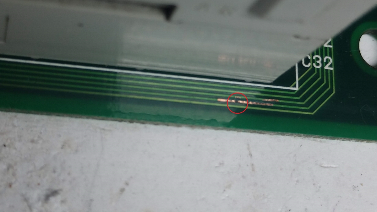

Inspected the PCB again, and there was some strange traces near the CN4 socket and one going towards the 3W LS157 was damaged. When restoring, a few more data lines were appeared on the screen.

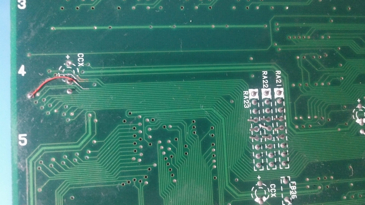

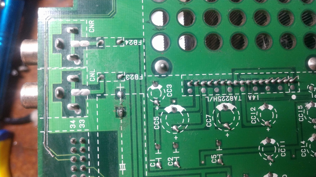

On the solder side, a broken trace was found near a capacitor's pin solder point, and, to prevent a short, I decided to leave a jumper simple jumper (I could leave it straight, but prefer to keep the original trace form).

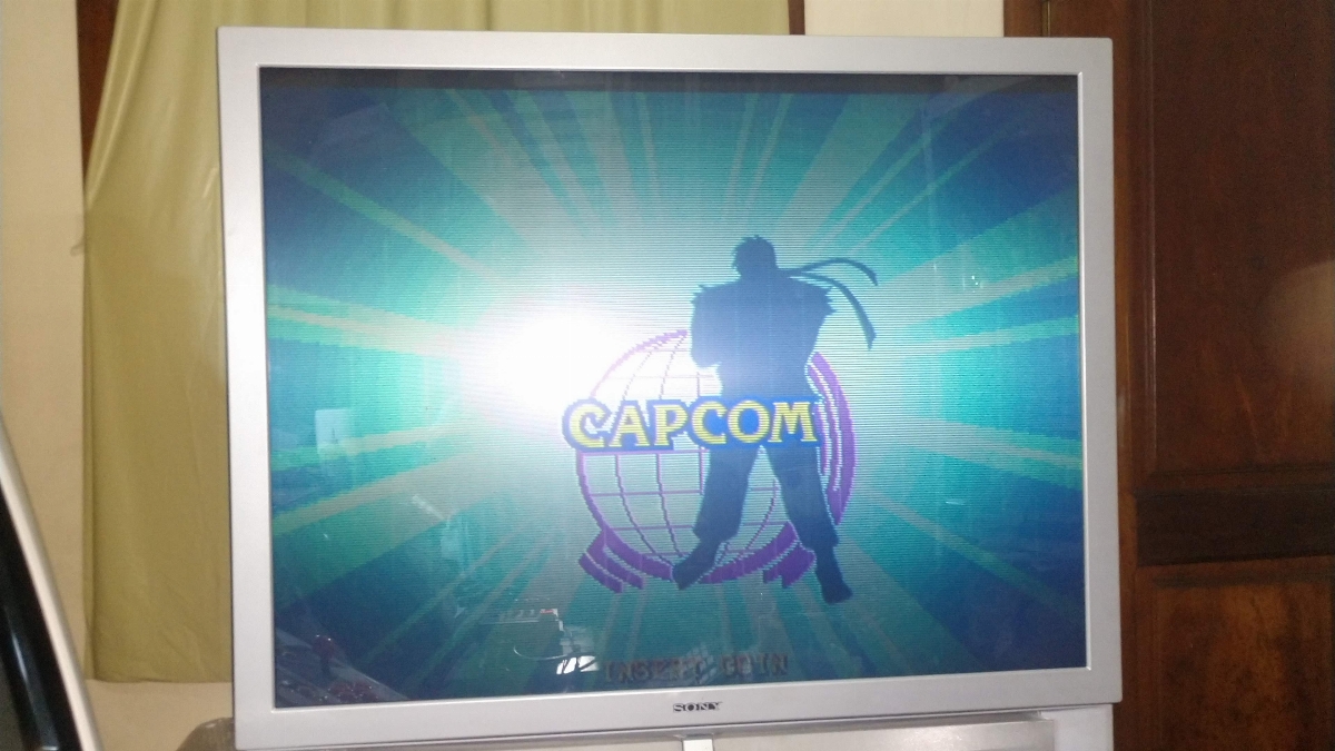

Testing a game (Marvel Super Heroes) it show perfect graphics, now, time for the sound circuit, which was totally non-functional.

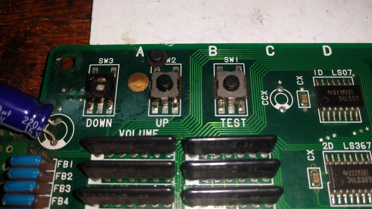

First, volume and test switches, it didn't work. I opened everything, cleaned it, and closed them again, perfect.
The continuity of the switch signal was reaching the kick socket, but not the volume control IC.

Until then, the sound was from JAMMA, in mono, I went to test the stereo, nothing.
By the diagrams, I saw that the sound signal leaves the QSOUND and passes through the 6P F04, goes to another logic IC, until it reaches the 10J TDA 1543, which receives the signal and directs the R and L signals to the LM833, until it reaches the 10E TC9176P, which will send the signal to the amplifier and then to the outputs. I checked the continuity, it was ok.
Then I changed the line ICs one by one, when I arrived at the TDA1543, the stereo sound was magnificent!

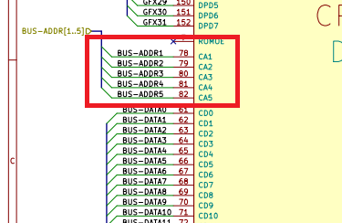

I did not want to replace the DL-0921, as I was “almost sure” that it was not him, since I did some tests with instrumentation on all pins and did not present wrong comparative values, so it could only be some CI still defective or bad traces.
I went back to studying the documentation. There are 5 pins responsible for the management of BUS address, my intuition said that that was it.
In a continuity test between these pins with signals that come out from DL-0921 and go to CN1, I identified that the signal from pin 81 was not reaching the socket pin. Following the trace, I found the culprit.
Repair done.
