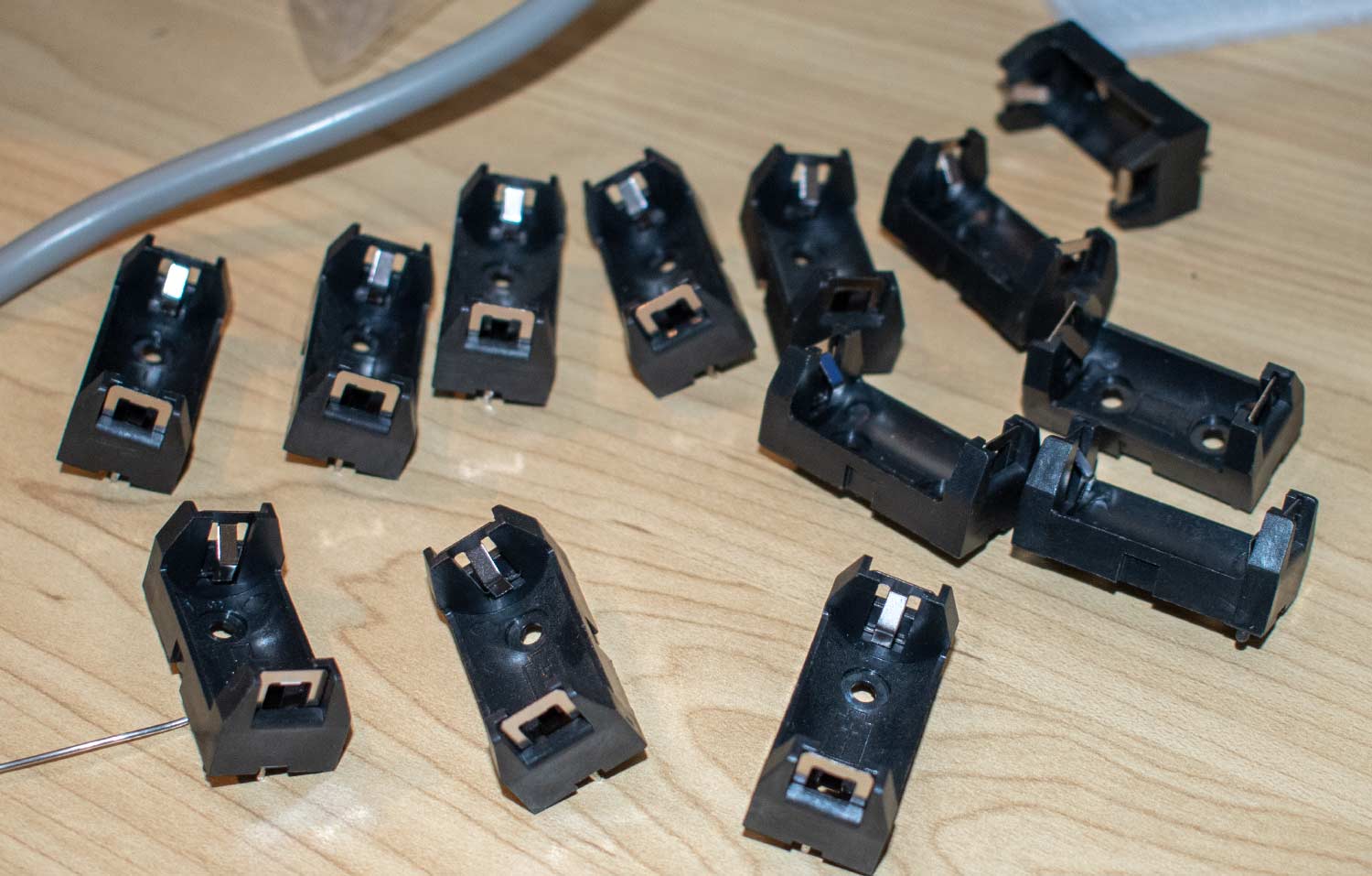

I wanted to install new battery holders for easy future change, and also replace the batteries that were installed with fresh ones.

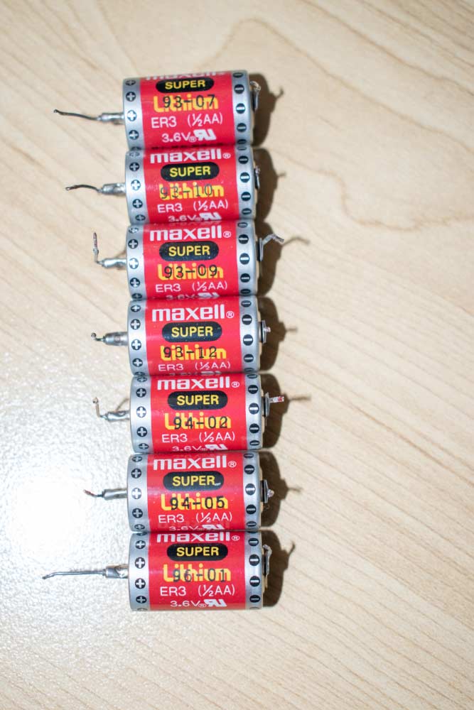

Oddly enough, almost all these boards still had their original batteries dated 1993 - 1994 and 1996. None of them had leaked or suicided. That's 27, 26 and 24 year old batteries still functioning. I don't care to change them for suicide reasons, i'd be happy to just let them run in there until they die and then i can reprogram the keys and replace them, but the leaking battery problem is the real reason to change them for me. I've seen the damage it can do.

I got battery holders

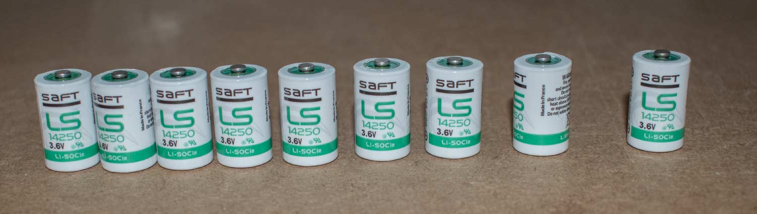

Batteries (04/2019 date codes)

Here's the old original batteries showing the original date codes! Not a single one had shown any signs of leaking.

You may not be aware, but the older original batteries are much better in terms of livelihood due to there being no ban on chemicals back then such as mercury. That's why they've lasted 30 years in some cases. Modern batteries will be lucky to last 5 or 10 years and are just as prone to leaking if left unattended. It's a ticking time bomb really.

I used to use battery sockets also. Problem is your boards are going to suicide long before those batteries die because of the sockets. They suffer the same problem the batteries in your TV remote do. They will oxidize and lose contact. In your remote you just open it and spin the batteries to restore contact. On these pcbs the game will suicide for the same reason. You just won't be able to spin the batteries to fix it
I second this. A number of the boards I’ve had sent in for either key reloading or decrypted ROM installation have had these holders in, and they caused the boards to suicide.

Old post I know but lock those batteries in place if your going to use holders, I've just had my Street Fighter Zero 2 Alpha suicide on me, we moved house recently and today I thought I would shelf all my cps2s they've been boxed up for a couple months it must of got dropped, a battery holder fitted like the guy in the post, battery is fine but it just somehow come out of its socket, board was dead, just thankful i have an Arduino to load the keys back in and resurrect it.
