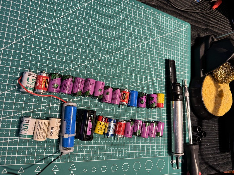

CPS2 Battery Change Day
Busy morning swapping out these.
Did you swap them out for new batteries or running infinity keys etc

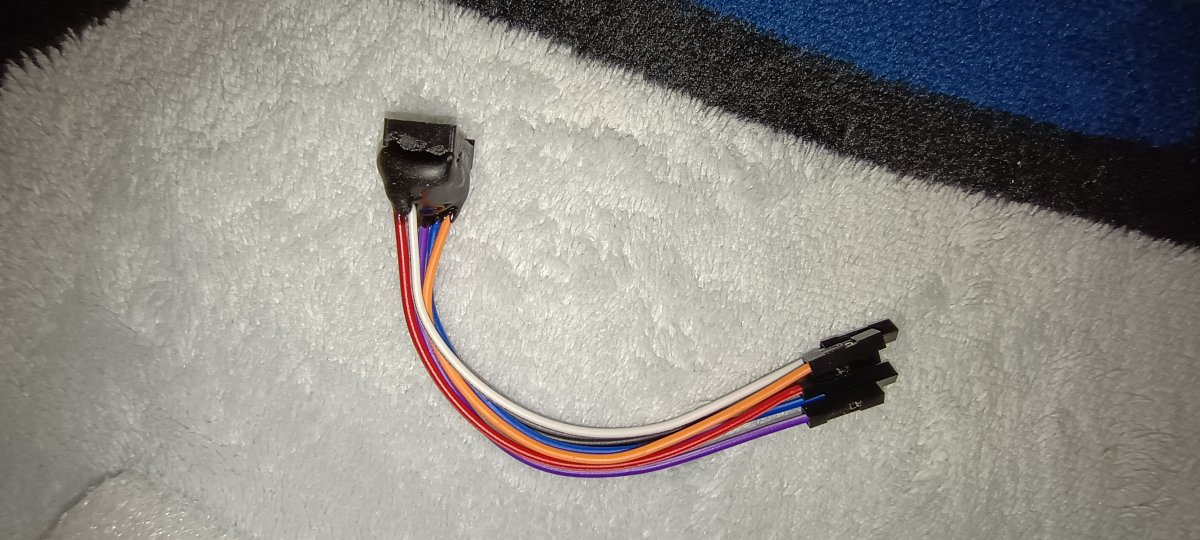

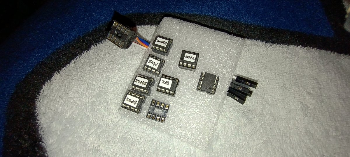

I decided to swap out all the batteries on my boards to 12F675 chips, started programming some, I've made them so I can just plug them into the CN connector using a socket and Dupont cables luckily all my boards have that CN connector, I'm trying to find a 6 pin connector so I can solder a socket directly to a connector, not fan of hardwiring stuff onto these boards, I've seen some right bodge jobs come in.IMG_20240623_103050891_HDR.jpg
