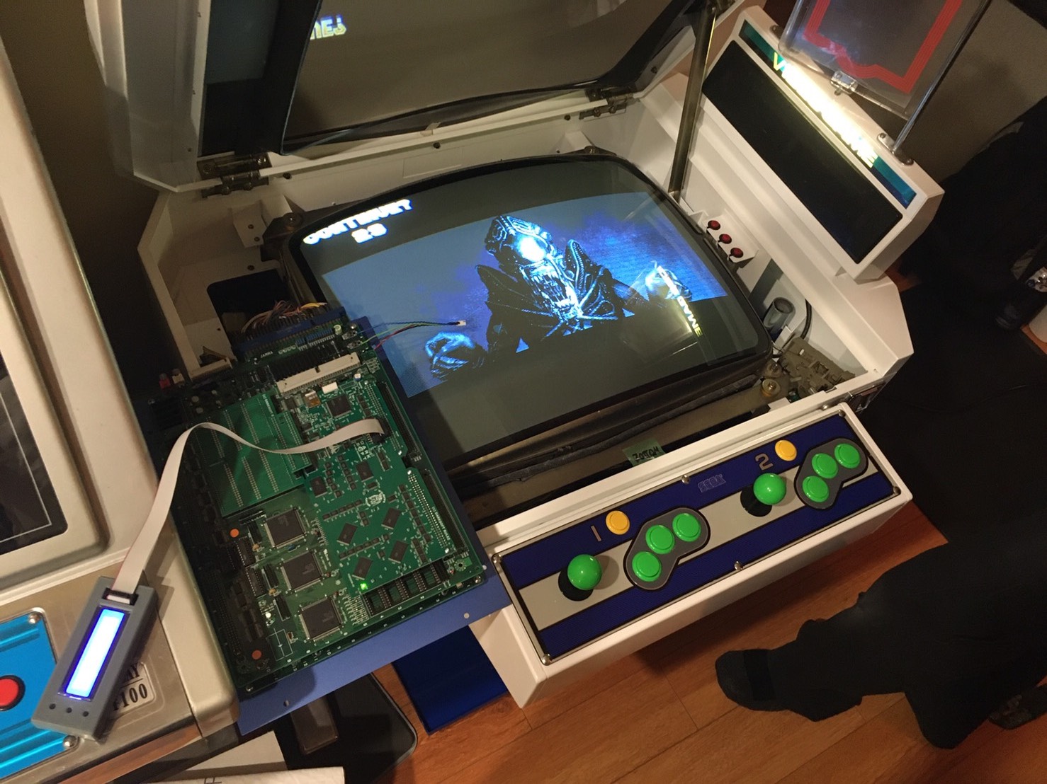

Just got my first (of two) darksoft champion edition kits up and running!
HUGE thank you and respect to @Aurich and Kyle for their help and support with this project and getting it installed.
Thank you to Darksoft and team for continuing to improve on this awesome achievement for the community.
Now it's time to play some games :) <3
