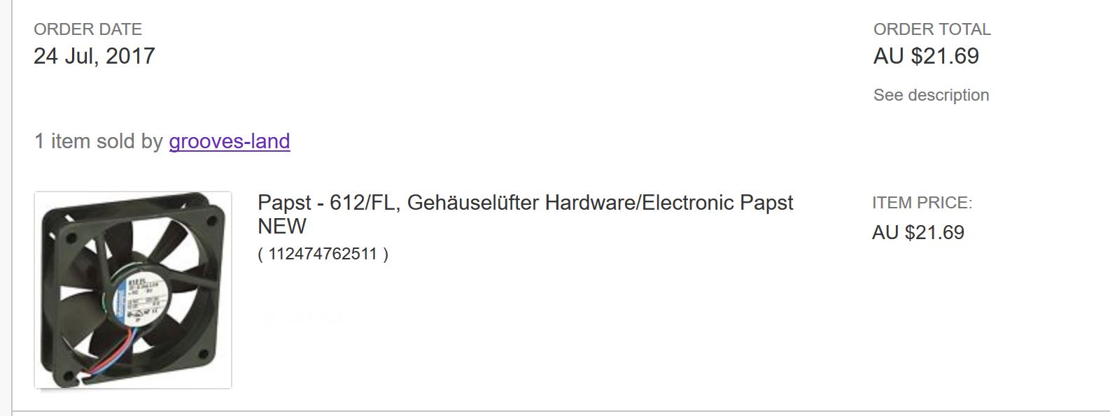

It's weird they aren't there anymore but a few months ago I bought these for $21aus delivered from Germany.
There's one for $24.50 delivered on eBay from Germany, that's not too bad. But nem seems to be happy with the Sunon do it gives people a cheaper option as well - the fan doesn't bother me enough inside the cab to replace it.... Yet

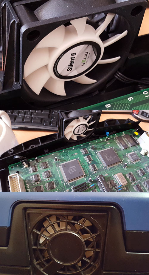

Just want to say a quick thanks to all who advised above on CPS2 fan replacements.
Mine arrived today, so I took the plunge opened up the base board, gave it a decent clean and fitted the new fan.
In the end I went for a 'Gelid Silent 6' - about 7 UKP from Amazon.
Pretty pleased with the result.. my CPS2 has gone from hovercraft on wind-up, to the sound of a quiet desk fan.
The airflow is more gentle than the stock fan, but it's not like we're running this stuff for 16hrs a day, covered in crud and in the heat of a tropical beach bar.
Next up.. B board battery replacement..
