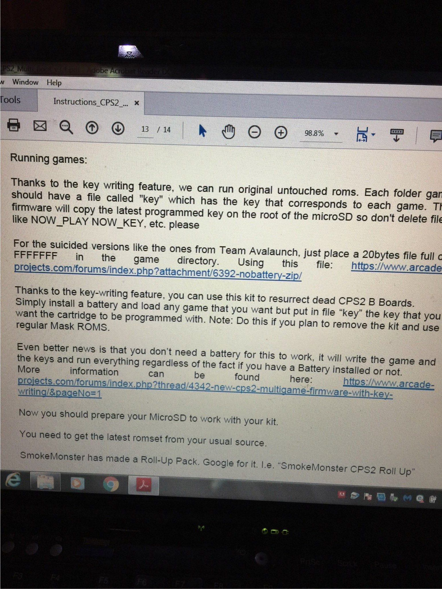

So I’d been doing more digging not sure but appears that I was running an old rom pack so I reloaded sd card with another set of roms and hasn’t reset so at the end of the instructions CPS2 multi boot v3.1 at the end there’s a section saying that I wed to get the latest rom set but how do I know what version o have in my kit so I can match it with right pack of roms and where I can download it

About ROMs... If you have installed the Key writing wires and the latest firmware then you can use the encrypted (current) sets.
But if you lack the reset wires or the firmware (you must have both) you'll need the older decrypted sets.
I do have the key writing wires but not sure what firmware I have is there a way to check so that way I can loaded with correct rom set and where I can download it links some links that I tried are dead
Go ahead and try the encrypted (moderen) pack, if the games actually load you have the correct firmware.
If you do not have the correct firmware, download and perform the firmware update.

so I tried the rom pack it looks like is the same pack I was running so this means that need to performed firmware update so I found in ebay STM32F4DISCOVERY its on its way am trying to prep everything I need to performed this firmware update so I downloaded sd_bootloader file still need to download application STM32 ST-Link Utility ok no problem but the 1 I cant find is the actual firmware update file please help me find this file thanks
