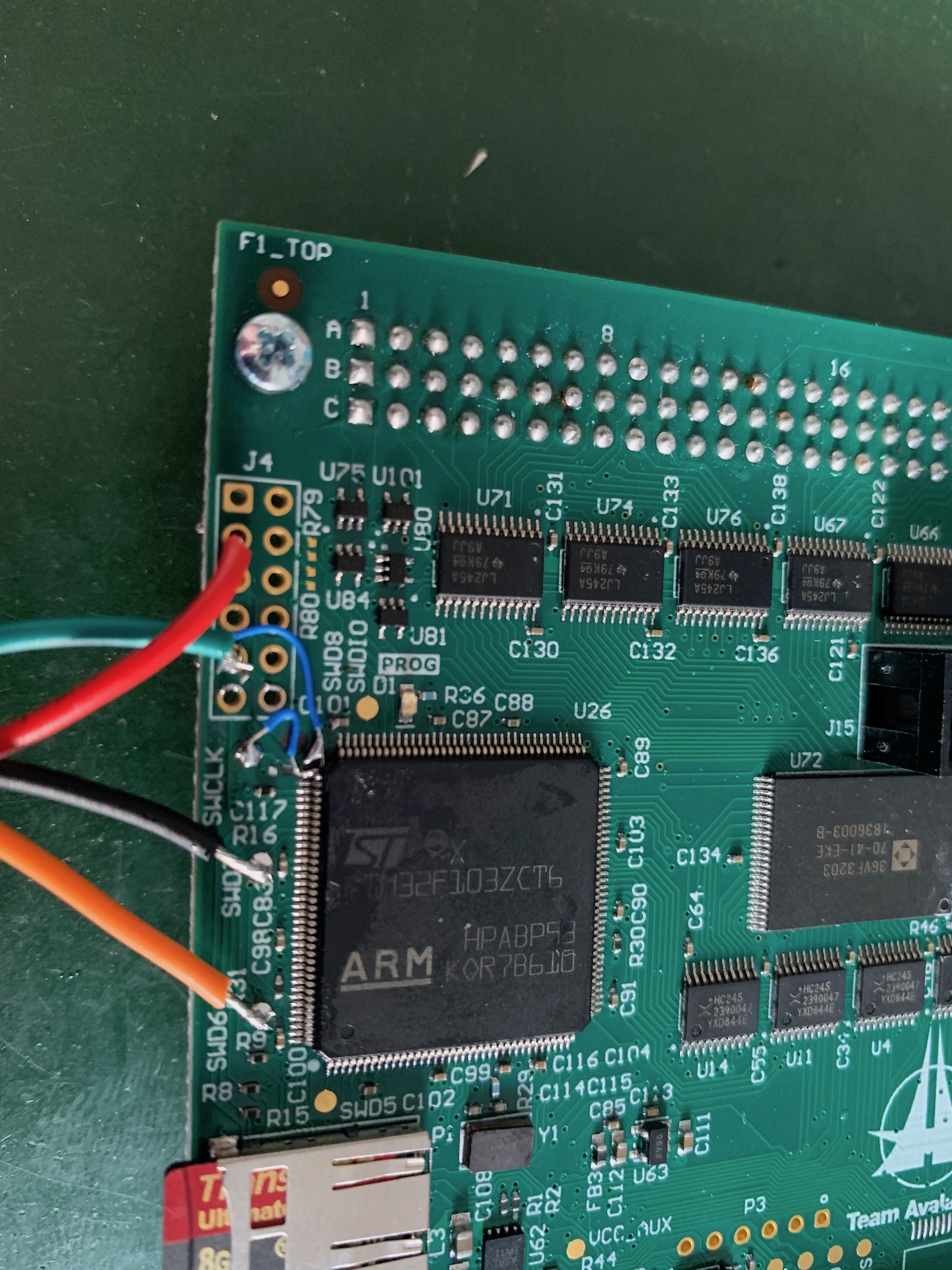

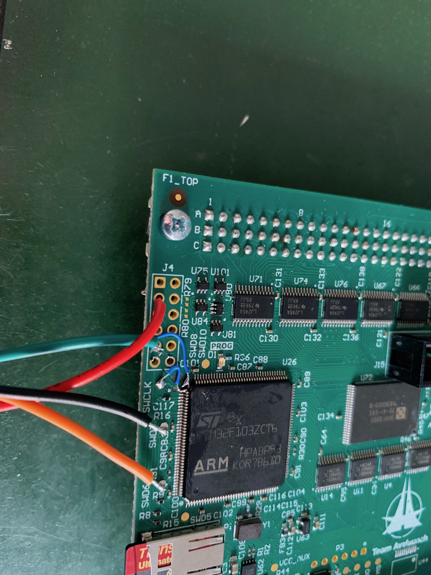

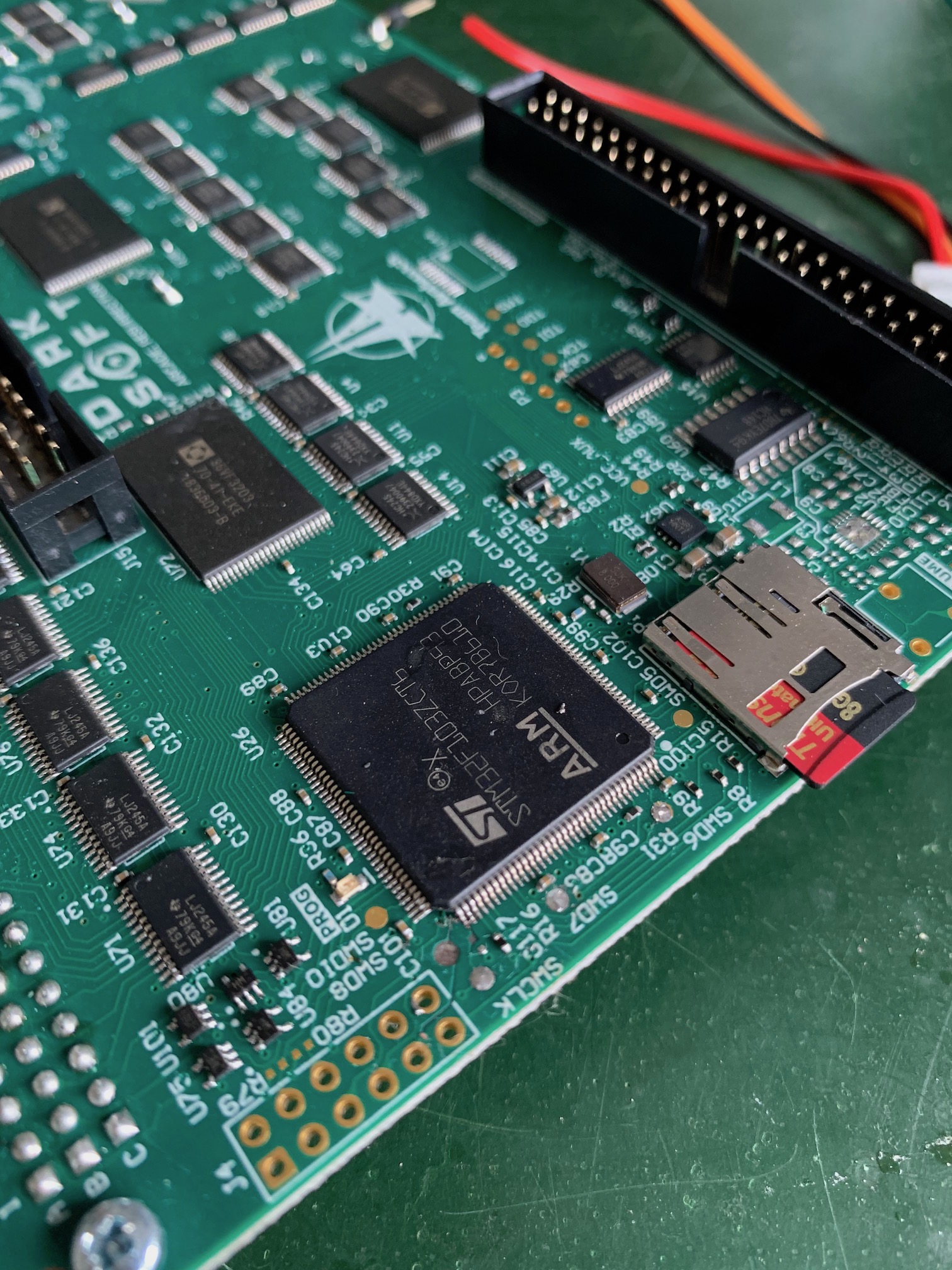

The multi kit arrived in and I opened it to see what the damage is, I had seen photos previously but it definitely appeared worse than I first expected. There is a large ball of solder which has taken out the pad and bridged itself to several pins on the ARM processor. The clock trace has been completely removed from the board.
You can see what's left after the wires have been removed and the bridged pins on the ARM processor. There is also a capacitor missing and a pad for the capacitor has been lifted as well.

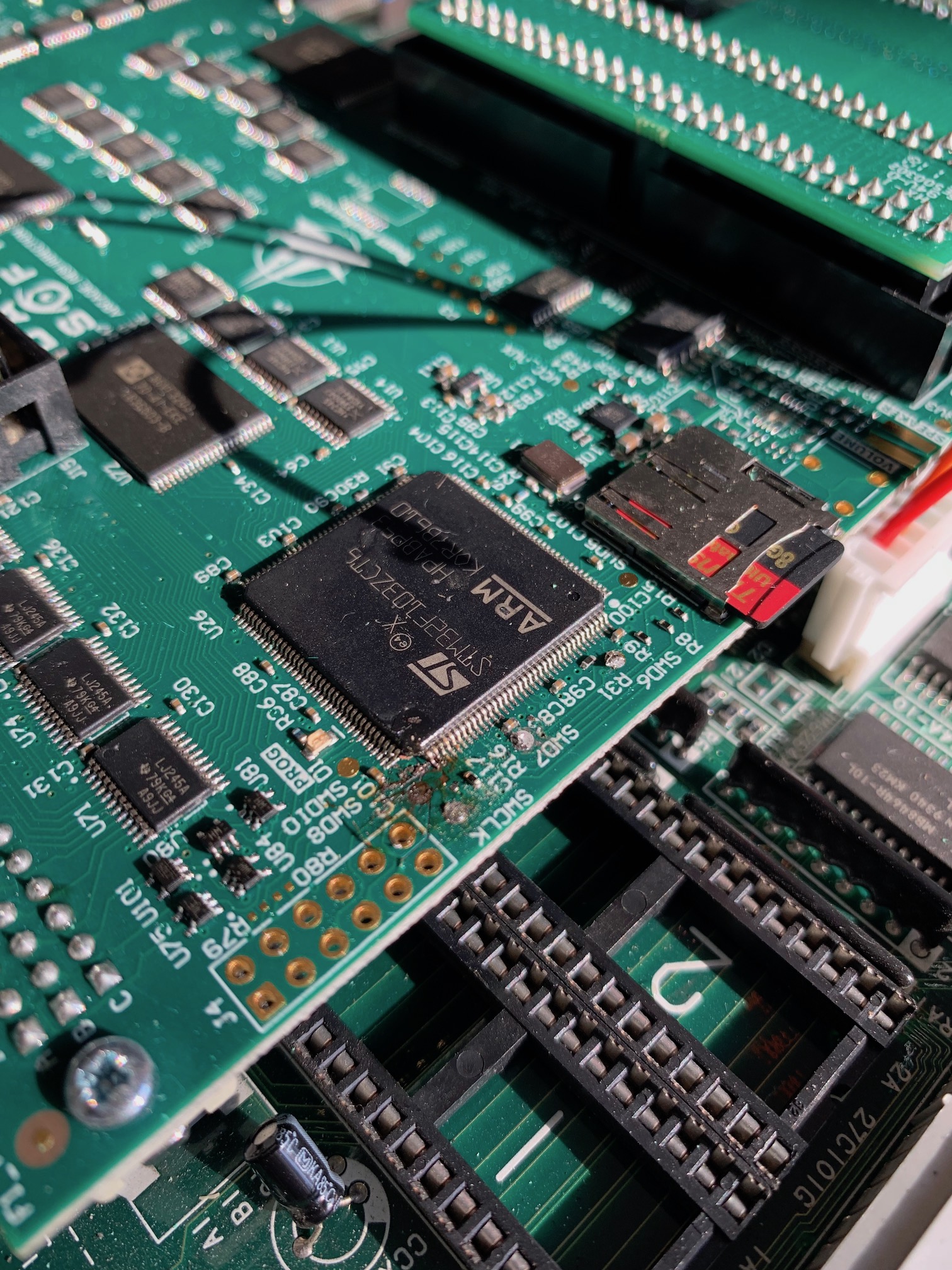

I carefully cleaned up all the solder from the area to see what was underneath
And then used isopropyl alcohol to clean up the burnt flux, burnt solder and other residue in the area so we can see what we are working with
As you can see, the trace for the clock line as well as the pad is completely destroyed. There is a tiny amount of the trace left underneath the ARM processor, which I carefully cleaned up and hoped that I had enough available to attach a jumper wire.

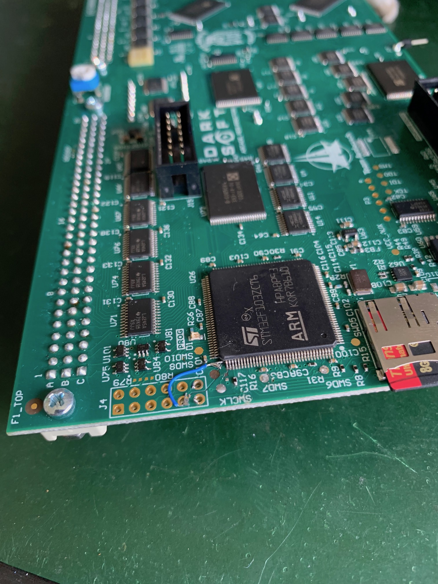

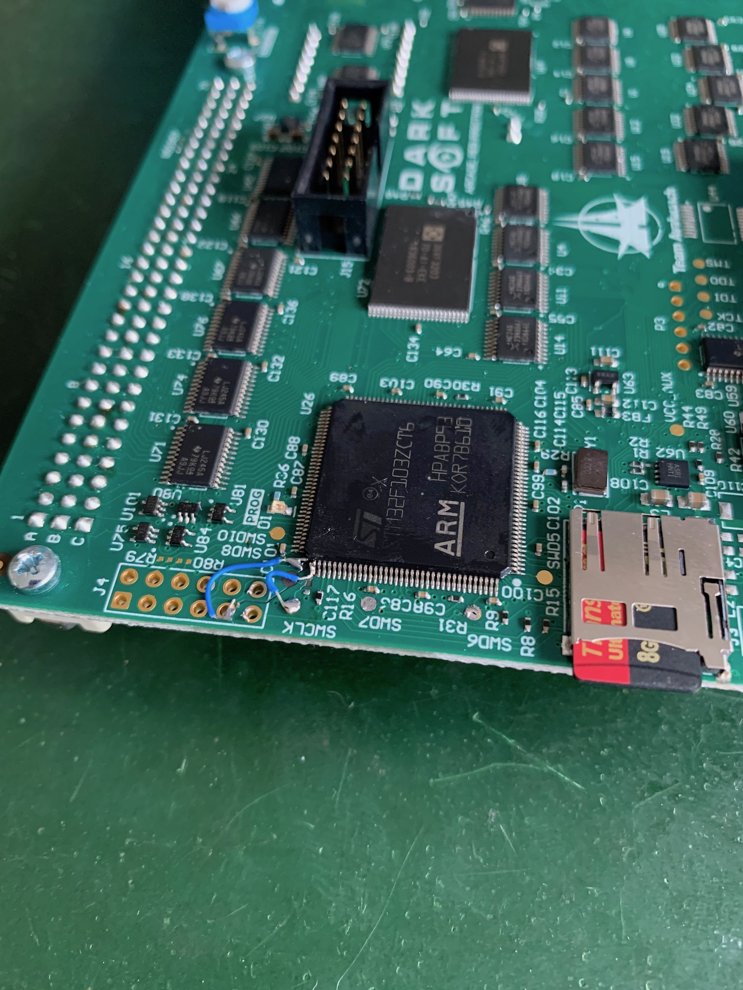

I used the through hole on the JTAG connector that the clock pin normally attaches to, and soldered the jumper wire around the through hole on the top, which will allow me to run a wire through to complete the connection to CN9. There is a large tail on the wire I'm not massively happy about, but it was very difficult to get a connection to this wire at all. As it turned out I had to come back and redo this connection which I will explain later.

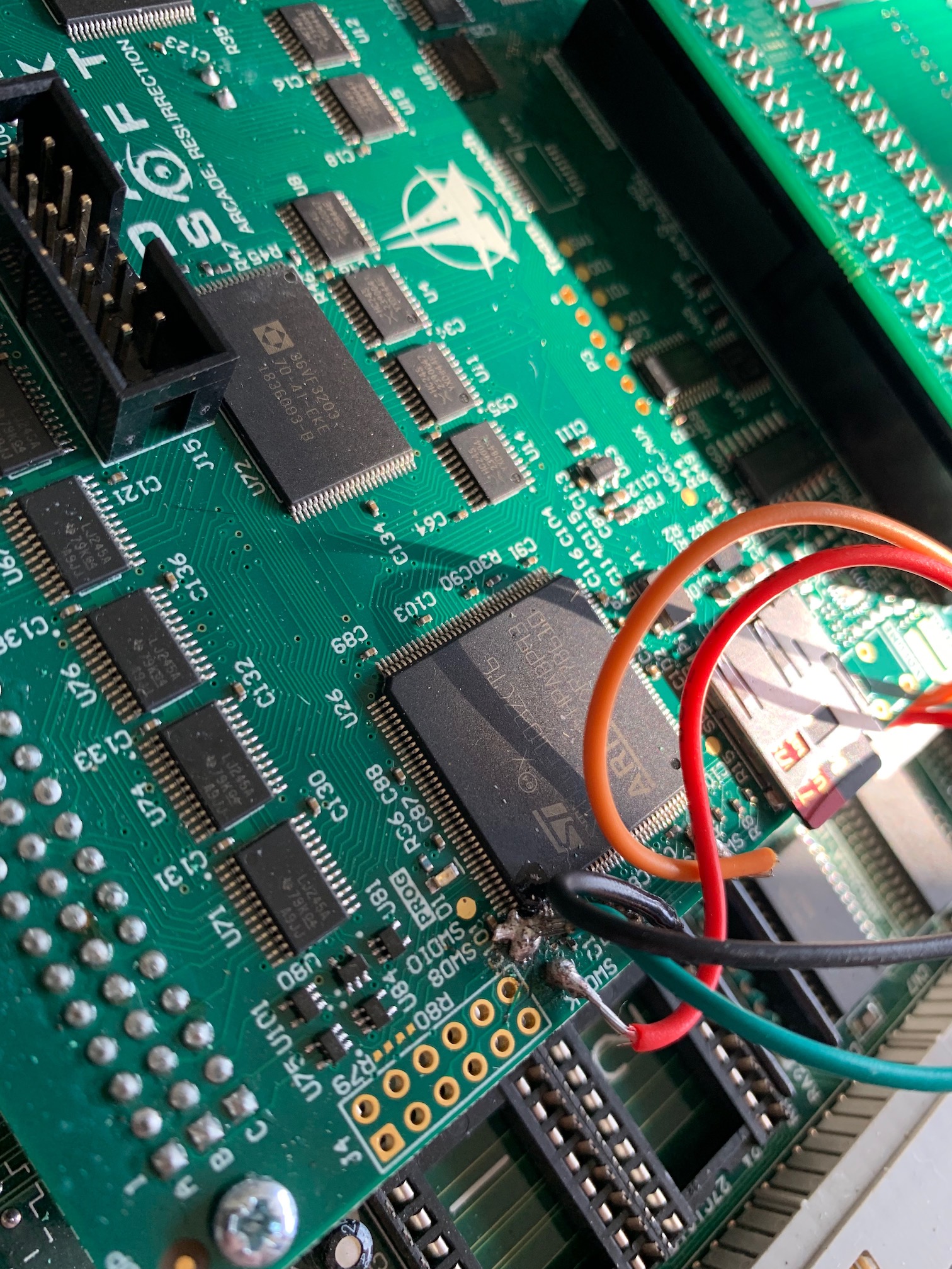

I then ran another jumper wire for the DATA line, as the pad for the capacitor which ran in between the pin and the main pad had been destroyed. As the DATA pad is still ok, the connection to the JTAG connector is intact so I used this through hole again for the DATA connection to CN9. The other 2 pads were also ok, so I cut the original wires and stripped back a smaller amount, tinned and soldered these to their correct pads and the CLOCK/DATA lines into their new through holes.

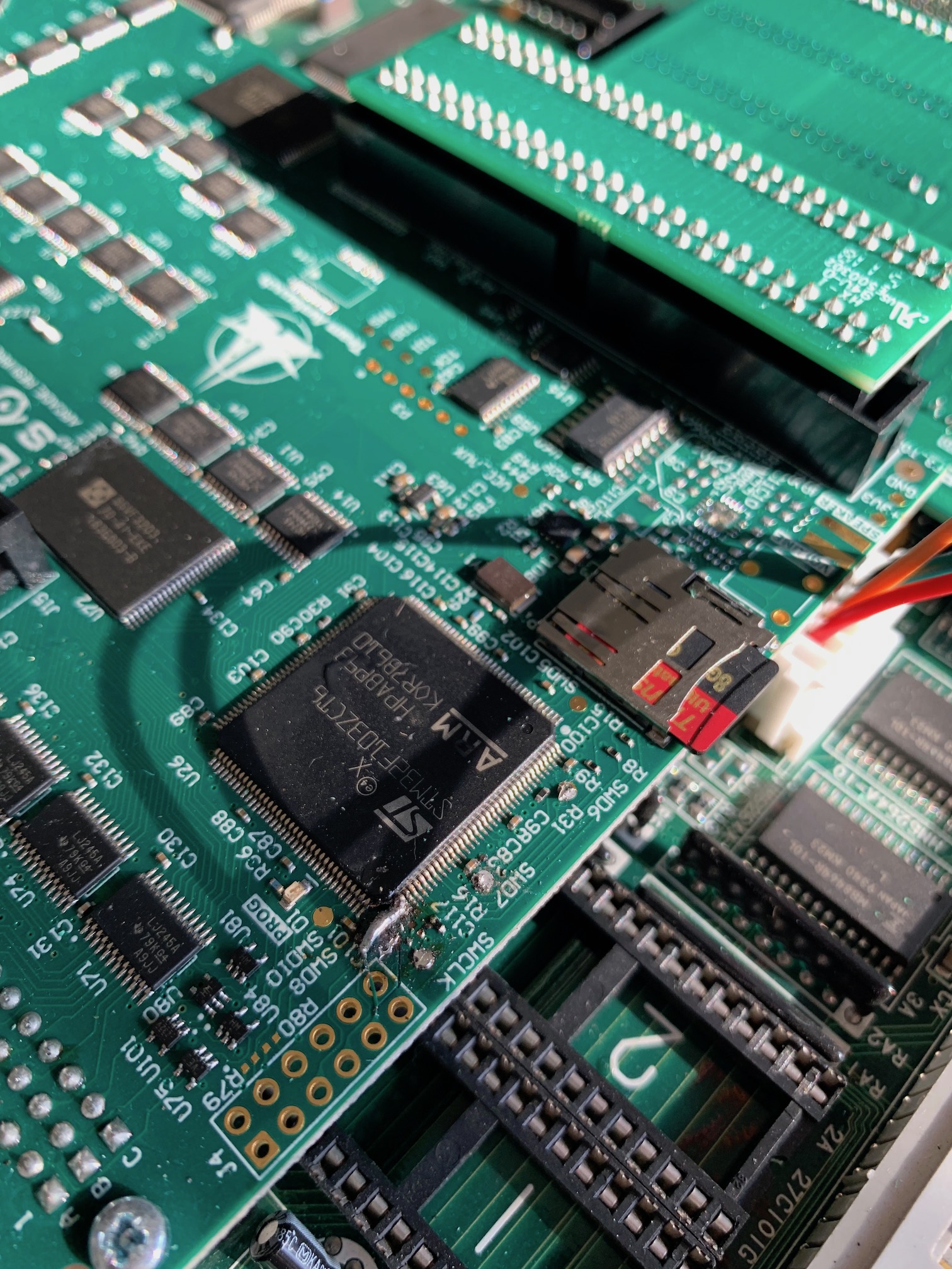

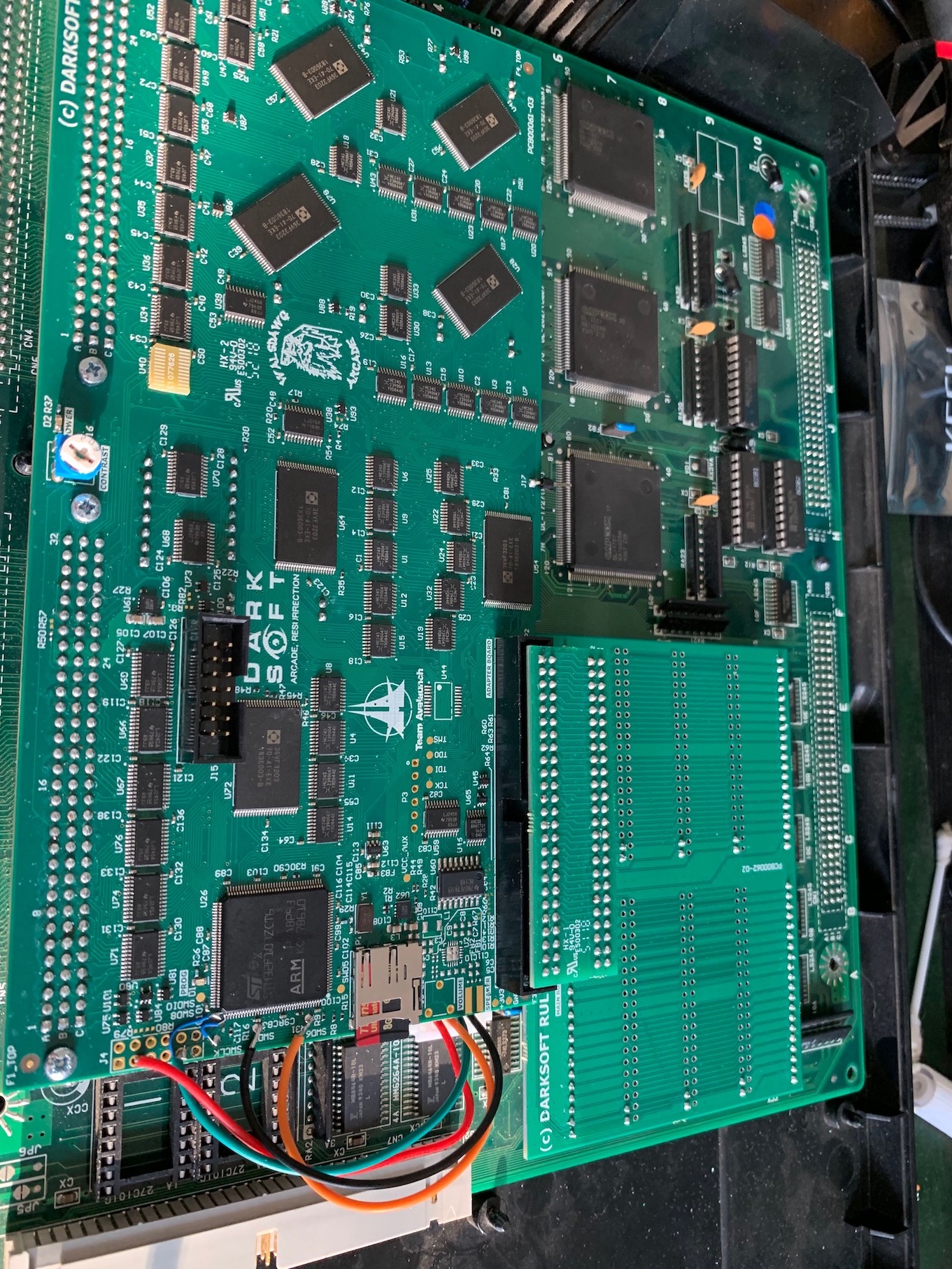

I found after I put the kit back into the case that the CLOCK and DATA lines were making contact. I seperated them but rather than risk it being an issue, I resoldered the connection to make sure that they won't make contact in the future which will prevent the kit from booting up. I don't have a photo of the new connection (I will add this later) but here it is back in the case and you can see the 2 wires are making contact.

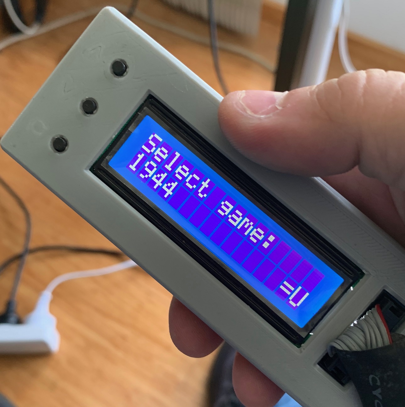

So after initially plugging in the board, it wasn't good news. The multi kit had no life at all, the power LED wasn't lit, nor was the ARM activity LED. The LCD selector screen just showed a bunch of blocks and reseating the multi kit several times did nothing to help the situation. I thought the ARM may have been damaged as a result of the previously bridged pins (if you bridge +5 to GND it's generally game over)
Looking over the ARM again, I noticed a pair of bridged pins. They were in the opposite corner to the DATA pin I previously soldered to, so in a very difficult spot. I managed to clear the bridge, and the board booted Marvel vs Capcom! This must have been what the donor board was as the LCD screen shows 1944 instead (excuse my hand and the messy workbench)

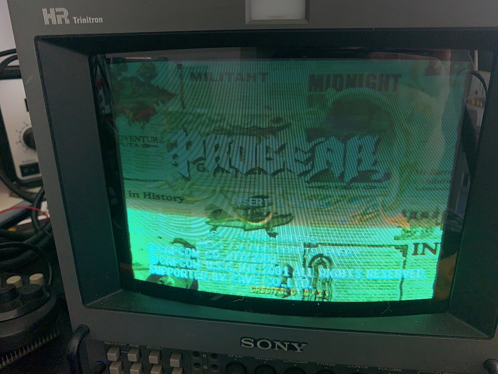

I attempted to load Progear, and got a green screen, suicide. I had lost the connection for CLOCK while cleaning up the bridge. After soldering this again and confirming the connection, I fired it up and it works!
Full key writing functionality has also been retained.
