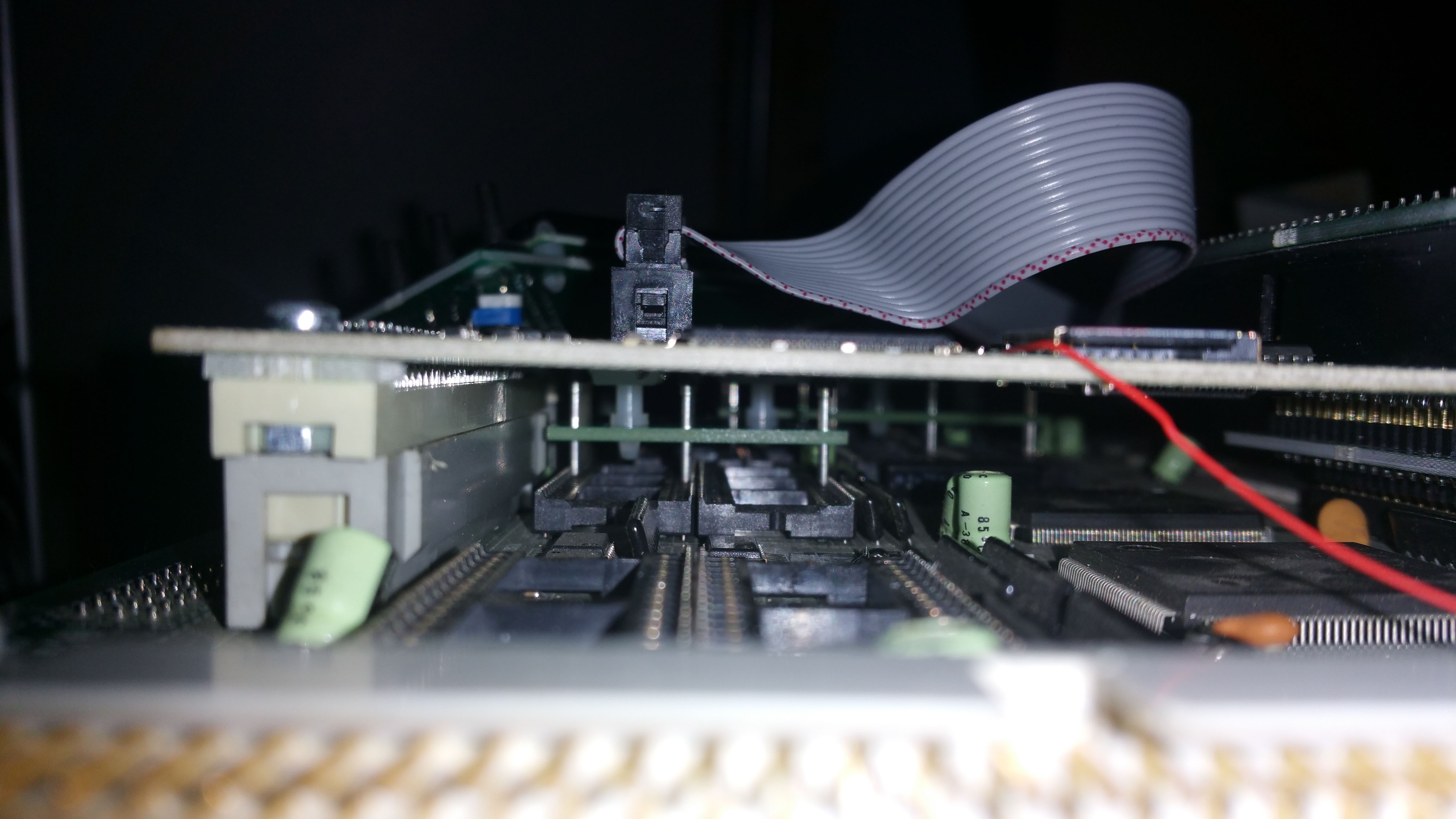

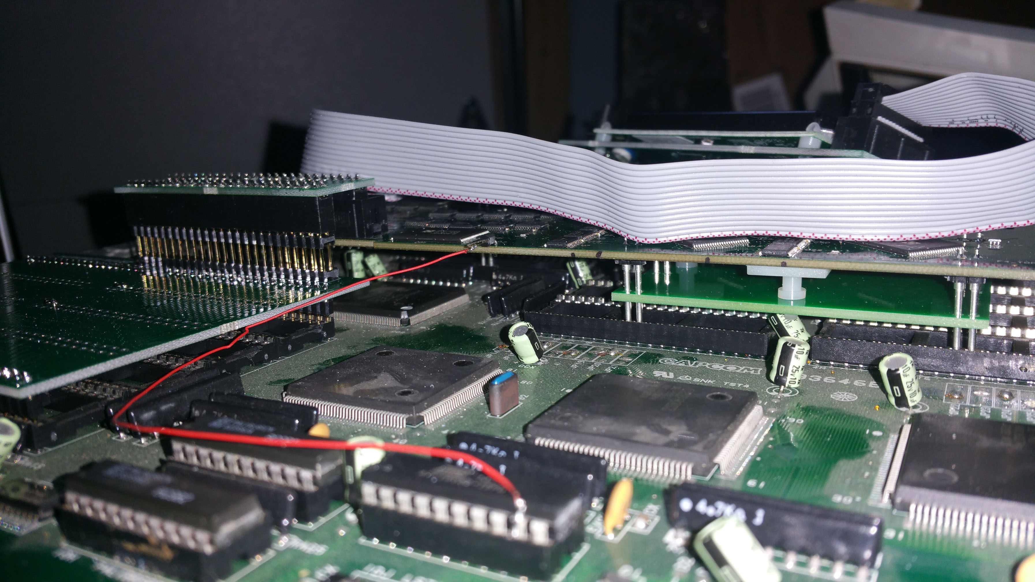

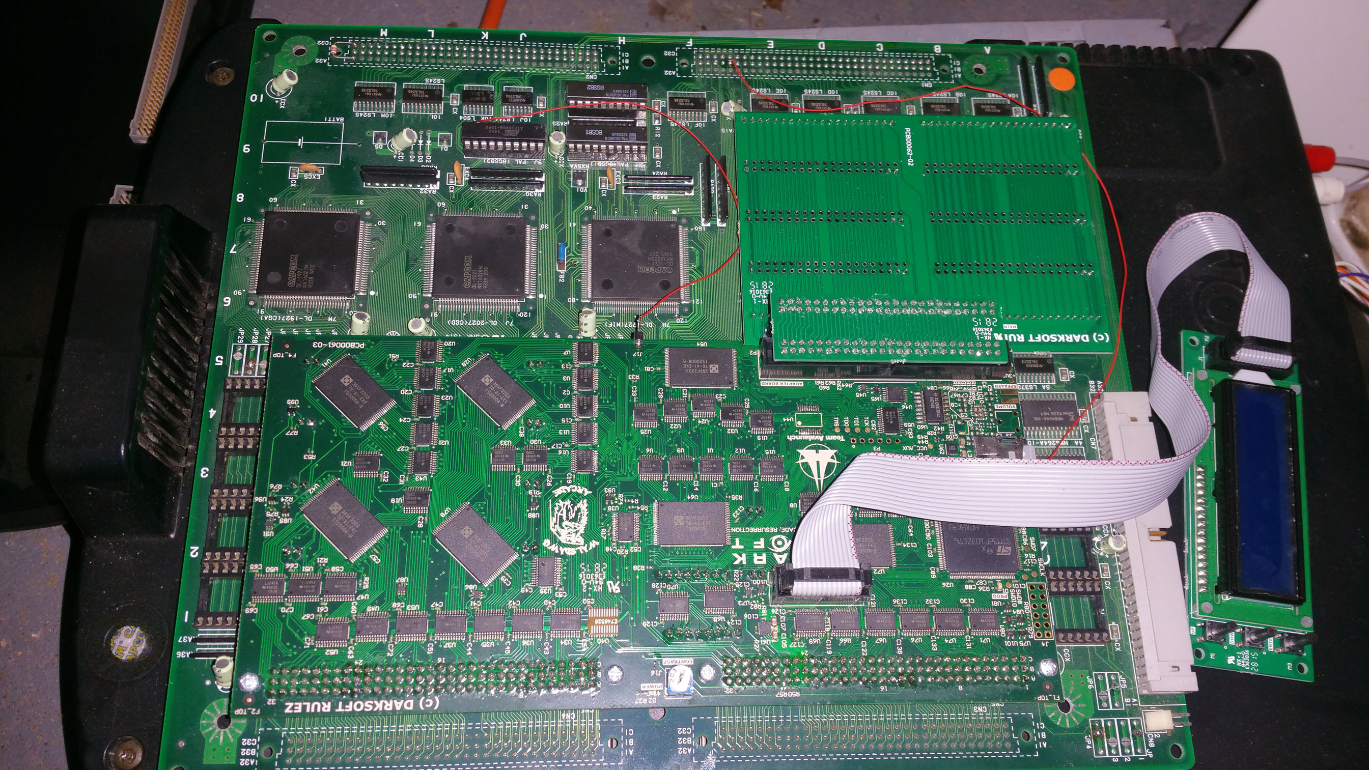

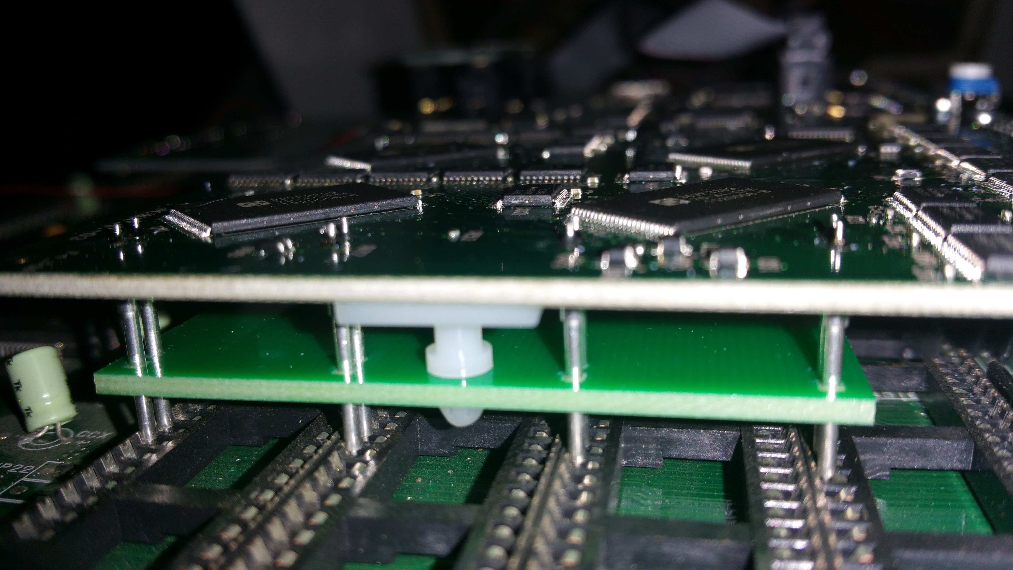

Can you show some pictures of your installation?
Hope these help. Let me know if you need more.

it's difficult to see if there's any hardware or installation issue. In fact near impossible because the multi board covers everything.

First problem I see is that you need to completely remove PAL pin 9 from the socket. It should hang over the side and then have the jumper to the kit pcb like you do. Good chance that will fix your problem.
