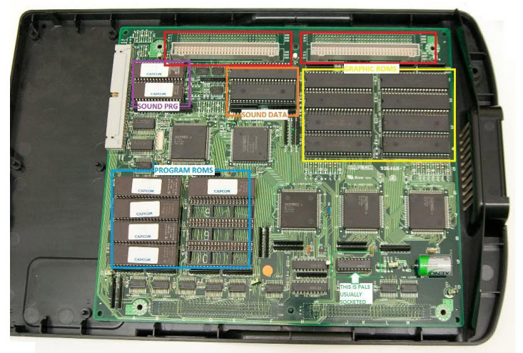

I will be getting my CPS2 multi today and quickly looking at the instructions and my B board it looks like I am missing the connectors on my board that are highlighted in RED in the instructions
See images below

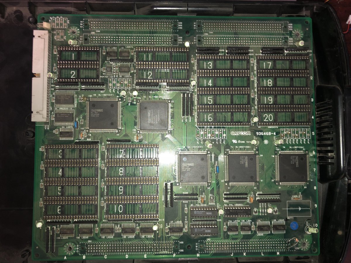

Here is my 93646B-4 board - I appear to be missing the connectors outlined in RED
It looks like the CPS2 multi main board plugs into them

I'm afraid your are. Of course the same signals are available from each individual socket but the multi wasn't designed that way.
Well, you could solder back those two connectors too.

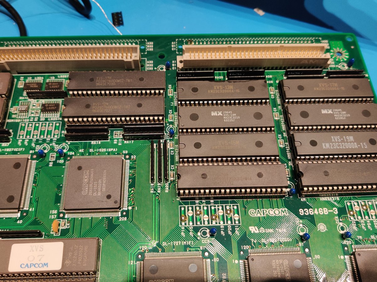

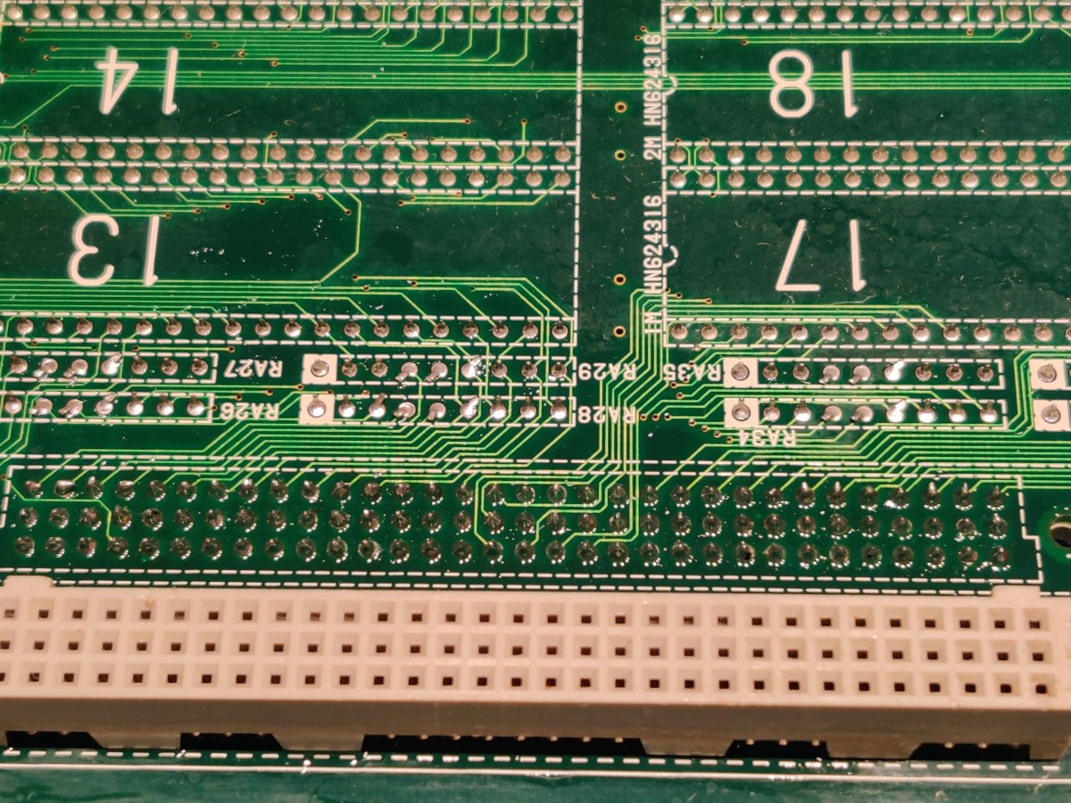

Update: I finally built up the courage to do this. I don't have a lot of experience with soldering but I have worked on some practice kits. Can anyone let me know how I did and critique my work?
