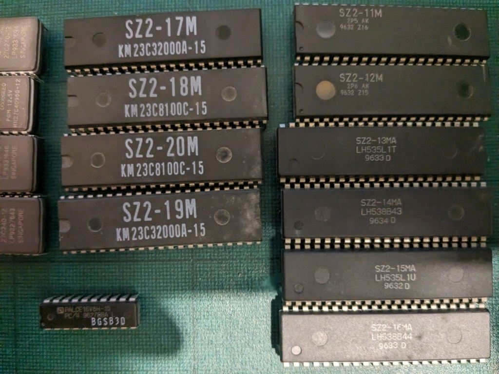

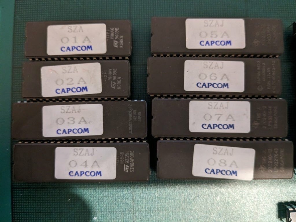

I have this Romset, an official Street Fighter Zero 2 Alpha Japan Version, is it interesting for the community copy it. If yes how to install it on the multi please?
Are you sure this is not in the generator already ?
It has the set:
Street Fighter Zero 2 Alpha (Japan 960805)
Which version is yours ?
