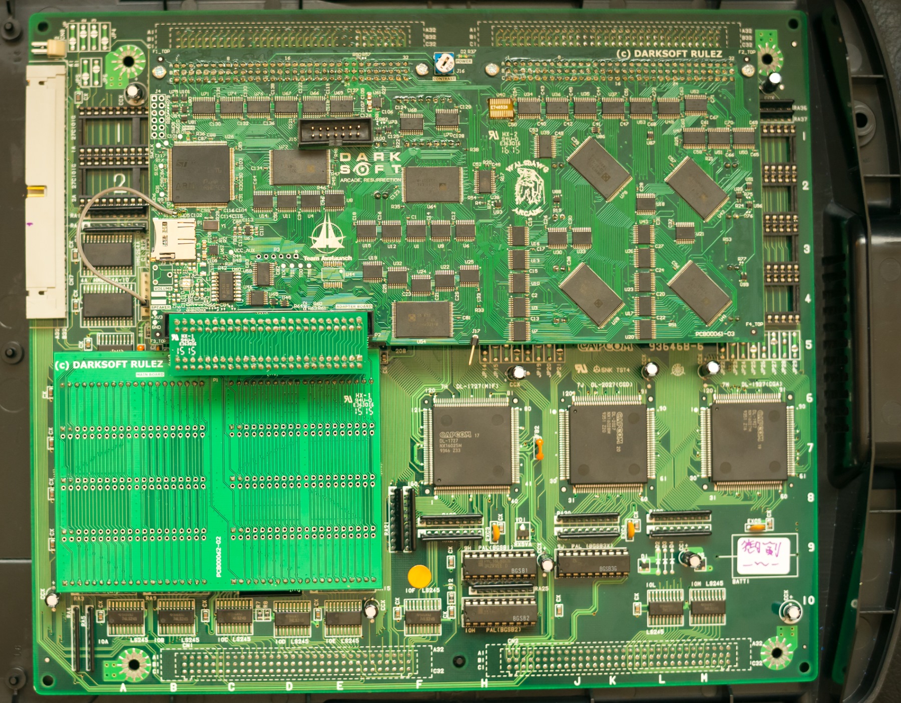

So the sound crackle fix pcbs have arrived. Darksoft has successfully done a few and I have done a few but I am still perfecting the technique. We will send the fix pcb to you if you want to do it yourself. Please take note that it is not a very simple fix for most people. It has given me some problems but I managed to apply them correctly after a few tries. After I do a few more I should be good.
For those of you doing it yourself, I will suggest that after removing the U40 buffer chip that you allow your pcb to cool down before cleaning the pads and adding solder etc. The pads are tiny and the amount of heat used in the removal of the buffer will cause the traces to be very easy to destroy. So let it cool down, apply more solder to the pads with flux, do the same with the fix pcb, then use more flux, line up the fix pcb and use hot air to apply it while pushing down a bit.
If you do it correctly then the sound and gfx will all work perfectly. If not you can have missing sound/errors of bars/lines in the gfx. You can always remove the pcb, add more solder and flux and try again. Just be careful removing the pcb. Give the solder time to melt.
