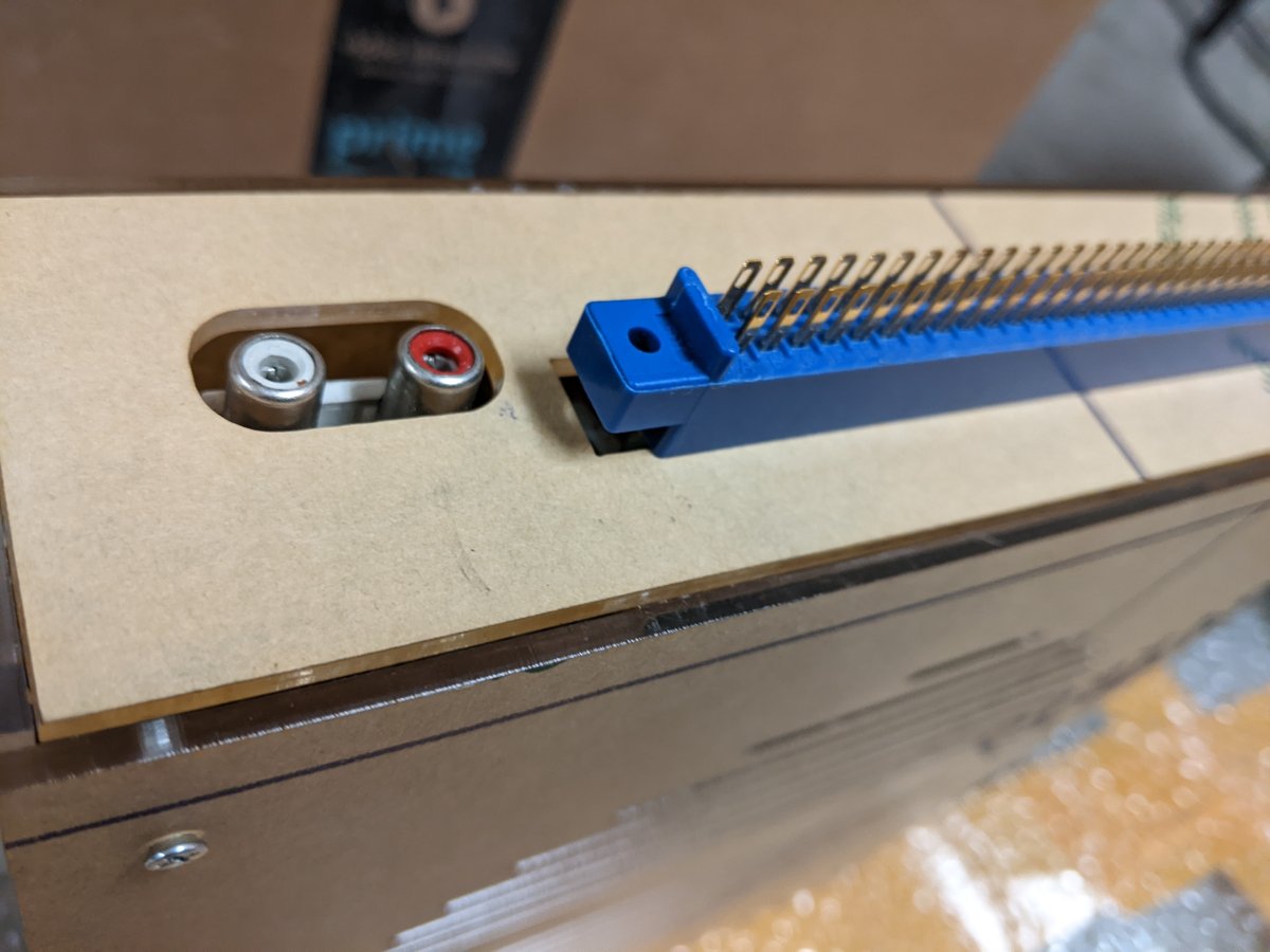

I ended up getting one of the Taobao cases, and... oh boy, strap yourselves in.

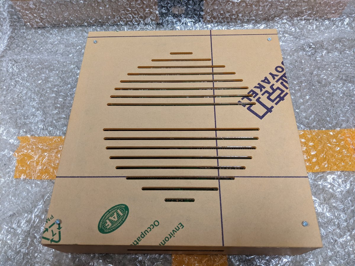

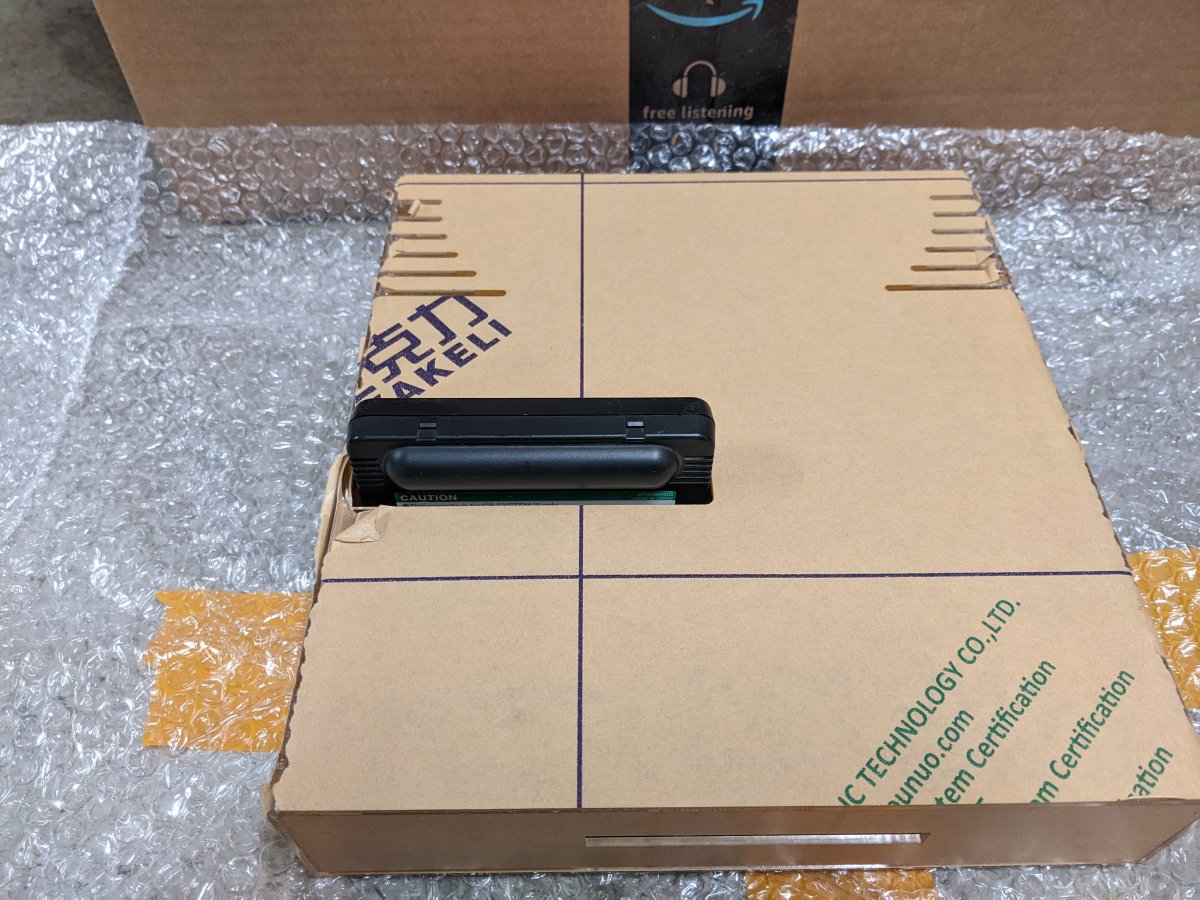

Overall, the construction seems pretty good, the top sides are actually curved and it seems like they put some thought into this, lack of access to the volume pot not withstanding. However, dreams fall apart under closer scrutiny:

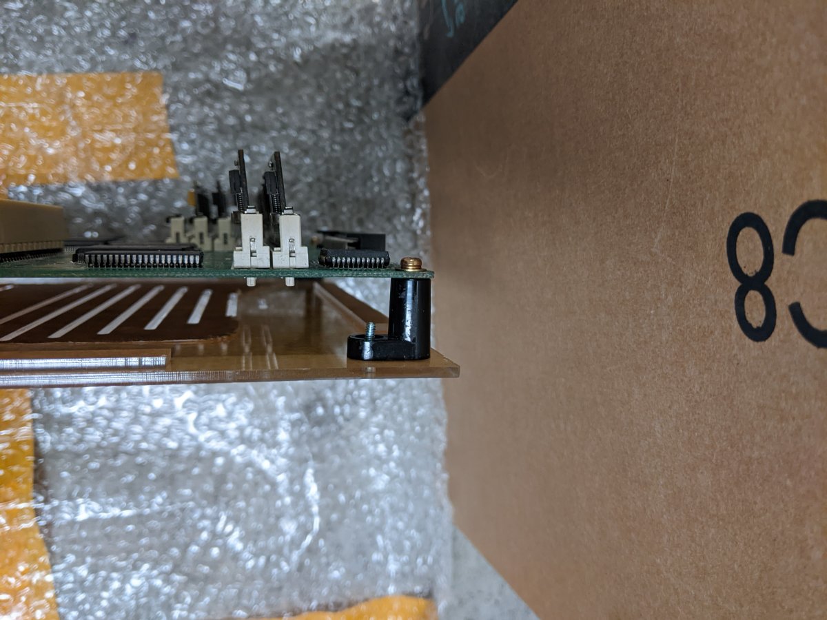

  1. It's not immediately obvious how to mount the board. You can't bolt it to the bottom half of the plexi because the bolt holes don't line up, no mounting hardware is included, and it wouldn't fit through the cutouts in the top of the case this way. It took me a few minutes to realize they may want you to use generic PCB feet, so I tried that.

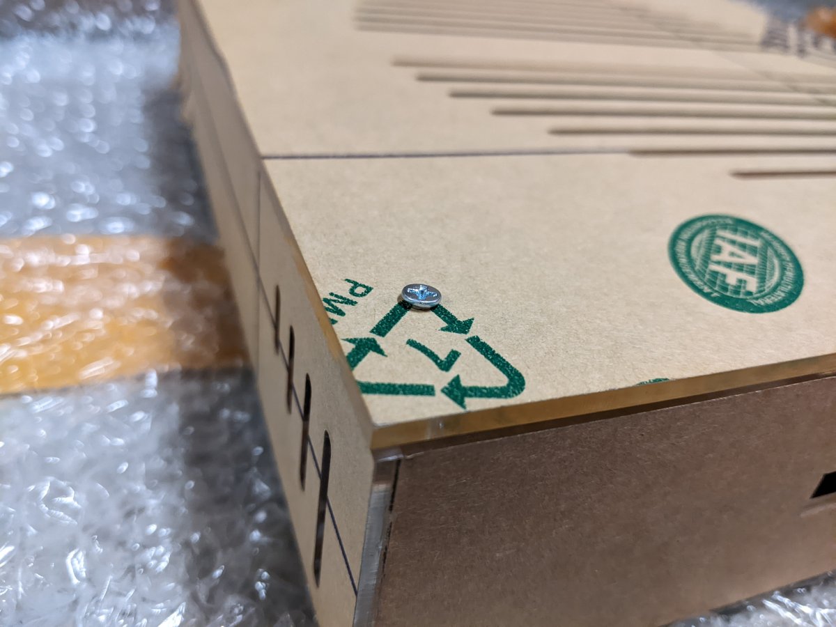

  2. The mounting holes seem to be off by just enough that the bolts won't go in straight. It works, but it looks very imprecise. Since the holes are not countersunk, you either have a bolt head sticking out, or unsightly/uneven countersunk heads if you used what you had laying around like me. ;)
  3. It looks like the cutouts are misaligned enough that some JAMMA connectors (like Hirose) can't seat all the way up against the board. I tried a JST edge connector and that also had an issue. It still works like this, but it's not ideal in my view.
  4. The board flexes like crazy when you put in a cart. I might try to add some center supports.

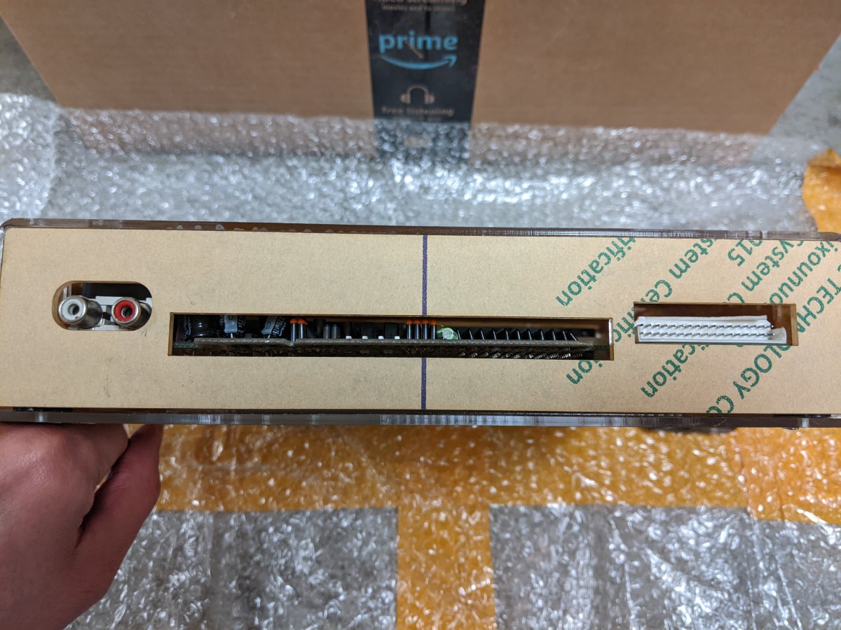

  5. The SCSI and Molex connectors are completely offset from the cutout to the point where they are unusuable. The case is basically useless in this state.
I don't know if I just got unlucky and received a dud, but I spent... way too much for this, and I don't really want to bother my friend to argue with the seller, so I am probably going to try to get this reworked at a local shop or sell it to recoup my loss. If anyone has any ideas on something I may have missed or something else I should try, let me know.

Update: Did some measuring and I am pretty sure what happened with the SCSI & Molex side is that they put that piece of acrylic on backwards. :thumbdown: I tested this theory by removing the case and aligning it such that the acrylic would face the "correct" orentiation, and sure enough...
I'd just fix this myself, but I'm gonna guess the adhesive isn't easy to remove without the rights tools and experience, so going to take this to a local shop and let them deal with it. Maybe even counter sink the screw holes. I'm also going to ask my friend to talk to the Taobao seller and see what happened.
