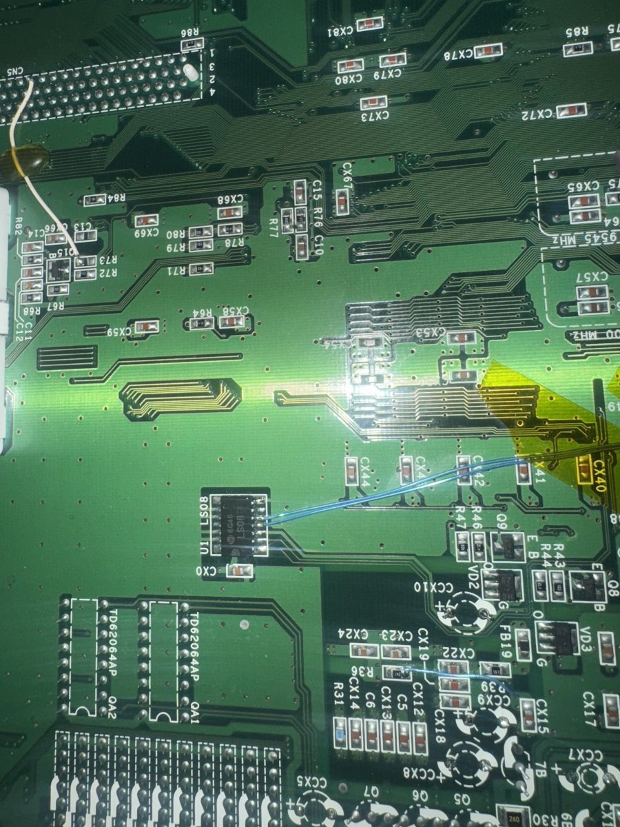

I'm installing a cps3 digiAV and i have a later model board with the LS08 integrated not a breakout board like in the github with the IN1/IN2 pads for HS/VS.
Marqs mentions the integrated version but I don't see where the HS/VS should connect on my board. My board is a 95682A-3, any advice much appreciated.
This is my LS08 and from the GitHub picture it looked like IN1 was traced to the pin I have the lower blue wire soldered to (HS) and IN2 was traced to the upper blue wire I have soldered to (VS). But that’s me zooming in on the pic and trying to follow traces I can’t quite see. With this wiring I’m getting a total black screen but my OSD works perfect and is crystal clear. Jamma audio and video are perfect.
Loop closed, found it here.

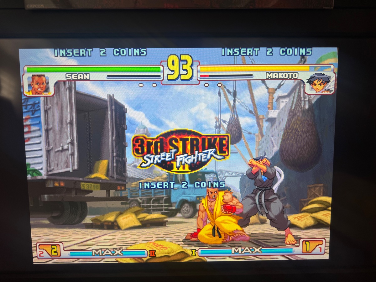

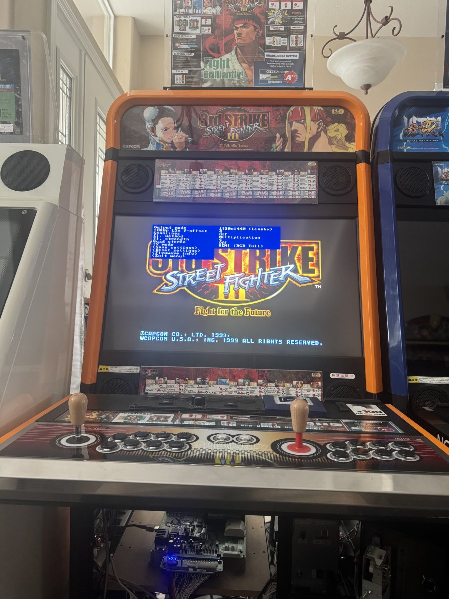

I just did a full console5 cap kit and reflowed everything the day before I put the digiAV in. Ran coax on both c1 and c2, v1.3 qsb…the colors couldn’t pop more with sharper pixels.
