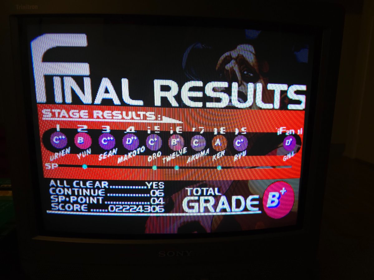

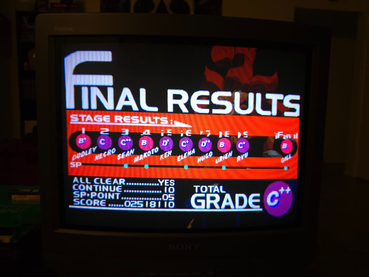

New first time cps3 owner here! Bought this darksoft modded board from an ebay listing in France, and was over the moon when everything arrived fully functioning!
After I've played through the ar ade ladder a few times just messing around, I found some slight irregular graphical issues. On the post round stats screen for 3rd strike, of your meter goes into the red for any of the categories, it only has one pixel pf red instead of filling the bar.
And then the post arcade run stats screen the stage numbers become garbled as it goes on.
Any ideas/support? I've ensured all of the simms are seated correctly. This is a no cd darksoft setup, so when I do the simm check, it shows simms 1&2 as NG. Is this normal?

Outside of re-flashing your SIMMS with a CD SuperBIOS/UltraBIOS cart & seeing if that clears it up, my guess is one of two:
  • One or more of your SIMM edges might be dirty & not making good contact. I would take the SIMMS out & clean the contacts on both sides of each of them with high-grade rubbing alcohol or some type of proper electronics cleaner (Deoxit).
  • One of your 128 MB SIMMS might have a loose flash chip that needs to be reflowed.
To me, I highly doubt the board is dying as it looks like the affected data isn’t spreading to background layers, etc as you’re running your setup.

Thank you for the reassurance!
I apologize if this is documented or explained elsewhere, but what would I need to do to be able to reflash the Simms? I have a no-cd darksoft cart. Would i just need a scsi to sd adapter? Or would i need a new cart with a different bios?
Update to this thread:
The wonderful owner of Akihabara Arcade and Bar here in Westminster CO was generous enough to let me use his CPS3 cart (superbios) and cd drive to reflash my board.
All graphical issues gone, and shes back to 100%
A huge thank you to GoldenGlover for the tip, and the owner of akihabara for his generosity and patience!!!
