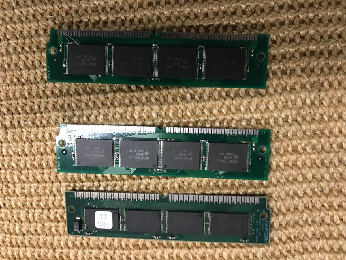

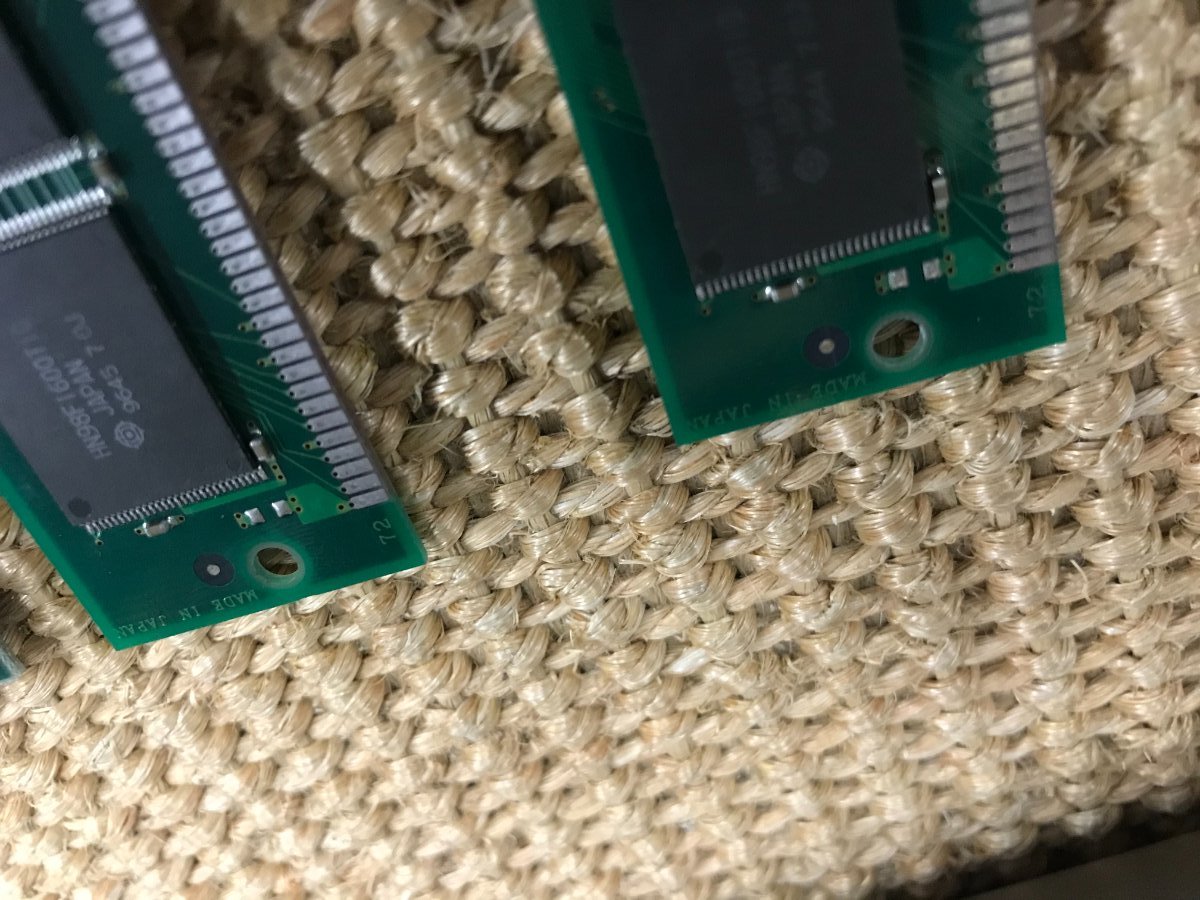

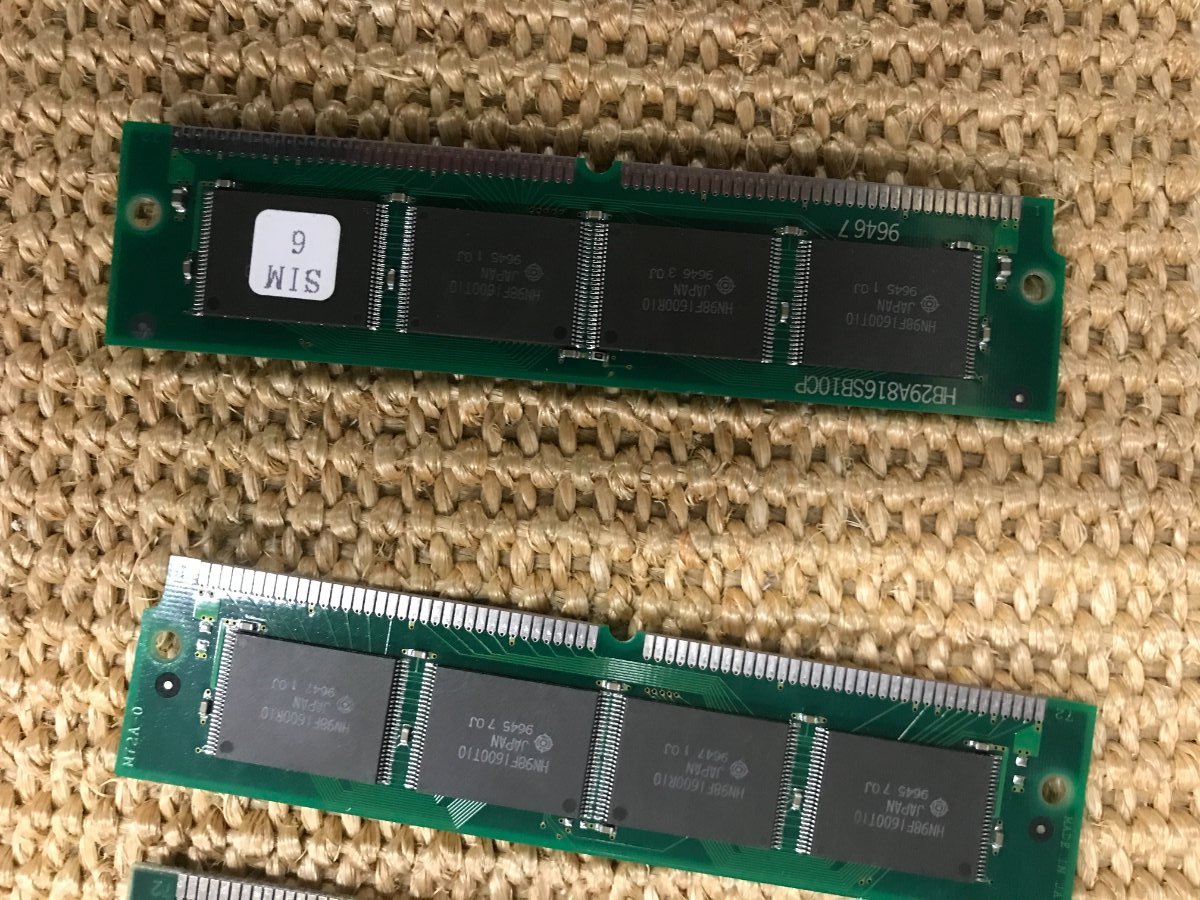

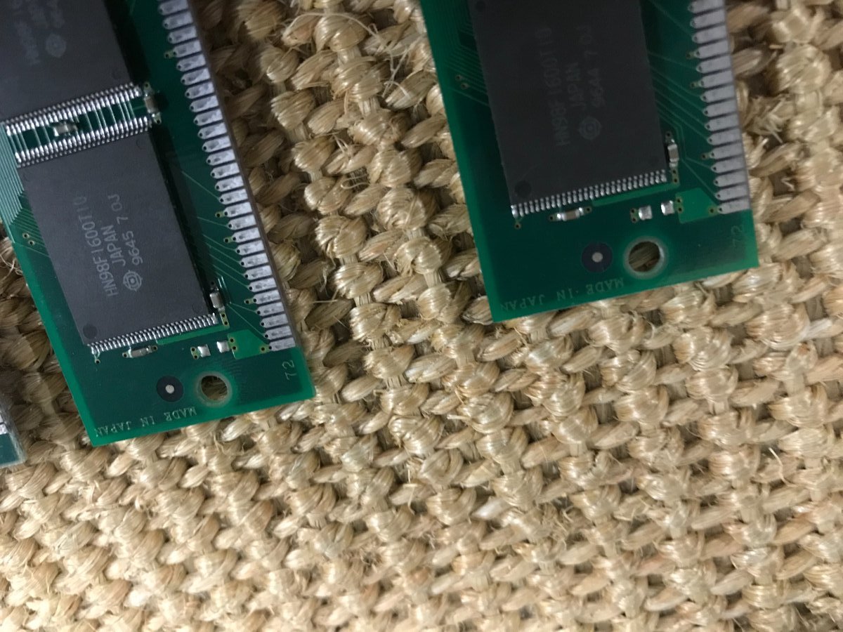

Hi,
There's 2 kind of simm(all were 128M)Some simm without the logo "capcom" but have the words"made in Japan". Is that means the simm also belongs to capcom(original) or just convert simm.My friend who sold the simm to me said that it also belongs to Capcom. Now several people told me that any simm without capcom logo are conversion.
Thx

They are Intel branded SIMMS and are authentic; Capcom also used these along with their named SIMMS (Fujitsu).
I’ve even seen some Capcom issued SIMMS without the “Capcom” print on one side; they did a lot of unusual hardware revisions.
