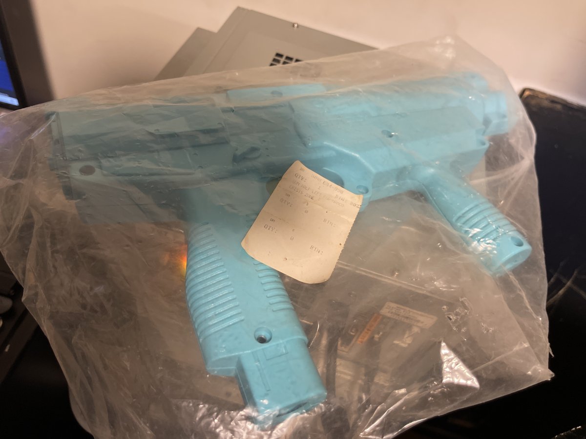

I just saw the video and I am very happy that everything turned out pretty well! I actually did find 2 brand new old stock Crisis Zone gun shells almost a year ago for dirt cheap. I unfortunately sold one earlier this year as I needed to fund another project, however, I still have the other one in pristine condition! It’s still in its bag.

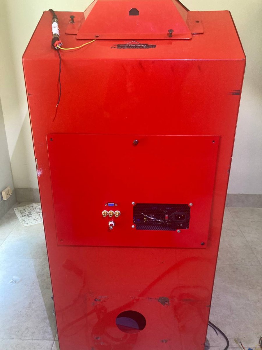

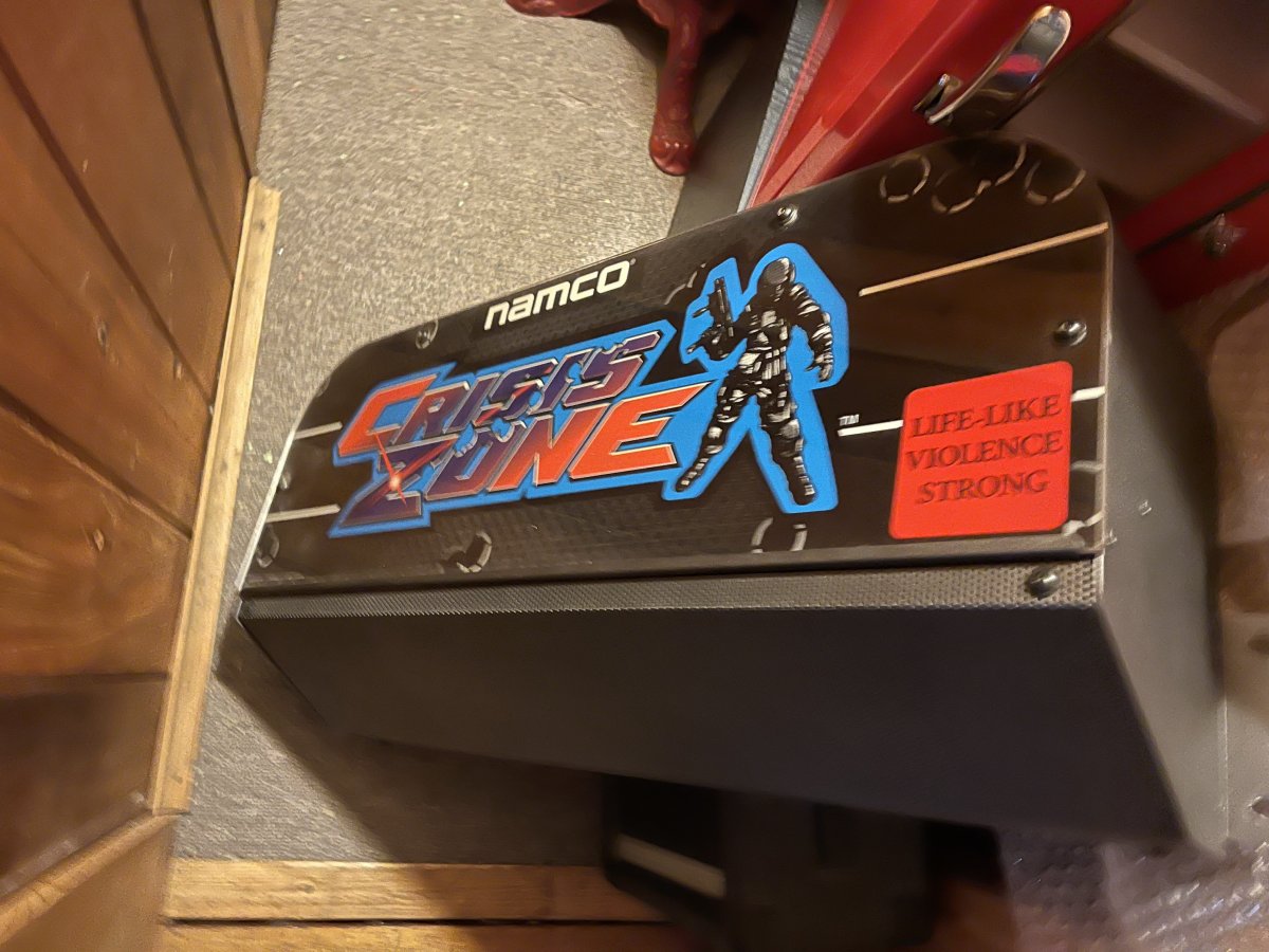

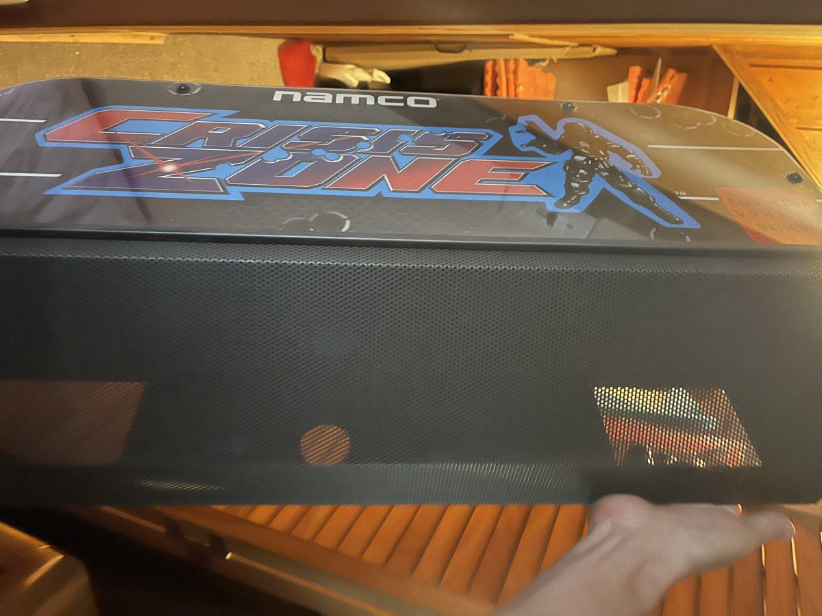

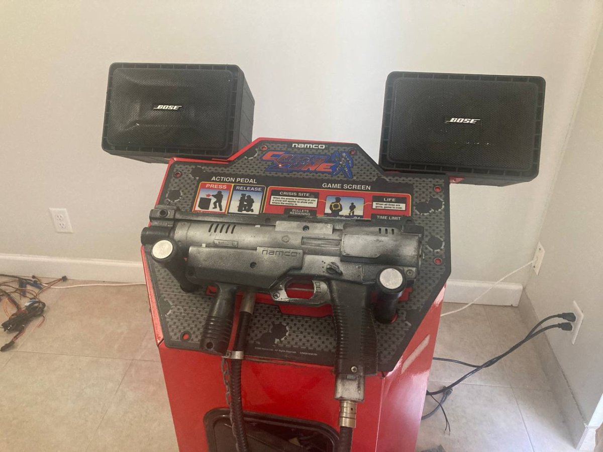

Waiting for custom speaker mounts to arrive for Bose Roommate2, would go to the sides of the camera pod.

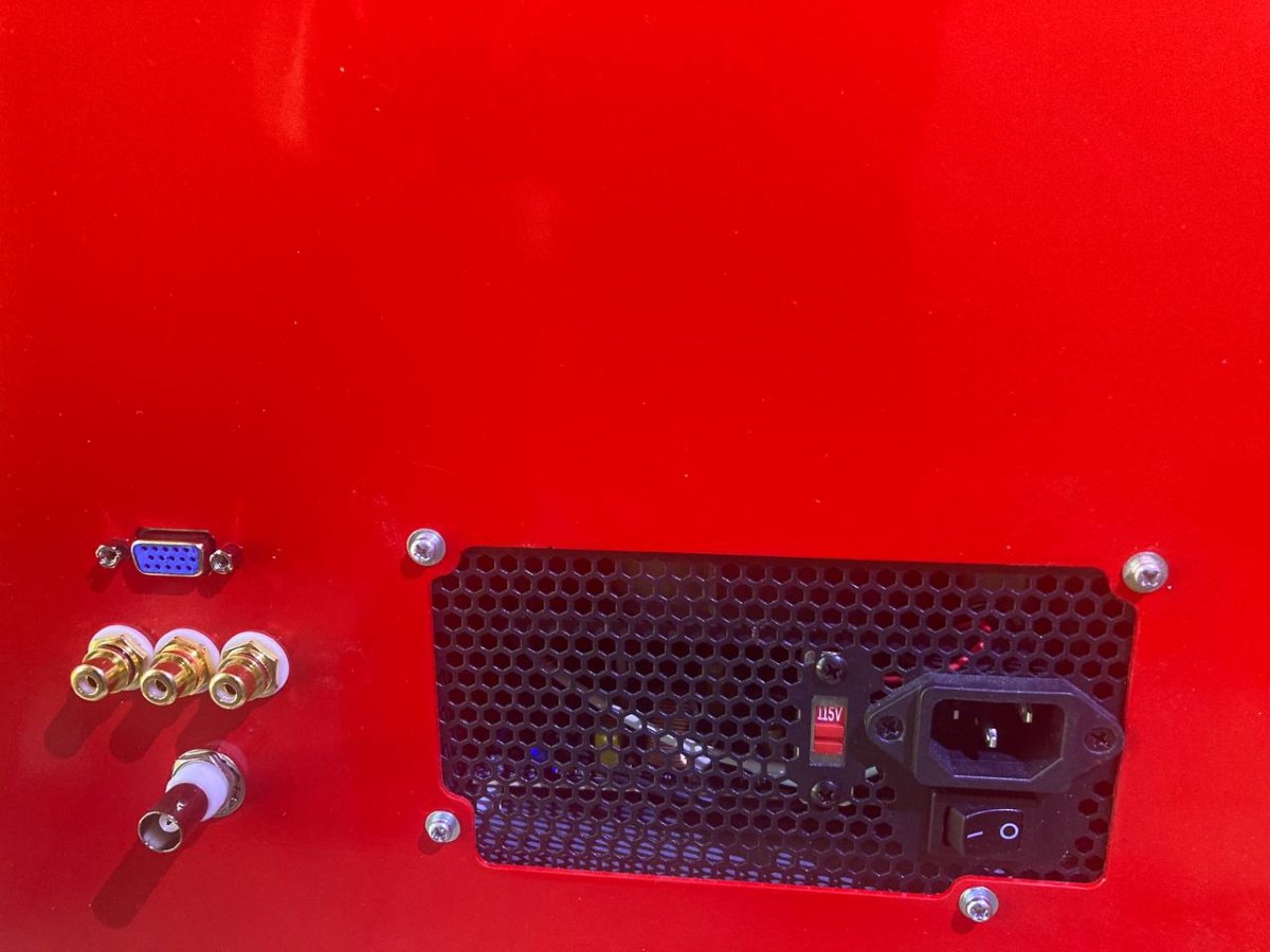

Everything is mounted inside the gun tower. Just connect projector or TV and play. Easy to store/move.
May be would repaint the tower later, other than that only gun recoil needs fixing (completly wornout pinion gear inside the motor assembly)

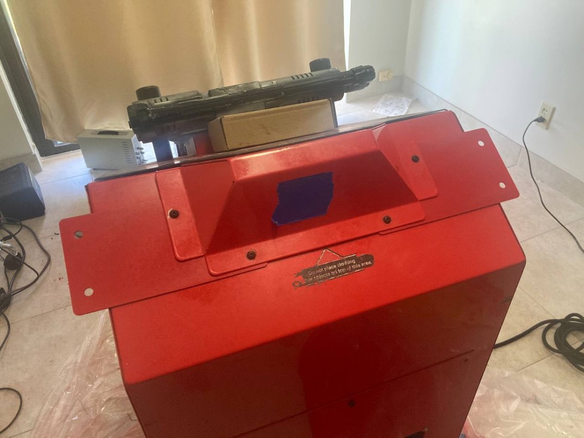

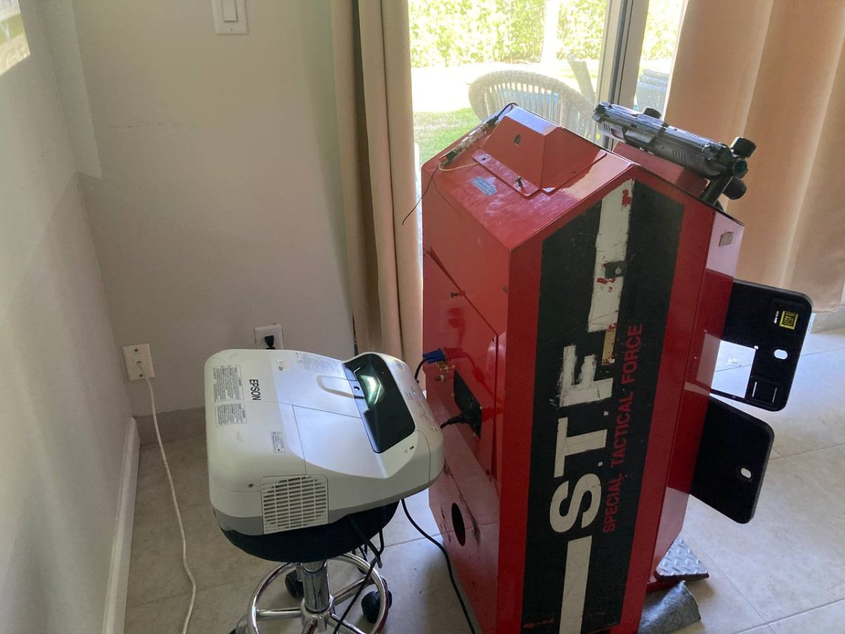

I don't have the topper, and the whole idea of repurposing the gun tower - it's mobility.
Can take to any party (or anime con), hook to any projector and good to go.

It was saved from being trashed, I literally paid a person in the other state to ship it to me, so they don't throw it away.
Only the gun tower and the computer survived, TV and TV cabinet were long dead.
Interesting I have received both RAYS and V185 i/o boards.
Was sitting in my closet for almost 2 years, now decided it's time to finish this long project.

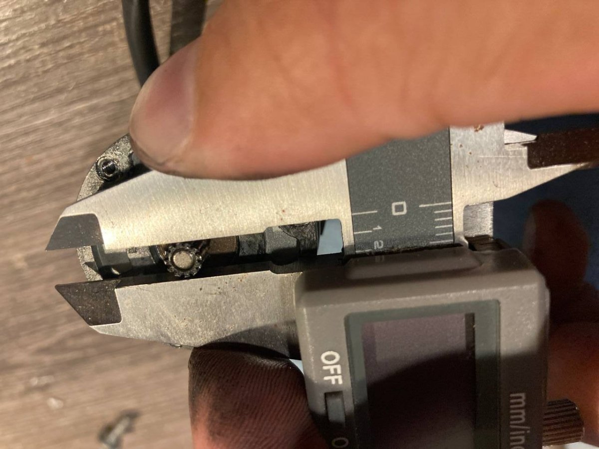

Recoil motor replaced. Original motor is ok, but the smallest pinion gear in it's gearbox was completly worn out.
For the record it is T12 P64 pinion, BUT with 1/8" (3.2mm) bore. Which is impossible to get anywhere.
As a solution this chinese motor from amazon fits perfectly, it is literally drag-n-drop replacement, except you need to solder the wires and connect positive wire to motor's "-", negative to "+", so the direction would be right.
https://www.amazon.com/dp/B08FBCMH82 (I got 24v 500rpm one)
$15 motor, shipped home next day is WAY better than getting "NOS" from HongKong for $55 + shipping and who knows how long waiting.

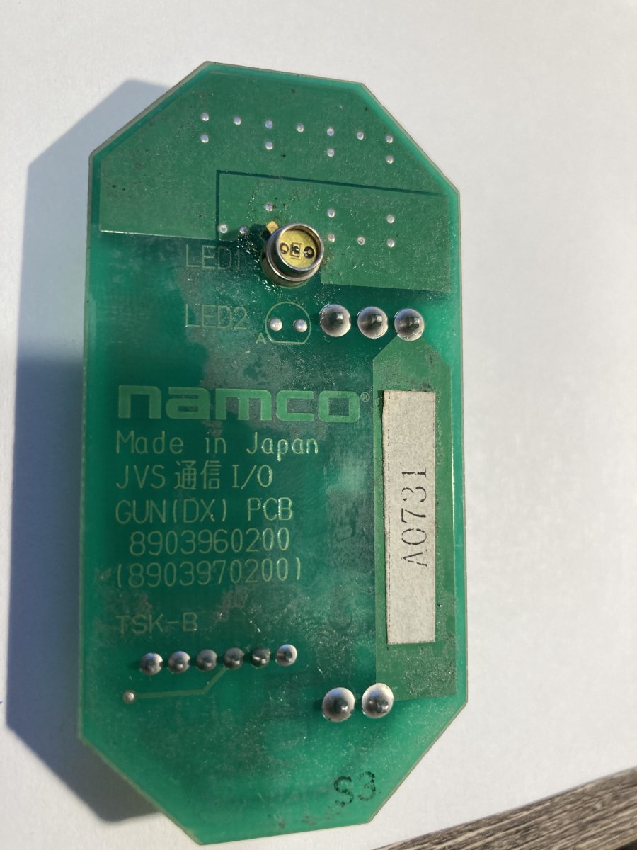

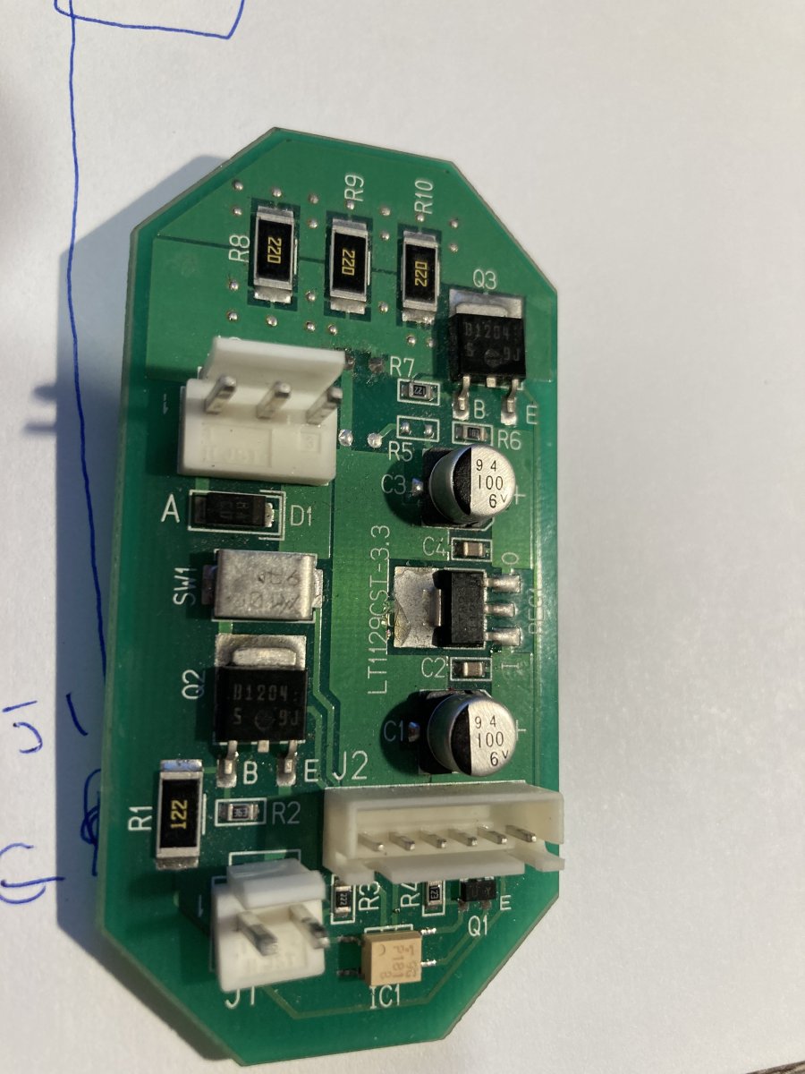

Thank you so much! If you ever want some high res pictures of the Crisis Zone gun, tell me as I have a brand new old stock gun. :) I’m in the process of remaking the Crisis Zone IR gun pcb, it’s basically the same thing as the tiny board but with the addition of the motor transistors. That’s the tricky part.
I'm interested in a crisis zone gun pcb, I have write you a PM
This is how the PCB looks like (I don't have a spare for sale)
But I have schematics somewhere, if you want it.
Can be reproduced pretty easily, except I don't known where to get that bi-metal temperature protection switch SW1
