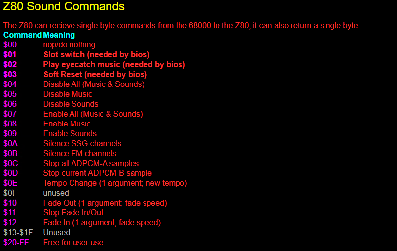

I previously tried to redo the Magician Lord audio driver, to make it compatible with PCM cards, but I realized that the NGFX SoundBuilder addresses and those of the game do not match.
Something i miss here, becouse NGFX Tool follow this address:
Where $20 - FF is free for user use, but on magician lord is starting on previus addresses.

A lot of NeoGeo games use "banks" for samples. The builder tool allows for this. What you see for this is usually a byte from 0x18-0x1f then followed by a byte that is >= 0x20 that plays from an alternative track list.
For the sound builder, it's annoying because it will always apply whatever the last bank you selected, so if you send bank 1 command then a sound and then another sound, the second sound should really default bank to bank 0, but it will play from bank 1.
