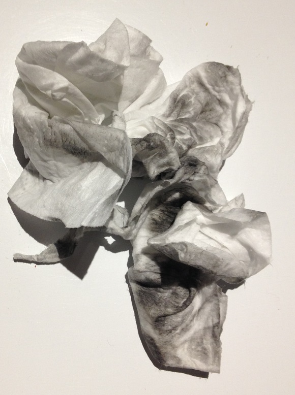

- The shell of my cart seems to have been painted with dark-gray spray paint. It does not look original (but I know it is), and the paint can be scraped easily. Not really impressed by the finishing :( . Edit: it is not paint, it is something else, because just smudging the cart with the finger, removes the coating and painted my finger all black. No idea what it is.
All Cart are original Sandblasted shell (Me and Stefano have opened one by one)I think that the plastic it's mixed up and seems a paint, but isn't it (or the factory didn't tell me nothing about)
We have paid only for sandblasting, no paint, nobody make a work in italy for free :-)

Same here, black ink (?) on fingers, I had to clean my hands before using the arcade cabinet. I am not a pussy, I am not afraid to have dirty fingers at work but when it comes to arcade stuff that cost 400 euros it is a bit strange.
What are you using to clean the plastic?
Not really impressed by the finishing too, an instruction sheet would be welcome...
I am using alcohol + lots of paper towels. It took some time and effort, but it eventually improved a lot.
Used baby wipes. There's a lot of gunk on there.
I suggest they need a clean with some soapy water after they come back from the sandblaster.

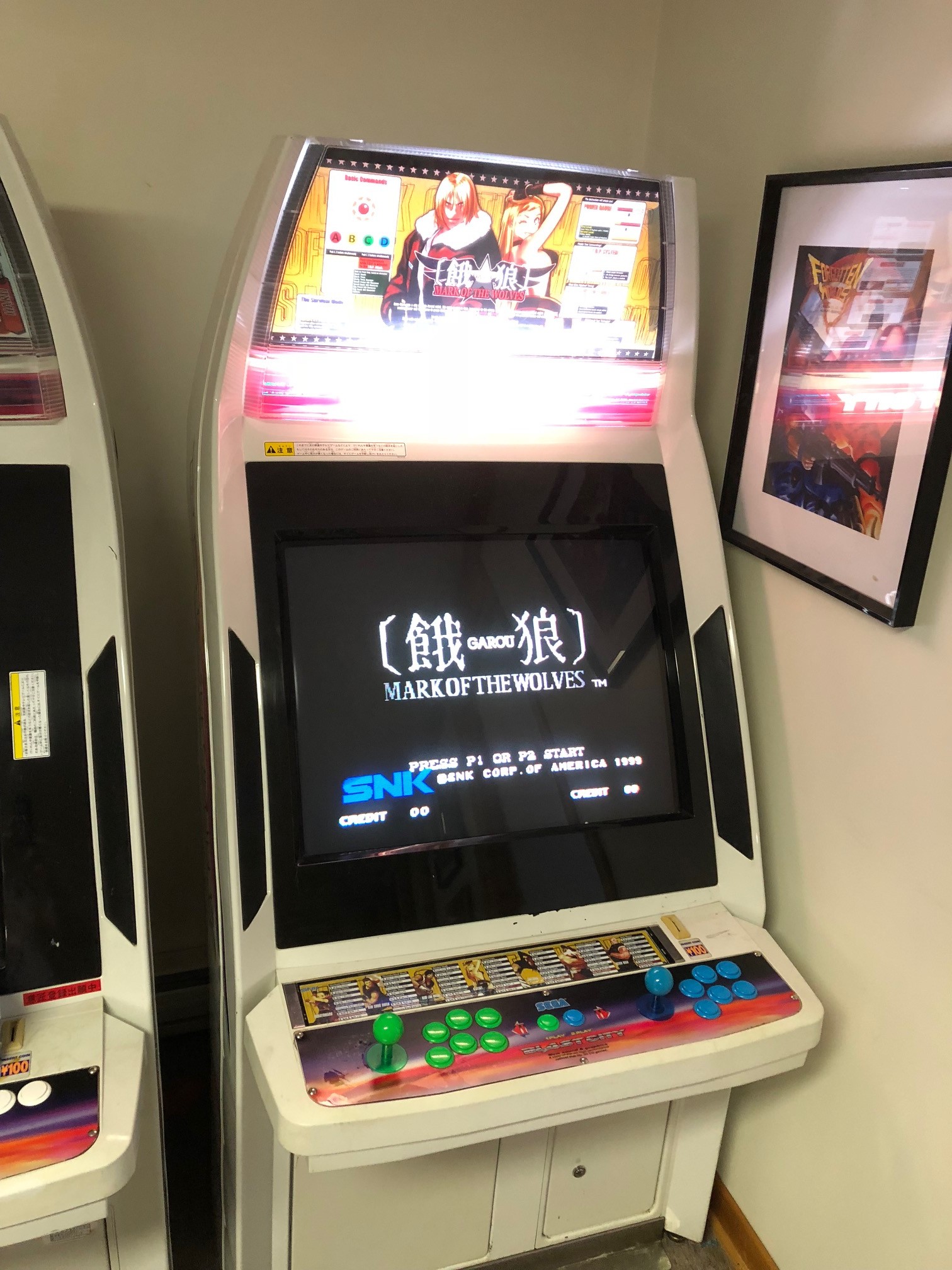

Neo Sports Point cab.
2 Slot mobo
Unibios 2.3 ( came with above )
All setup up as normal for Neo carts.
Ok i got my DS Multi cart today.
Very well packed, looks great as a kit with fancy box and cover ( going in attic ;)
Cart looks and feels great ( abit of dust on but quick clean and thats Sorted )
Downloaded latest roll up pack, dropped in on a new Sandisk 32gig class 10.
( on root have two folders, one called games ( with games in) one called update ( just left it as is)
SD card in and Cart in Slot 1, time to boot up.
Came up with setting up text etc, just left it to work.
Then Axel F came on and the Dark Soft logo lit up!
Had a play with menu, found some games picked slots and played!
Played 9 games over three hours so far went back to Viewpoint a few times to to test highscore loaded back in ( yup )
Got the Unibios splash screen mess ( only first boot )
Going to put real Bios back in at some point but works with unibios 99% (just press c if green screen pops, only happens when swapping game )
