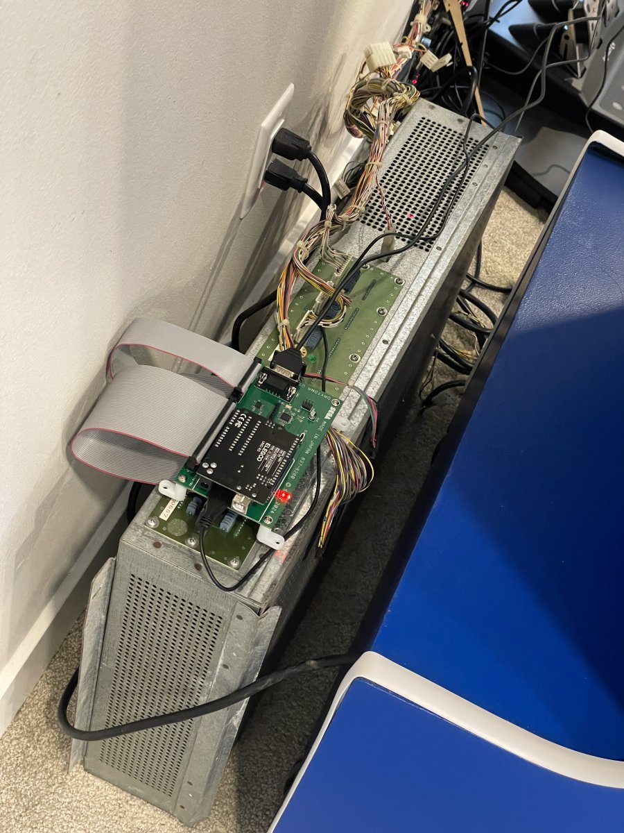

I took a week off during Christmas and New Year and went working on a PCB to host all the stuff. I could have went the route of pulling all the chips from the host shield along with the microcontroller to the board, but I figured that for a first prototype having a direct interface with the Arduino would save me some time and potential errors that would require board revisions. So I went for it. Since the Uno I/O pins are quite limited I added the second microcontroller to the board which is dedicated to reading and translating the shifter. Then added a switch to the board to tell the main MCU which device method to use (since each controller is read in a different manner), and it was ready to manufacture.
A week and a half later, my newest creation came to greet me in all of it's green mask glory:
The SEGA logo and the inscriptions are made to match the other peripheral boards used by the Model 2 such as the Audio and Drive boards, and keep the consistency in the design.
I'm glad I decided to use the host shield and the Arduino Uno in the mix. With 3 layers, the assembled board has a bit of resemblance to the actual Model 2 and it's 4 board stack. Quite charming.
I used a short 50 pin and 26 pin IDC flat cables which fits perfectly with the I/O connectors in the filter board (after sanding the key notch). The red LED was an afterthought. At first I figured the power LED on the Uno would be enough to tell me the system was up, but all Model 2 boards have those red LEDs so I added it as a bodge. Since the legs and resistor run on the under side, it looks clean. Not fancy but not ghetto either. It blends in well.
And there you have it, in all of it's 24" CRT glory connected through the OSSC. This is no Daytona Cabinet, but an upgrade to a "less poor man's Daytona USA". It suits my needs. The G29 stick powers with spring tension so, while that's not the real force feedback like I'd get from the emulator, it still provides a good arcade feel to driving the game. I don't have a Drive Board yet, once I get one, I'll try to reverse engineer the signals and figure out what the game is doing in terms of requesting force feedback, hopefully I can update the firmware later to support sending those commands to the steering wheel. Let's go away! Gonna fly sky high now!
