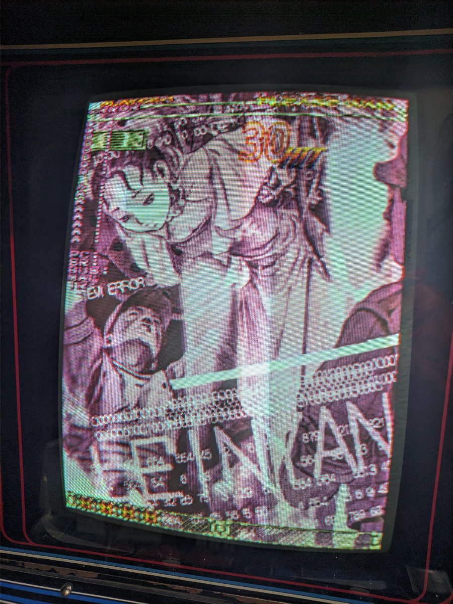

@p_ja I have seen that the second megabyte and the fourth megabyte of ddp_j dual contain the same info
Well, confirmed by me. This bug also occurs on @iq_132 's ddp_dual version, with its specific GAL.
Same behavior. Glitchy illustrations and a high probability on freezing on that set of illustrations after defeating the last boss.
On both versions (iq_132's and @p_ja 's one with DDP bios), the freeze can occur on first loop or second loop, but also the glitchy illustrations happen always.
Believe me, I'M TIRED of looping the game, SO MUCH TESTS........xD

Well, confirmed again. I have played DDP Black Label only version (not the Dual version), using the same DDP GAL.
2 loops in the same power up. Player parameters:
Type-B ship
Purple doll
2 Round Play
Illustrations after final boss are shown perfectly in both loops, no freeze bug at all.
So DDP Dual version for fluffy's carts needs further debugging I think.

I don't think this is the real issue. The original DDP DOJ Black Label requires for a "magic values" in NVRAM. Arcademodbios hacked the code for only use Black Label always, and that must be a reason.
Therefore, I only see here 2 solutions:
- Hacking correctly DDP DOJ Dual
- Hack DDP DOJ Master ver. and make the switch installation

Thanks to the version @p_ja passed me and all my tiring tests, we can have at last a full "CAVE experience" powering on DDPDJ Black Label, without the IGS PGM screen boot-up BIOS neither the clock warning message. With this version, the disclaimer message is directly shown on boot. I have tested to the fullest makin 3 loops in a row without shutting down the game, and no bugs / freeze / glitches have occured, even on the illustrations after the final boss defeat.
The file to use is the one named P1_BL_INTROLESS.zip, and you have to use PGM_RG_U5_QB GAL16V8 on fluffy's carts.
About DDPDJ Dual version, is definitely bugged. I have rushed that version at least 10 times, and in 8 of them the game freezed after defeating the last boss, and in all of them, the final illustrations were bad visualized. So I would not recommend to use it, really.
I have tried to decrypt the mame set ddpdojblk.zip, which is the DDPDJ Black label most newer set with the OLD-NEW option menu on boot, but it seems to need something more to be done. The info inside this binary I have tried is almost the same as DDPDJ Black Label INTROLESS, and should work because I have used the same data distribution.
This "need to be checked" version is P1_DUAL_INTROLESS_V2.zip, so If anyone want to take the lead from here, I can test the binary changes on my DDPDJ test cartridge.

I have the honor of announce you a definitive fixed version of DDP DOJ Black Label dual, with DDP original bios for avoiding the IGS PGM boot-up animation and datetime table. It boots directly on the selection screen.
Until now, the old DDP DOJ dual version that was hosted online had a bug after defeating the last boss (exposed by me here in this thread). The bug consisted of a bad visualization of the illustrations loaded after finishing the level and a very high possibility of gameplay freezing.
These tests were made by me completing the game around 10 times on that moment.
This new version has no bugs at all. I have played this version through the last boss with these tests:
- Yesterday 2 consecutive game rush play on Black Label with purple doll and pink doll, good illustrations and no freezing
- Today 3 consecutive game rush play on Black Label with purple doll, red doll and pink doll, good illustrations and no freezing
- Today 3 consecutive game rush play on Master ver. with purple doll, red doll and pink doll, good illustrations and no freezing
