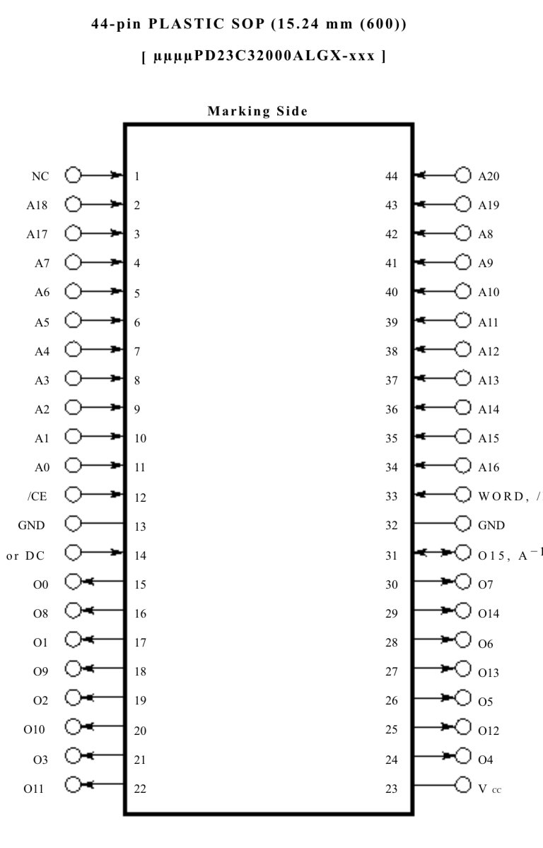

I don't know the exact reference used, probably 32MB :unsure: ,on the PCB of the Romboard it is screen printed on the empty space UPD23C32000GX.

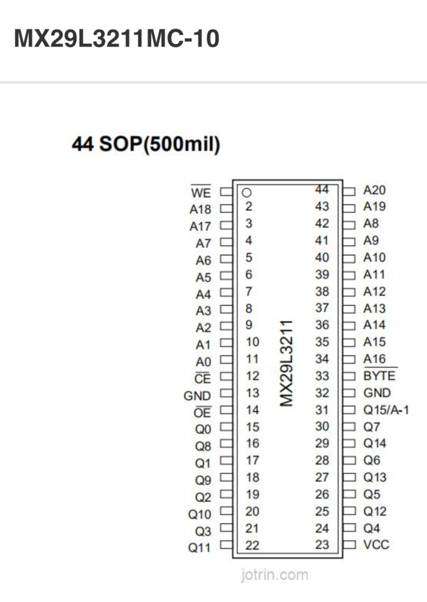

I would like to know if I can use MX29L3211MC-10 with a LDO Voltage Regulator ?

Pinout looks similar. Might have to do something with pin33 to put it in the right mode (byte/word)

what do you mean by pin33 to put it in the right mode (byte/word) ??(
It is probably already set correctly. If not you would have to lift the pin and either connect it to gnd or vcc depending on the mode it has to be in.
