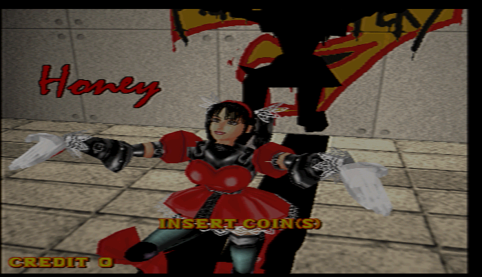

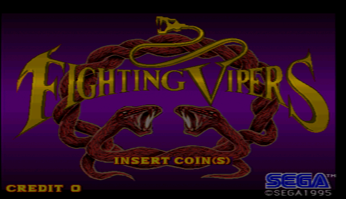

Diagonal lines appearing in the video (DOA MODEL2A)
Have you tried connecting the CSync from the MODEL2 to the VGA HSync pin? In the picture, it looks like it's connected to the VSync.
DING DING DING! WE HAVE A WINNER! I hooked it to pin 14 in the schematic when it should have been pin 13! Thank you! :thumbsup:
