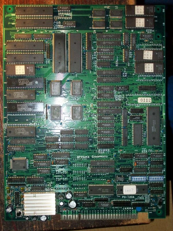

Pic :
(yeah my Gundhara board is in not so great condition - looks like a cap has leaked on it from another board maybe ?)
So I own this Zombie Raid pcb and I see that Gundhara would be a much better game. Anyone ever did a conversion? there are differences in the board but a LOT of exactly the same thing!
thanks to @caius repair for this Gundhara picture:
and my zombie raid:
Even if the hardware isnt 100% the same ? (ive noticed some differences in logics side , in the top of pcb

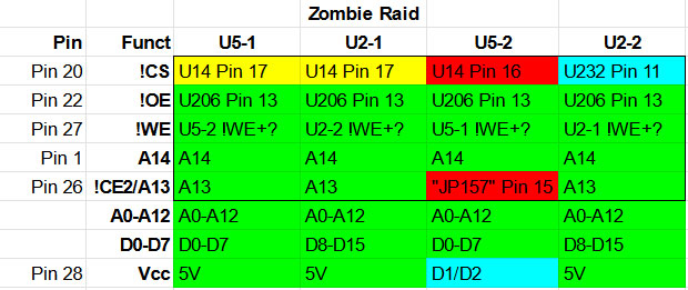

mapping out the RAM section on Zombie Raid....
U5-2 seems to be populated on SOME PCBs but not others, and U2-2 seems to be not populated on any of them.
Here is how they map out:
Green is what I expected to see, orange and red is NOT what I expected to see, and are the pins I suspect may differ from Gundhara.
I should also mention that Vcc is connected to 5V on all but U5-2, which is connected to the battery Diodes instead.
I think U2-2 Pin 20 (CS) should probably be U14 Pin 16 instead (like U5-2) and I'd expect Pin 26 (A13) of U5-2 to connect to Pin 26 on all of the other RAM chips.
We'll need someone who owns a Gundhara and a multi-meter to check this out to see if my assumptions are correct.

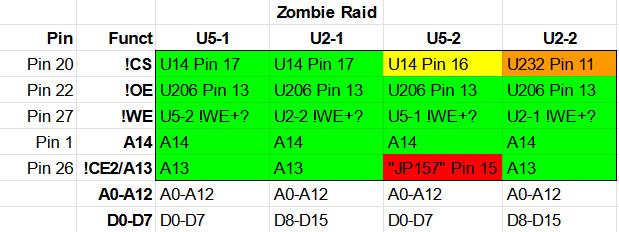

UPDATE:
poking around a bit more and looking at the MAME Driver there's this in the address MAP:
Code:
	map(0x200000, 0x20ffff).ram();                             // RAM
	map(0x210000, 0x21ffff).ram();                             // RAM (gundhara)
	map(0x300000, 0x30ffff).ram().share("nvram");              // actually 8K x8 SRAM in zombraid
So main RAM is at 0x200000
Then it lists extra RAM for Gundhara at 0x210000
then it lists Zombie Raid SRAM at 0x300000
So the chips U5-1 and U2-1 appear to be the Main RAM at 0x200000, they're the right size and they're enabled by the PAL at U14 Pin 17, which activates in the 0x2_____ memory range
So the chip at U5-2 that is equipped on SOME Zombie Raids is an 8K x8 SRAM and it's enabled by the PAL at U14 Pin 16, which activates in the 0x3_____ memory range
looking at U2-2 (unpopulated on zombraid) it's activated by the demultiplexer at U232. this is activated by PAL U14 Pin 17 (so the 0x2_____ range) and demultiplexes A17 and A16 so that it activates at 0x21____ So it seems that U2-2
that makes the updated chart look like this:
so I think U2-2 is complete and correct. the OE pin is "probably" correct and should be confirmed. but it does call into question the OE of U5-1 and U2-1 as they'll be always be enabled at the same time as U2-2... they should probably have their OE pin tied to U232, maybe Pin 12?
it'd be nice to have confirmation from an original PCB owner before I go cutting traces and lifting pins to see if my analysis is correct lol
