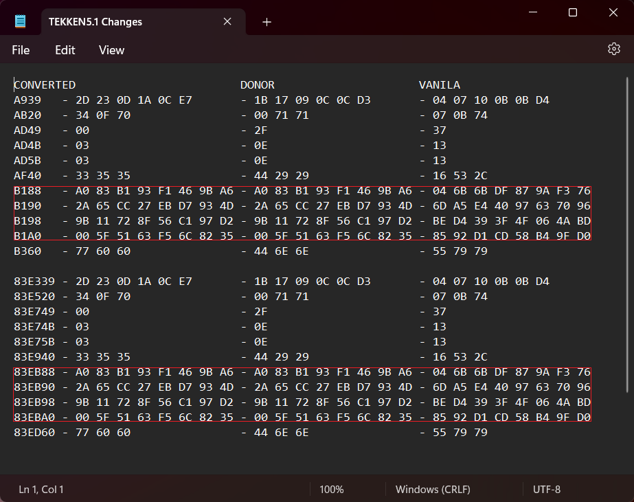

Can someone explain that? I compared Tekken5.1(full dump, not just the boot.bin) the same dump after conversion with key from Gundam game, as you see on the file attached, in red area are the key bytes, why other bytes are different from vanilla dump? To be clear, game boots. What's funnier I took copy of clean dump, injected all the changes manually using HEX editor and write it straight to Dongle, with no sing magic in linux and any other software, and the game boots! So if that would be obtained how these bytes are calculated, a simple calculator could be made where you could copy key from offset x of donor dongle, put it in calculator to get results and paste them to the dump using HEX editor and just write it to donor dongle without any linux signing things or other shit. I know that someone is working on a new software to make conversions :) but I just wanted to share that.
