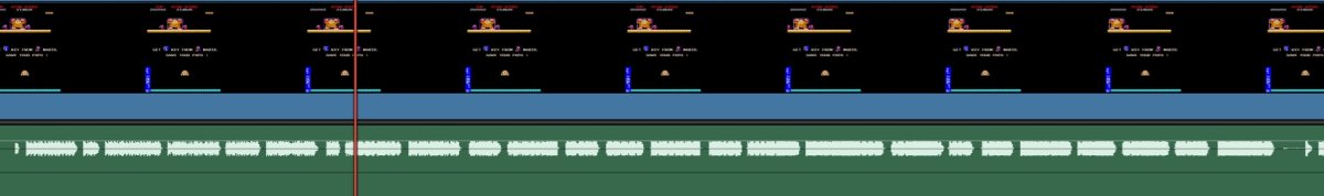

Donkey Kong Jr. seems to be suffering from frequent, intermittent audio drop-outs, making it sound scratchy/crackly/static-y.
Example:
I have uploaded a clip of the intro (with sound) that you can hear here: https://imgur.com/38h43GU
You can see a visualization of this issue in the audio spectrogram in the provided image attachments on this post.

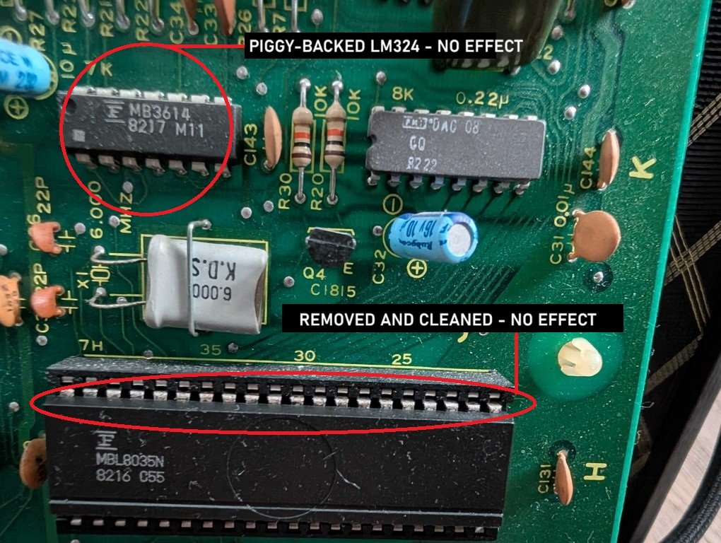

  • Board recapped - no effect.
  • New LM324 chip piggybacked on spot 7K - no effect.
  • 8035 sound processor removed, cleaned, resocketed - no effect.
  • Chip 3H (sound files) removed, cleaned, resocketed - no effect.
  • Nintendo to JAMMA adapter swapped for a different design to ensure audio amp not at fault - no effect.

I have two copies of Donkey Kong Jr. which both have this same problem. The audio issue is as previously described (and demonstrated visually in the spectrogram image attached to this post): Audio frequently, briefly, cuts out. This causes the audio to sound bad. Insofar as the music and sound effects are concerned, they seem to play correctly, it's just cutting out. On one board, an additional problem is present in that the boot sound effect only plays intermittently.

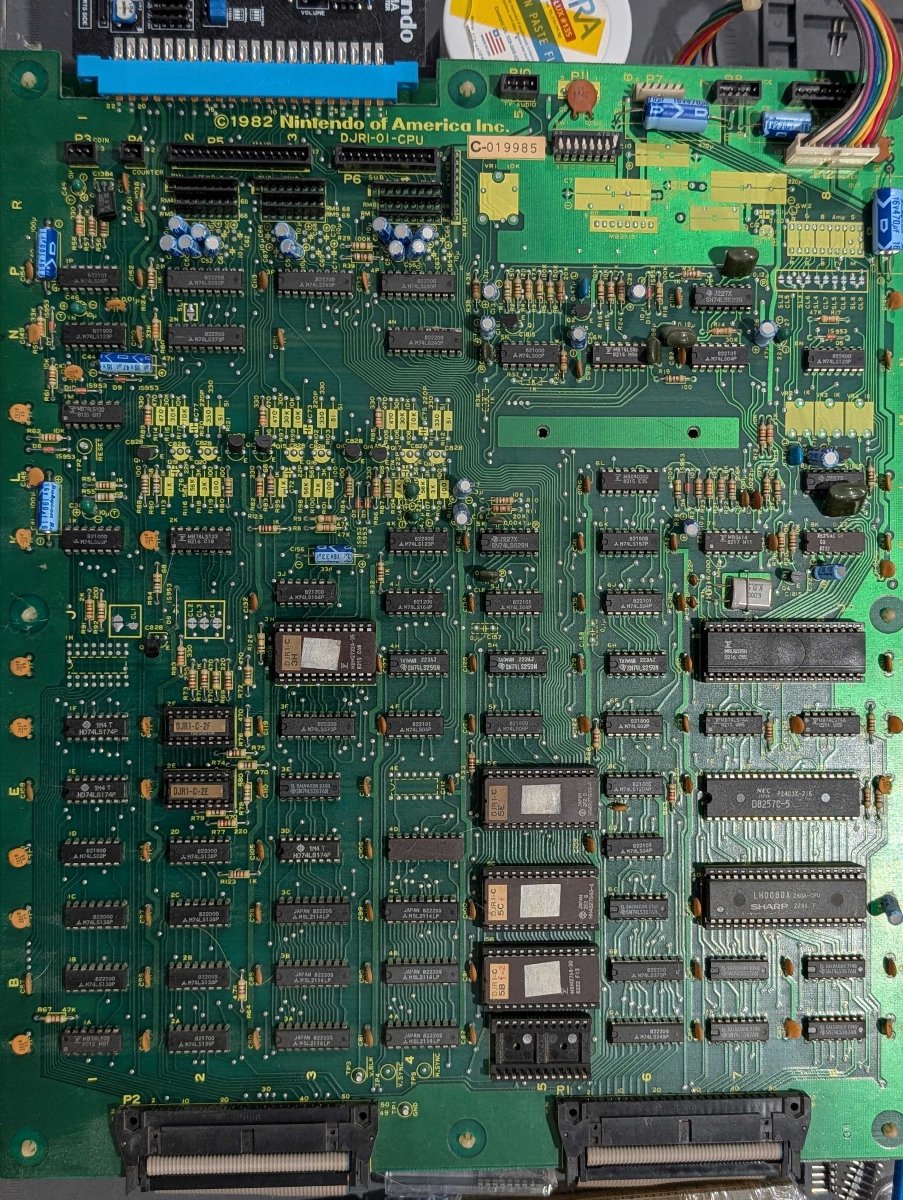

With all that said, I attempted to look up the schematic information in my operators manual, which identifies that it's for the "DJR1-UP" model, "2 P.C. BOARDS TYPE." When reviewing the schematic drawing, though, I noticed that the alpha-numeric sector designations do not match my own board's layout. I do in fact have the 2-board type, but given my inexperience with schematics at large, I'm unsure if the mismatch is actually indicative of me having the wrong manual or not. I also took to the internet, where I found minimal resources (which is to be expected I guess, given the age of these boards and the general niche of arcade gaming). This is all a long form way of identifying that I'm unsure what constitutes the "digital audio" circuit on the board, so I am not 100% sure on where to look beyond the areas I've already identified.
Bearing that in mind, it seems the chip on spot 7K--an "MB3614 8217 M11" on my board, which is a quad op-amp that is functionally equivalent to an LM324--is often the source of audio troubles. From the resources I found, it was suggested to replace this with an LM324 chip. So, I piggy backed an LM324 on this spot (rather than fully replacing, for ease of troubleshooting purposes), and it yielded no improvement.
I then removed and cleaned the MBL8035N 8216 C55 audio CPU (commonly shortened to "8035") in spot 7H. I cleaned the pins with a fiberglass scratch pen, and flushed the socket with DeoxIT fluid before resocketing it. This yielded no improvement.
I then removed the chip at spot 3H (which contains the audio data) on the board, cleaning the pins with a fiberglass scratch pen, and flushing the socket with DeoxIT fluid before resocketing. As with the audio CPU, this yielded no improvement.
