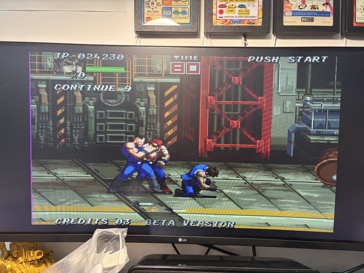

Thanks for the detailed info, seems to match previous reports we got (although that purple bar is new and could be flat screen related).
This occurs on original PCBs ; game otherwise works fine on flashcart / aftermarket / emulation devices.

It's confirmed to not work properly on all these 1-slot boards?
It is interesting to me that the hardware has an impact on games. Developers had to/have to account for little differences in hardware for a game to fully work as an MVS release?
I tested it on:
MV1FS= green screen
MV1B= working
MV1C= working
MV2FS= green screen
Error is from Level 3 not before

Yeah, something odd going on here. Usually this level of testing isn't necessary. The Neo Geo hardware performs identically across models. Testing different models usually comes more down to AES vs MVS and the way multislot boards behave. I'm going to test the game on some of my systems.
Tested beta 3-2 with the NeoSD Pro on my 4-slot MV4F. I had free play enabled. I encountered no issues. No color problems.
What are you using to connect the MV1C to the flat screen? The MV1C has less horizontal resolution than the other models -- It's missing 3 columns on the right side of the screen, just like the Neo Geo CD.
