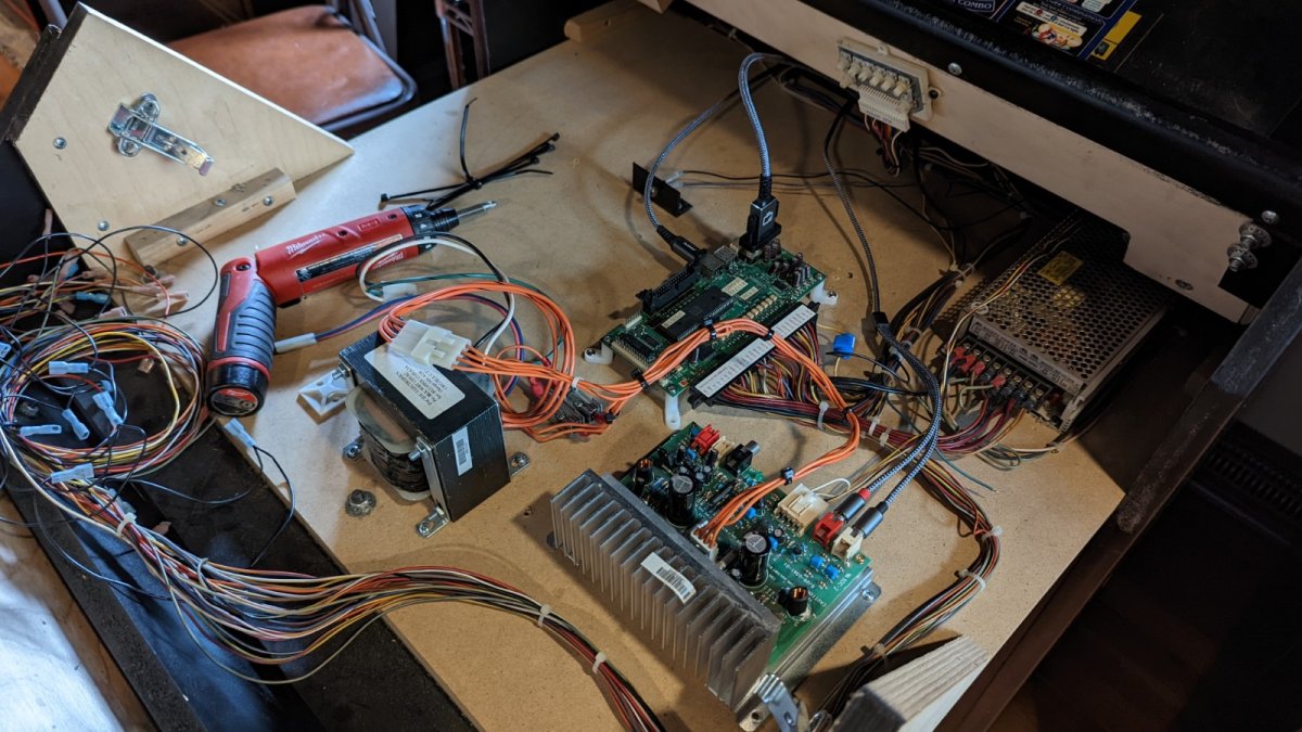

Got the JVS from @psychicdrive and amplifier from @DJLC
We test fit a Naomi in there and know where it needs to be set. Can't go in the base of the cabinet, because it's completely unreachable. Got sticks and buttons in there now on the new panel.
